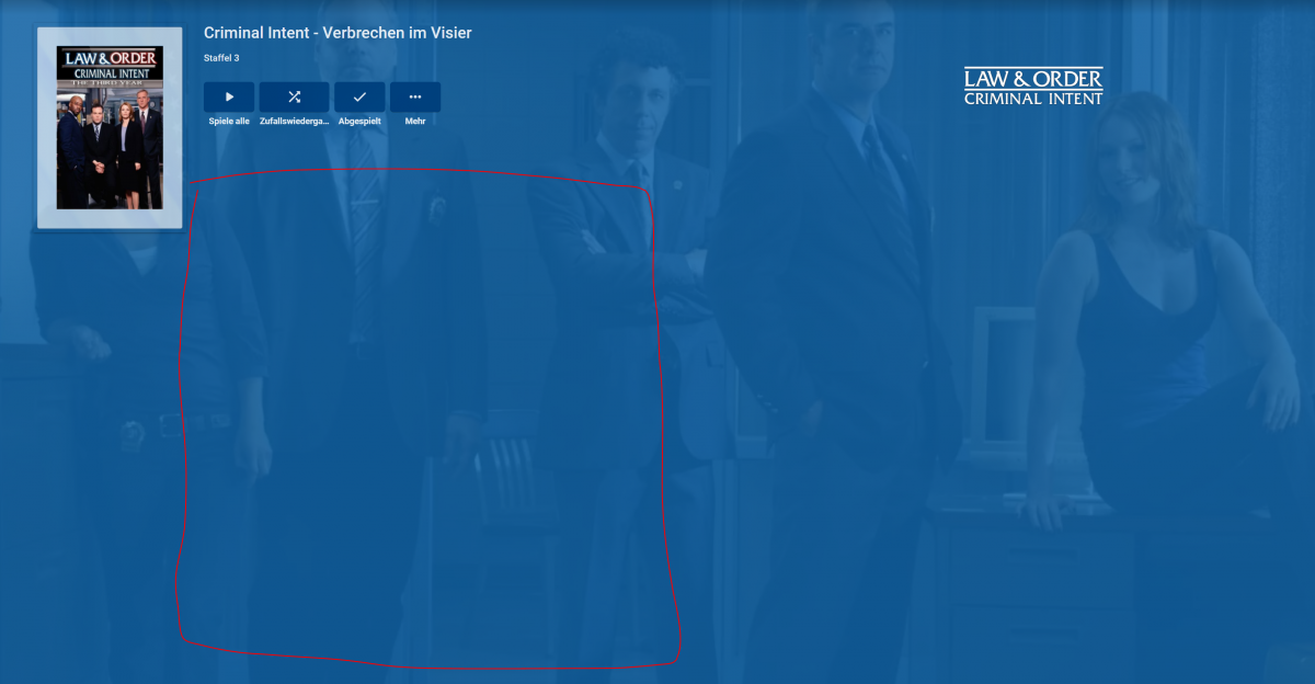

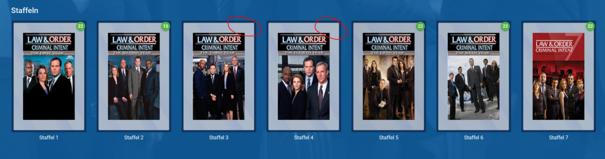

MindBullet 93 Posted December 1, 2019 Posted December 1, 2019 (edited) Oh yes, that's true, I moved a few seasons from different HDDs and merged them together, e.g. S01-S02 of Chicago PD were on hard drive "X:" and I moved them to the rest of the TV show on "E:", let's say. Is this a problem? Or let's take this example. S03-S04 of Criminal Intent were on XX and I moved them to the rest of the TV show on YY, did a scan and now the seasons are like they're not on my HDD, like in the screenshots. As if they wouldn't exist...Is the only way around this to move everything back where it came from? I didn't know you couldn't move files to different storages, if that is the case.They're on the same HDD like the other seasons now, but don't show up. Weird thing is that my Google Chrome notifications get triggered when I added S03 and S04, but the episodes are missing though. Edited December 1, 2019 by MindBullet
MindBullet 93 Posted December 1, 2019 Posted December 1, 2019 I ran another scan (I think the 4th today) and this time the seasons of Criminal Intent are there. That's weird (to me). Can you see anything in the logs that might help me for future instances? And: is this not applicable on Emby to move files to whichever location attached to the Emby installation?Here's a log a final time I hope Thank you all <3
Luke 42217 Posted December 1, 2019 Posted December 1, 2019 Is this a problem? No, it's not a problem. Just give it time and allow the scan to finish.
