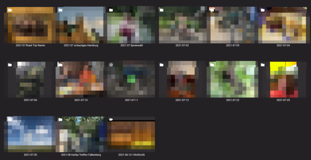

MatthiasM 6 Posted August 18, 2021 Posted August 18, 2021 Hi Luke, I just read this topic and see the same behavior with emby 4.6.4.0. If I create a folder within a "Home videos & photos" library with a single video file in it, it will not be shown as a folder, the video file is shown insteat. If I create an other folder with 2 video files or 1 video file + a photo, the folder will be shown as folder. Can you give an update to that issue? Thanks Matthias
Luke 42269 Posted August 18, 2021 Posted August 18, 2021 7 minutes ago, MatthiasM said: If I create a folder within a "Home videos & photos" library with a single video file in it, it will not be shown as a folder, the video file is shown insteat. You put the video directly into the top level library, therefore there is no subfolder to display, correct? Or am I missing something?

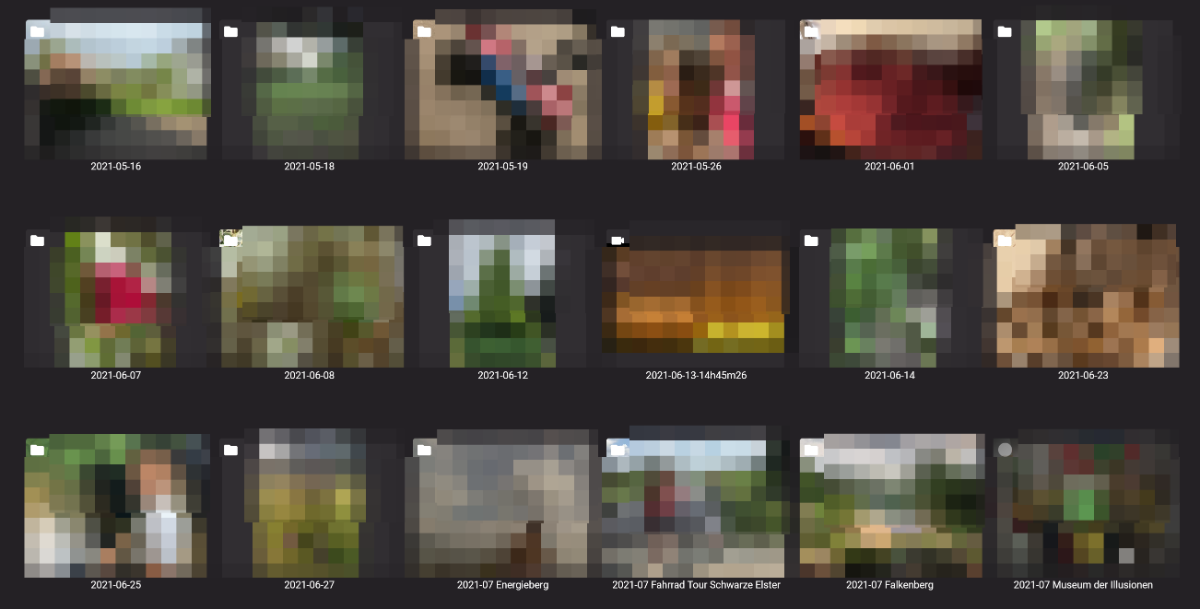

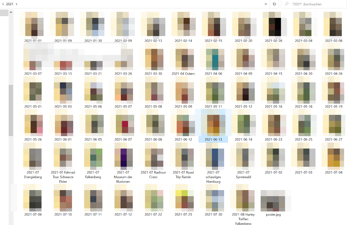

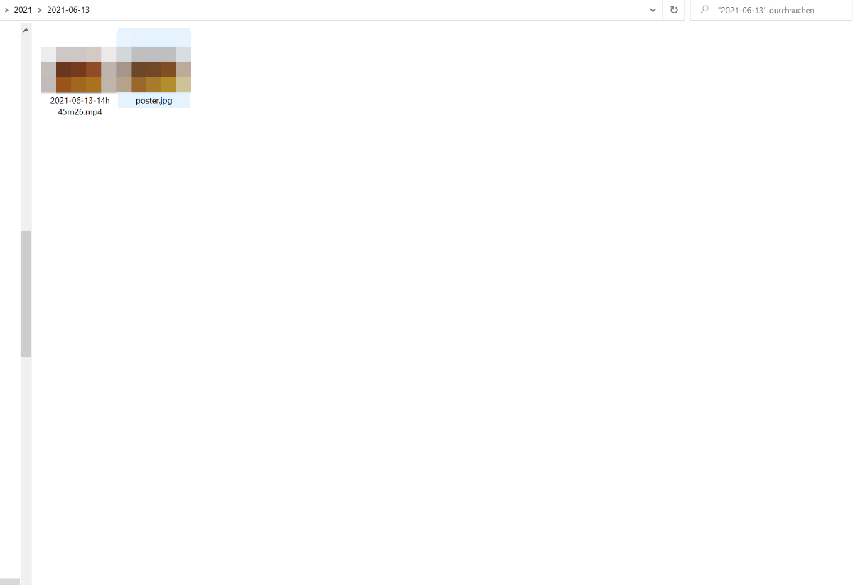

MatthiasM 6 Posted August 18, 2021 Posted August 18, 2021 Sorry Luke, I try to make it clear. Library toplevel contains the year of the shooting 2018, 2019, 2020, 2021... all sub directories are sorted by date year-month-day or by event year-month-name of the event in this subfolders are the media files -> photos and mp4 videos name of the media files sorted by date/time will say year-month-day-hourHminuteMsecond-#.extension the problem will shown with folder 2012-06-13. In this folder iat only 1 mp4 media file with a poster.jpg: in emby this will shown like this: The folder 2021-06-13 ist not sortet correctly, it was placed at the end of the list. And the folder is not shown, the media fils itselt will be in place insteat. If you need more input, please let me know. Thanks Matthias
Carlo 4561 Posted August 18, 2021 Posted August 18, 2021 (edited) Hi, 2021-06-13 is showing as a video folder as the icon is different. Edited August 18, 2021 by cayars

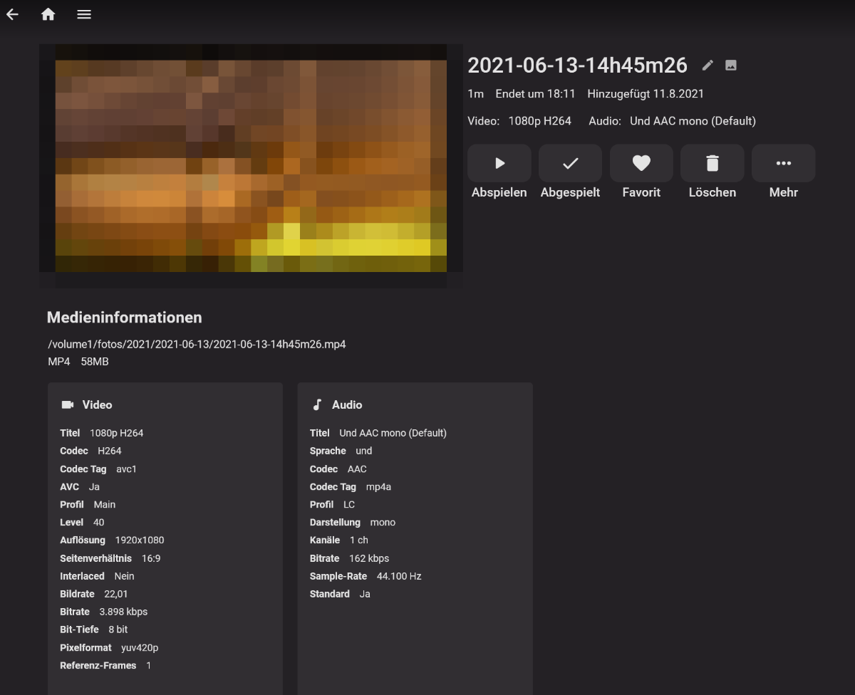

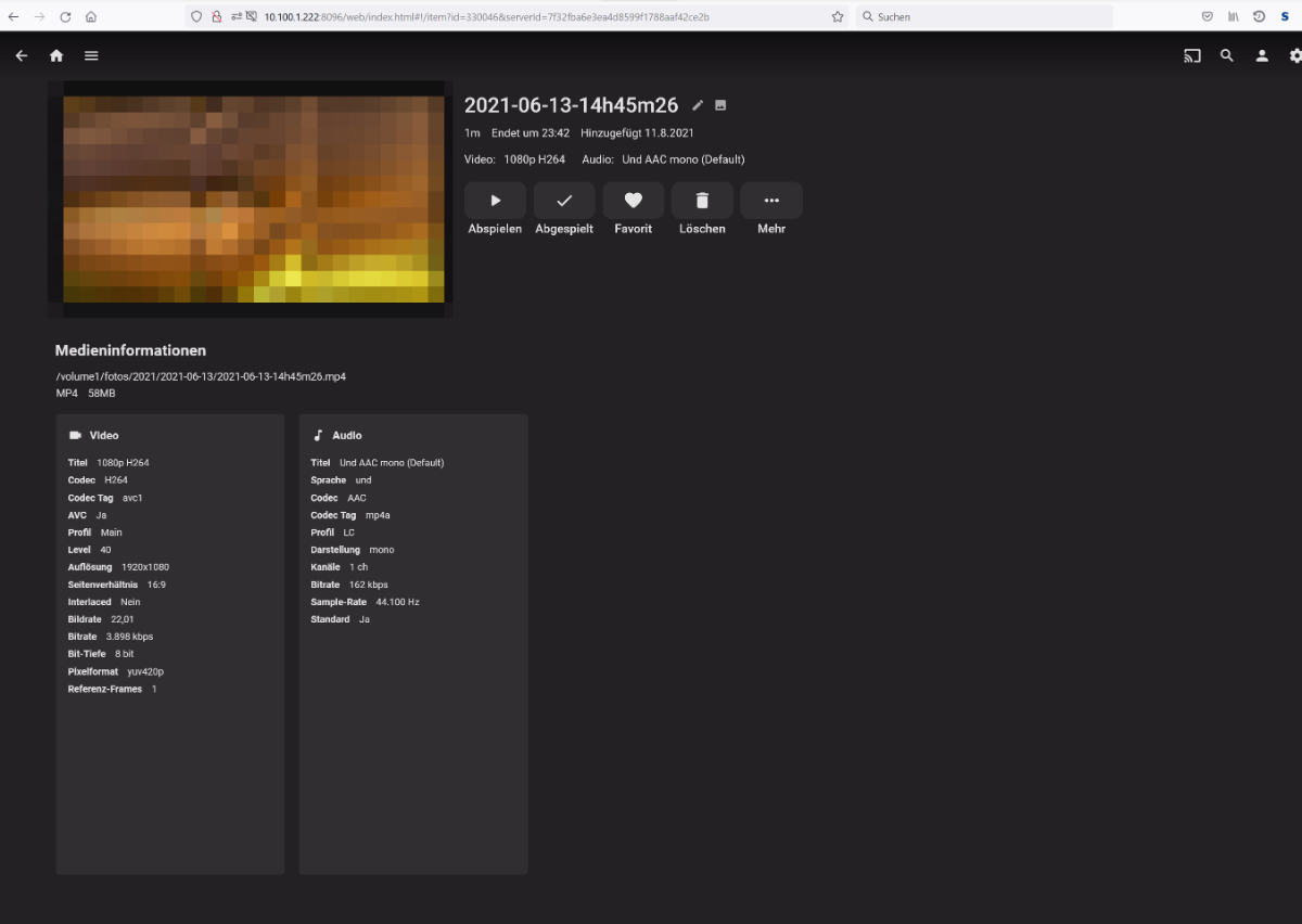

MatthiasM 6 Posted August 18, 2021 Posted August 18, 2021 Hi cayars, no. this is not a folder with a different icon at the corner. If I click on it this screen will shown: The link shown nearby the folders ist a video link. Thanks Matthias
Carlo 4561 Posted August 18, 2021 Posted August 18, 2021 7 minutes ago, MatthiasM said: Hi cayars, no. this is not a folder with a different icon at the corner. Just look at the top left corner in the folder view. There are a couple different icons that can be shown and this one is video. Up top on this Folder view what is the sort by set to?

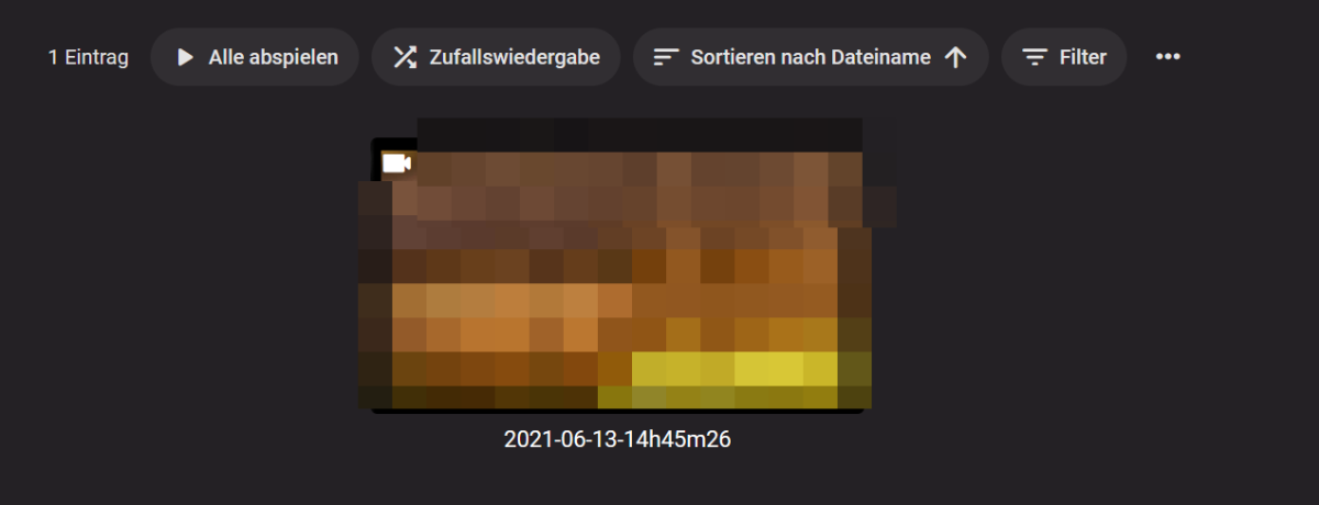

MatthiasM 6 Posted August 19, 2021 Posted August 19, 2021 Gentlemen, thanks a lot for your help! @cayars the sort of the page is set to filename: therefor it is not only the colapse of the folder - like Happy2Play named this effect - it is also the worng sorting of content of single file folders. @Happy2Play that is an interesting option, I will check it and give you feedback in this thread @Luke I'm looking forward to got that fixed! If the workaround Happy2Play described before will work fine, there is no preasure but the private photo and video feature with emby is most important. best regards Matthias
Carlo 4561 Posted August 19, 2021 Posted August 19, 2021 4 minutes ago, MatthiasM said: Gentlemen, thanks a lot for your help! @cayars the sort of the page is set to filename: Try sort by Title instead and let us know if that helps.
MatthiasM 6 Posted August 19, 2021 Posted August 19, 2021 Yes cayars, sort by Title will defeat the problem with the wrong sorting. Thx Matthias
Carlo 4561 Posted August 19, 2021 Posted August 19, 2021 Did you try it? Can you show us what that gives you?
MatthiasM 6 Posted August 19, 2021 Posted August 19, 2021 The page looks like this while setting the sort to Title: The single video file is sorted correctly! I'll try the .xml hint from Happy2Play too and report the summary it here. thx Matthias 1

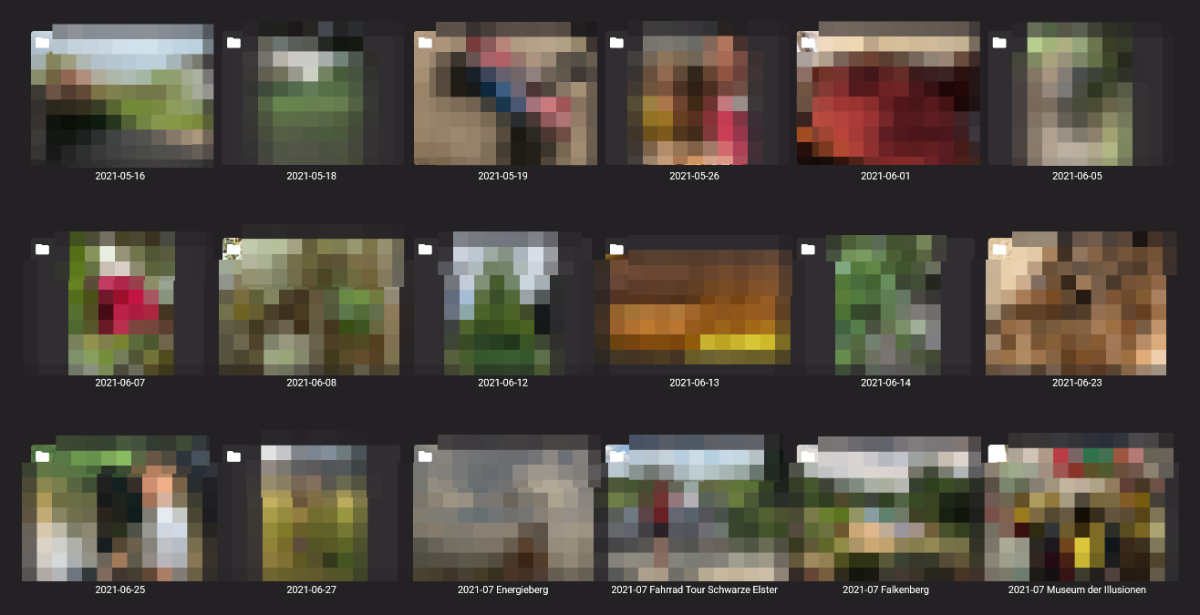

MatthiasM 6 Posted August 19, 2021 Posted August 19, 2021 OK I'd try the <CollapseSingleItemFolders>false</CollapseSingleItemFolders> switch, restart emby and check /emby/root/deafult/*/options.xml options.xml for Home videos & photos was already set to "false" and the result looks very good: the folder ist in place and sort correctly -> 2021-06-13 But as I 've been warned, all custom settings with the meta data in the whole library was deleted and I has to restore emby from backup to get it back. All over all the hint from cayars works well to resolv the sorting problem. For the folder issu I will wait for further solutions. Again, thanks for the great support! beste regards Matthias 1
