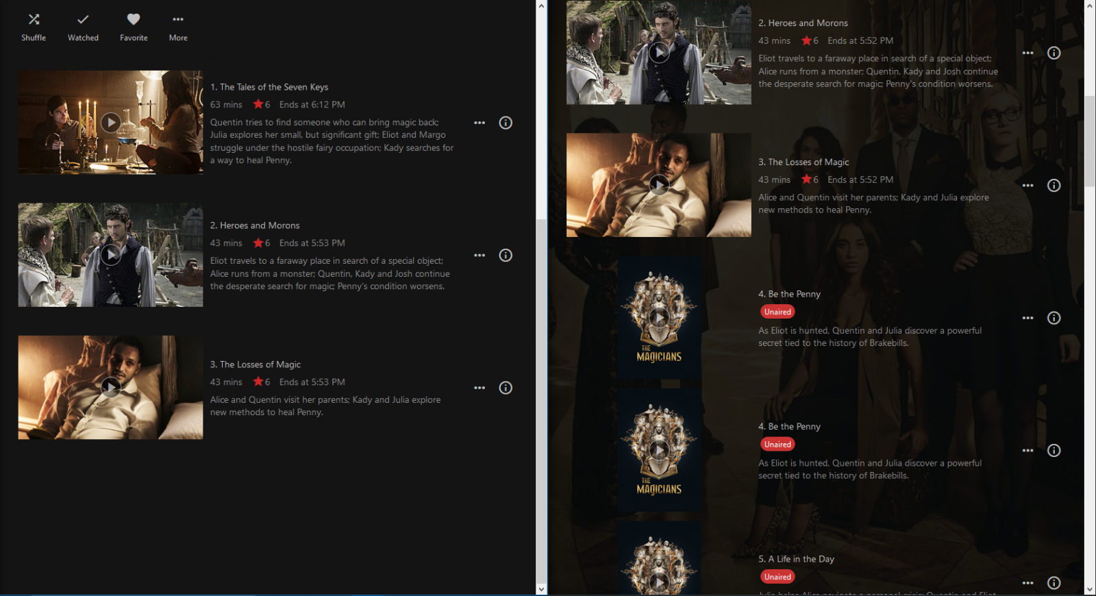

TimFromFL 5 Posted January 28, 2018 Posted January 28, 2018 I have two Emby servers setup pointing to the same content as I am trying to transition to new hardware everything seemed to be working fine but I've noticed that future episodes of TV shows are duplicated on one server but not the other. I am not sure where the difference is since I've compared the TV library setup for both and they seem identical and they are both connected to the same ServerWMC instance. I've done a full re-scan of the TV Library and they still seem to be there. Any assistance will be appreciated. TimFromFL
Luke 42204 Posted January 28, 2018 Posted January 28, 2018 can you show a screenshot comparison? thanks !
TimFromFL 5 Posted January 28, 2018 Author Posted January 28, 2018 can you show a screenshot comparison? thanks ! It is hard to align the two to show everything, but this is a side by side of both servers showing season 3 of "The Magicians" but the same happens for every show. As you can see, one stops after episode 3 because I don't have "show Future Episodes" check and the other has duplicates of future episodes even though the future episodes is not checked. Any ideas?

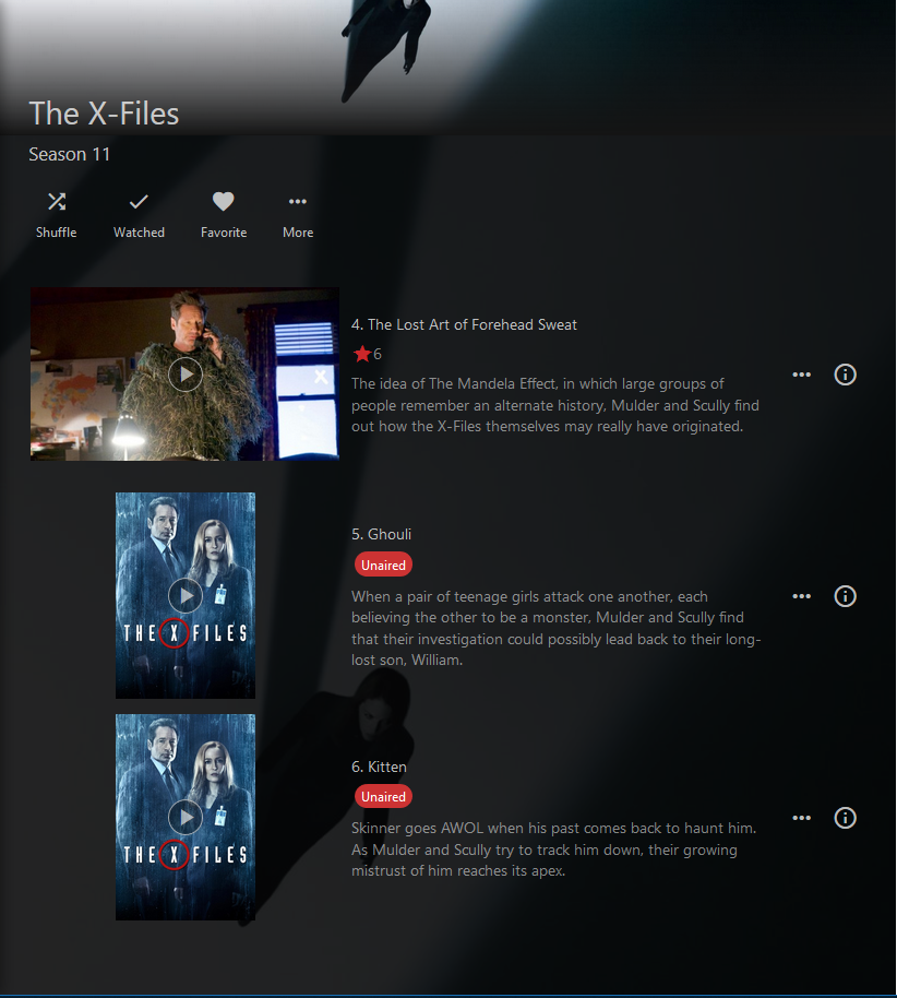

Luke 42204 Posted January 28, 2018 Posted January 28, 2018 for the second one, if you add a new series does the same thing still happen?
TimFromFL 5 Posted January 28, 2018 Author Posted January 28, 2018 for the second one, if you add a new series does the same thing still happen? I added a new series that I've never had before and it still shows the unaired episodes but just one. here is what it looks like and just to confirm the setting that I am referring to:
Solution Luke 42204 Posted January 28, 2018 Solution Posted January 28, 2018 i would check your emby user preferences about unaired episodes. 1
TimFromFL 5 Posted January 28, 2018 Author Posted January 28, 2018 Before I got your reply @@Luke, it dawned on me to check "Display Settings" under the user profile and sure enough there it was. The user profile setting says that it must be enabled on the TV Library to work. but as my example shows that isn't the case. I'm still not sure why I got duplicates though. but my immediate problem has been solved.
