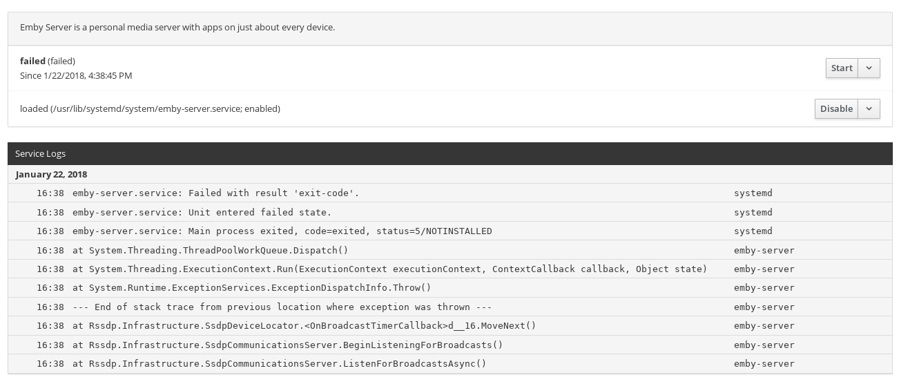

sector327 4 Posted January 22, 2018 Author Posted January 22, 2018 (edited) annnnnnnnd we're dead. ugh... ok, the df result is the same as post #11 so we're not full. so that's good. Looking in cockpit, I see this about emby failing and something about NOTINSTALLED. Did I not upgrade it correctly? (thought I did). I can start it (systemctl start emby-service) and it will run for a moment or two and then I can check it ((systemctl status emby-service) and see it's failed again. Edited January 22, 2018 by sector327

Luke 42245 Posted January 23, 2018 Posted January 23, 2018 annnnnnnnd we're dead. ugh... ok, the df result is the same as post #11 so we're not full. so that's good. Looking in cockpit, I see this about emby failing and something about NOTINSTALLED. Did I not upgrade it correctly? (thought I did). I can start it (systemctl start emby-service) and it will run for a moment or two and then I can check it ((systemctl status emby-service) and see it's failed again. This is resolved for the next release and is on the beta channel for testing. thanks. 1
