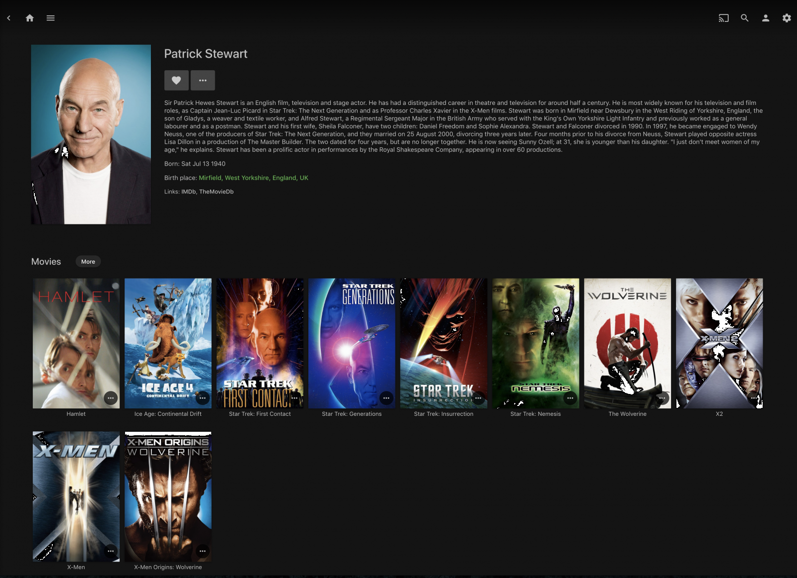

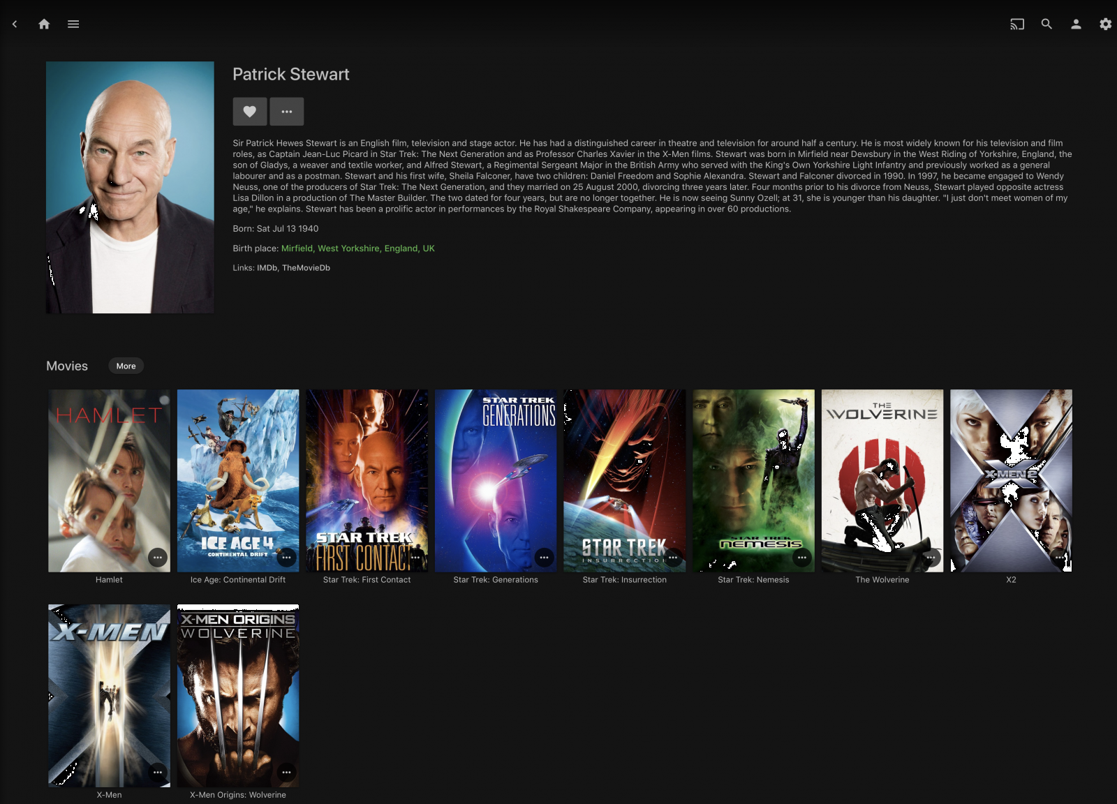

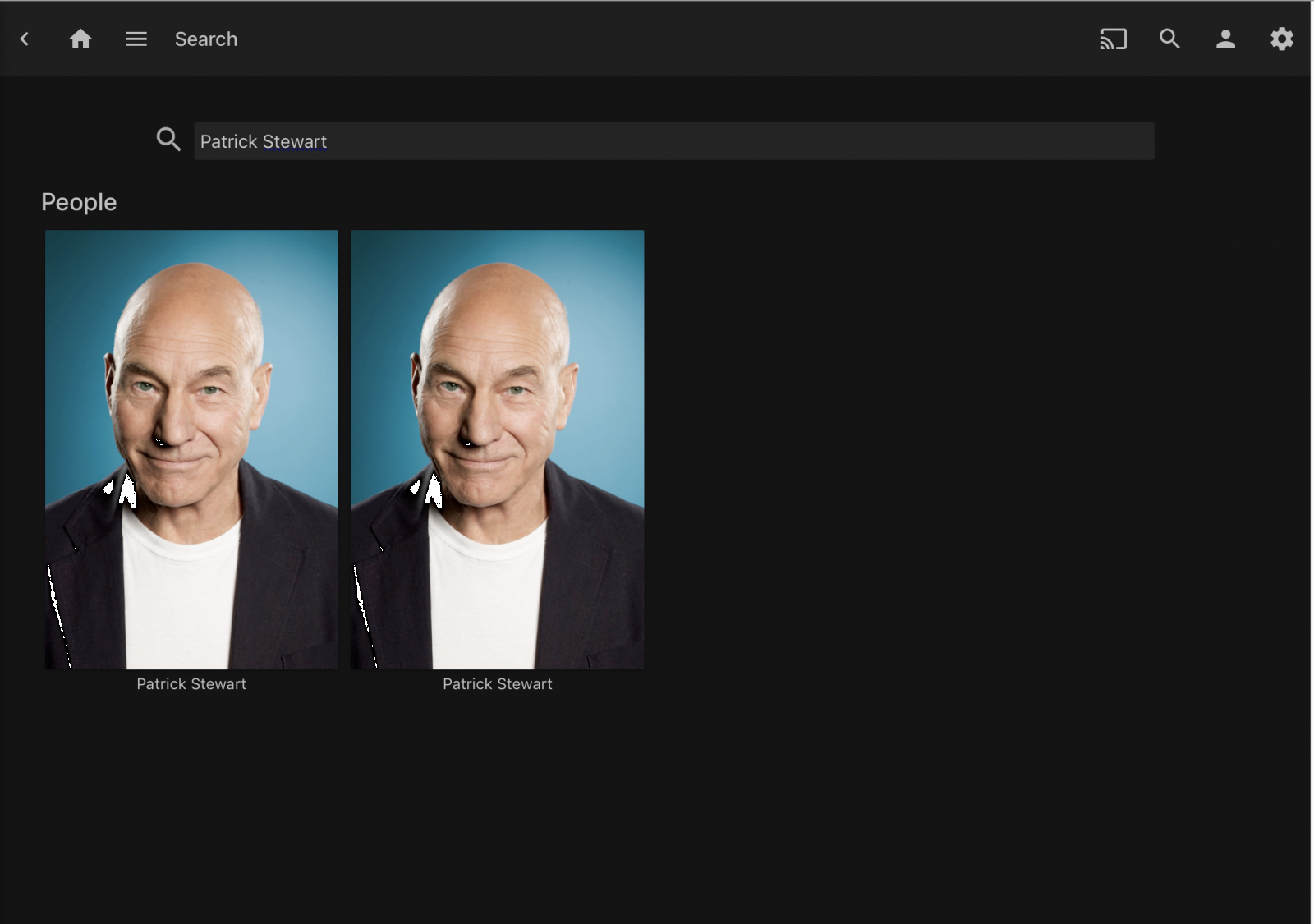

ChrisJ60 13 Posted January 21, 2018 Author Posted January 21, 2018 I'm not sure what kind of 'example' you want? I have two identical versions of 'Patrick Stewart' in my library and as far as I can see they are identical down to the last detail. Please see the attached images (Search Results page and both versions of the man himself). If you want other info, logs etc. just let me know...

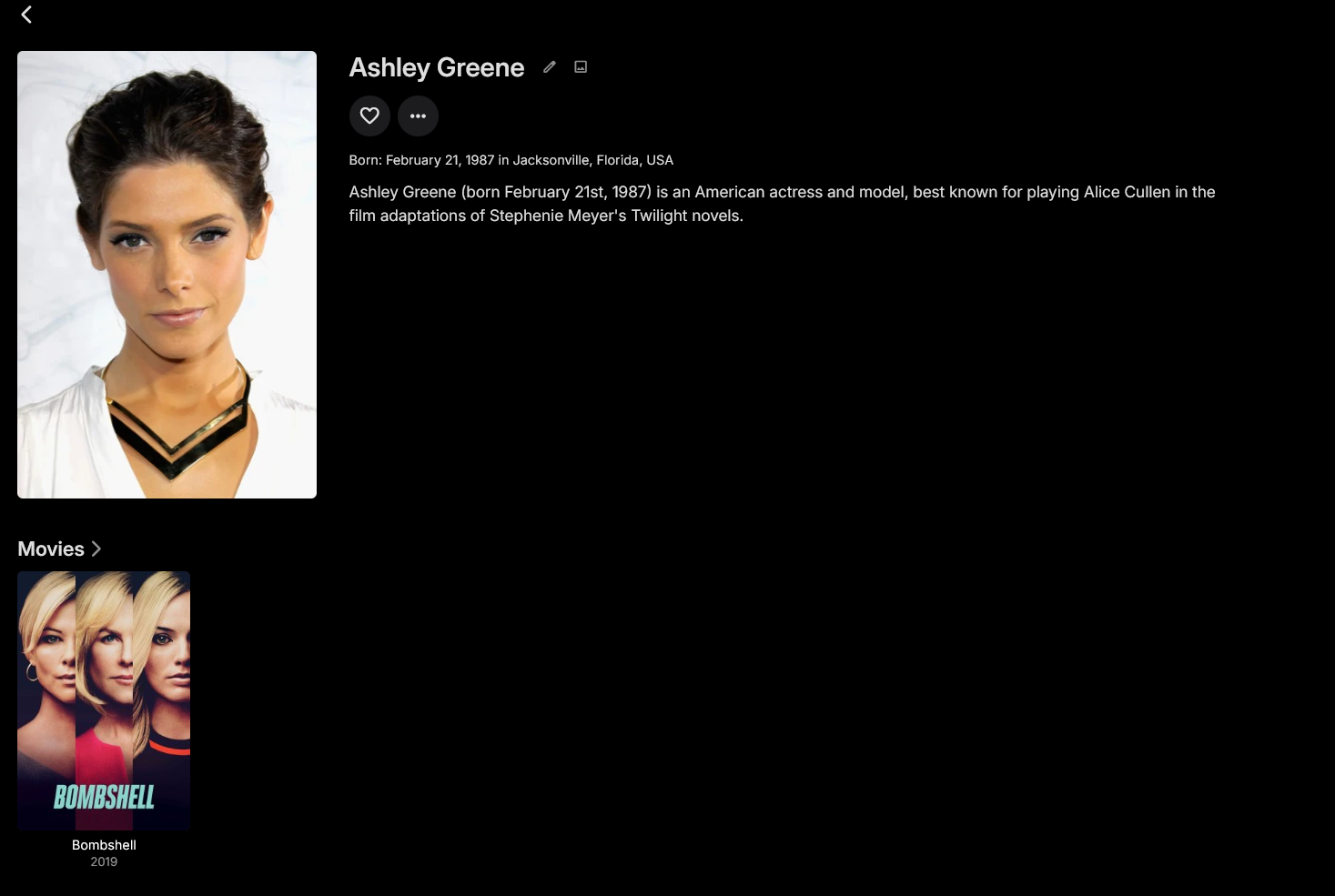

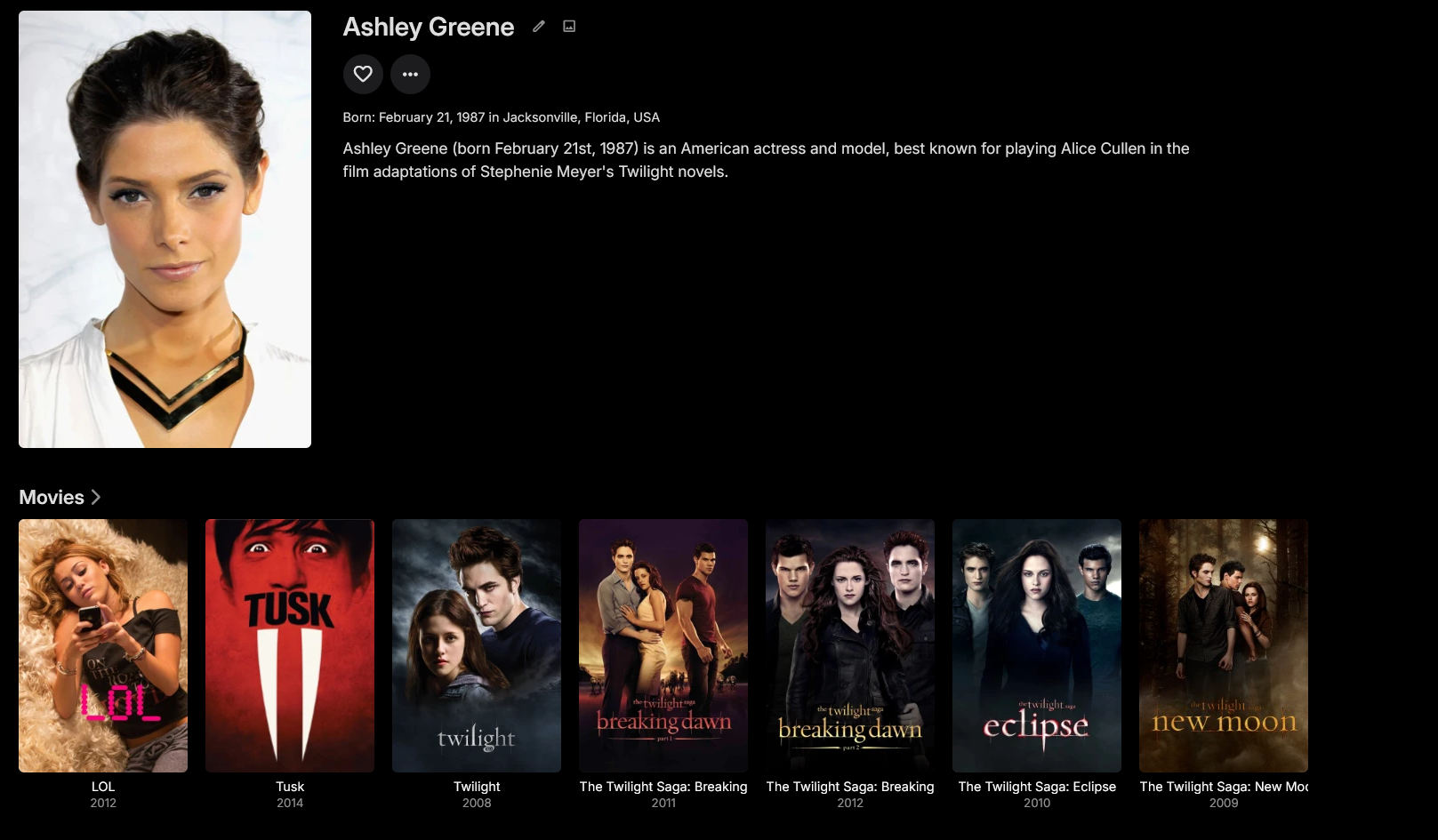

jakob2140 0 Posted July 24, 2024 Posted July 24, 2024 I noticed this today with Ashley Greene. This is a fairly new installation from around may this year. I hope this can be resolved without a reinstallation! Thanks.
Happy2Play 9798 Posted July 24, 2024 Posted July 24, 2024 1 hour ago, jakob2140 said: I noticed this today with Ashley Greene. This is a fairly new installation from around may this year. I hope this can be resolved without a reinstallation! Thanks. I always take the one with least amount of media attached so in this example the one with only one movie and removed all providerids or at works all metadata/image from that person and refresh metadata on the movie. That usually relinks the to the one with metadata. There is some database cleanup that happens but the /metadata/people folders are never removed.
jakob2140 0 Posted July 24, 2024 Posted July 24, 2024 1 hour ago, Happy2Play said: I always take the one with least amount of media attached so in this example the one with only one movie and removed all providerids or at works all metadata/image from that person and refresh metadata on the movie. That usually relinks the to the one with metadata. There is some database cleanup that happens but the /metadata/people folders are never removed. How do I do that? Thanks
Happy2Play 9798 Posted July 24, 2024 Posted July 24, 2024 4 minutes ago, jakob2140 said: How do I do that? Thanks ??? Go to the one with one movie, edit metadata remove providerids, hit save and refresh metadata on Bombshell.
jakob2140 0 Posted July 25, 2024 Posted July 25, 2024 11 hours ago, Happy2Play said: ??? Go to the one with one movie, edit metadata remove providerids, hit save and refresh metadata on Bombshell. That worked. Thank you.
