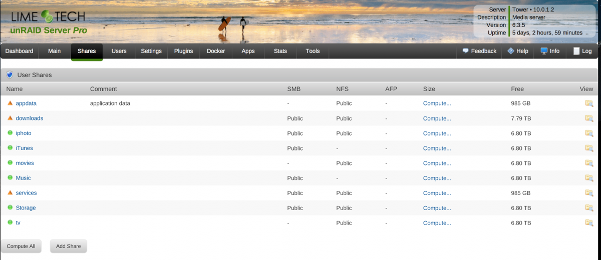

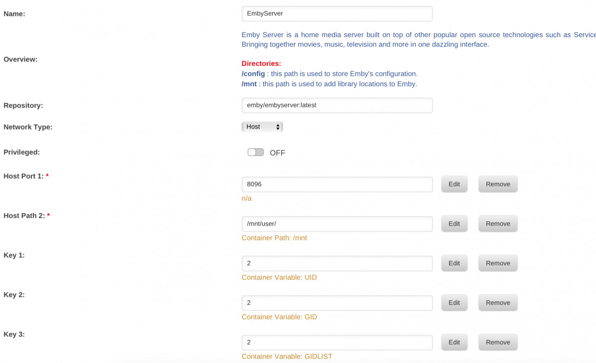

Endlogic 0 Posted February 1, 2018 Posted February 1, 2018 @@Luke not sure what exactly you'd want to see so I clipped a bunch of things haha. But main point, inside the user share Movies and TV are set up the same way. each series or movie inside separate folders. Stange that tv works and movies wouldn't. same permissions and I've had Emby work fine with it before so no clue where its coming from.
