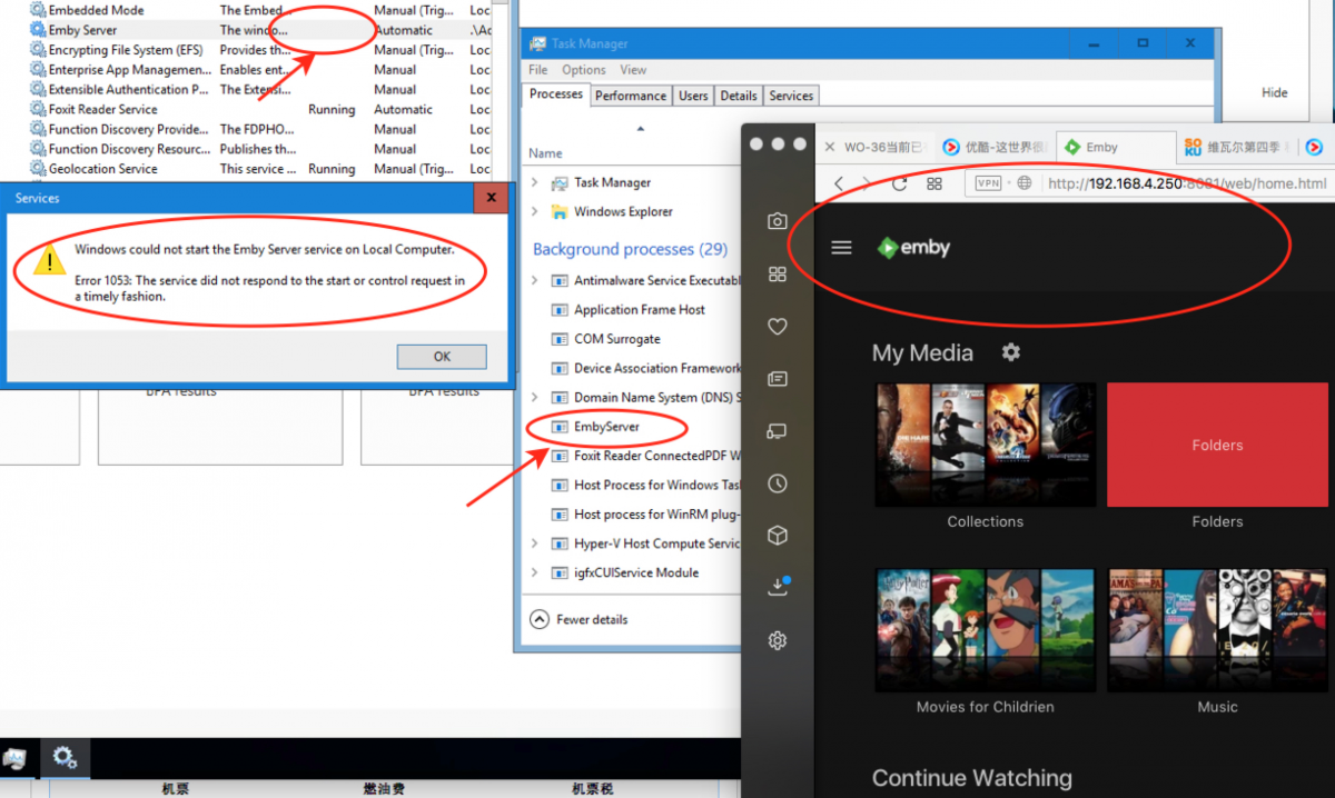

pcnetwiz 0 Posted January 20, 2018 Posted January 20, 2018 I've enjoyed Emby Server for a very long time. I've used many different flavors, and currently settled on a Window version. However, ever since the update of 3.2.60 (and the latest 3.2.70 didn't fix it either) I've experienced a strange problem with getting the Emby server service started, or rather getting Windows recognizing the service being started. Let me explain. Prior to 3.2.60 update, everything works fine without a hitch. But after the 3.2.60 update, the Windows could not start the service. However, if you manually start the service, you can see that the EmbyServer.exe executable is actually started, and I can browse from the browser normally. However, Windows service control will think that it couldn't start the service, hence throw an error message. (see attached image) Does anyone have similar issues? If I kill the EmbyServer process, and launch it manually from the start menu, the system works flawlessly. However, if I shutdown the EmbyServer, and start it manually from the Windows service control, samething happens. I can still use the service remotely. It's just annoying that Windows will always have a red Exclamation point saying that there is something wrong with one of my services. Thanks for any input in advance. Andrew,
Solution Happy2Play 9840 Posted January 20, 2018 Solution Posted January 20, 2018 Sorry there a dozens of topics on this. The original method no longer works (well it sort of work but not controlable). This a a big change in net core version. I would run "sc delete "Emby Server". Running Emby Server as a Windows Service 1
pcnetwiz 0 Posted January 20, 2018 Author Posted January 20, 2018 Are you suggesting to delete the existing Emby Windows service, and then use the NSSM in the URL you provided to create a new Windows Service? Thanks, I will give it a try! Andrew,

pcnetwiz 0 Posted January 20, 2018 Author Posted January 20, 2018 (Resolved) After deleting the old NT service, and creating a new one with the NSSM, everything is working again. @@Luke thank you for the tip. Andrew,
