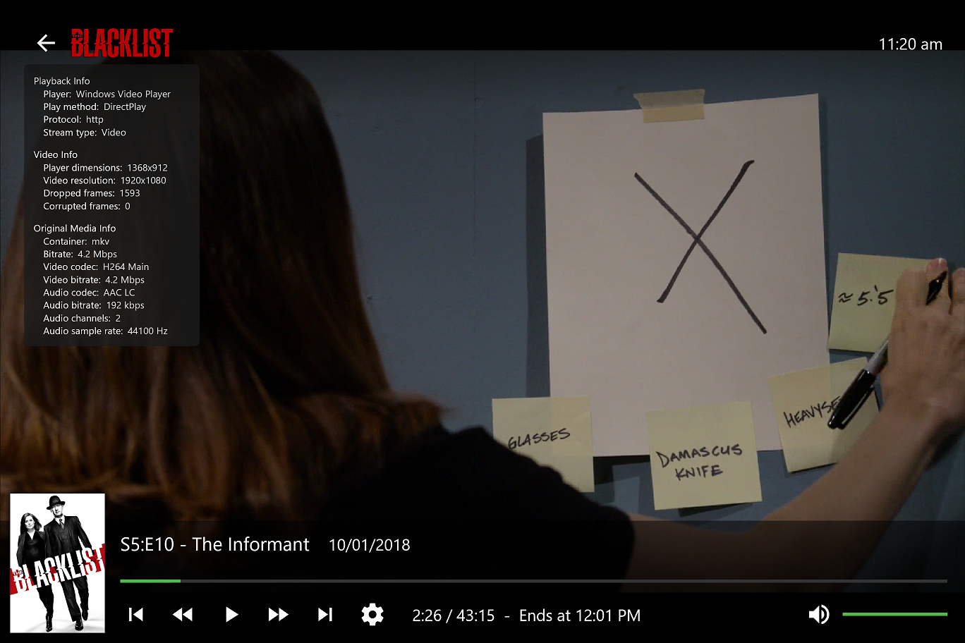

The first screenshot is with Connected Standby turned on. Notice that the after 2mins there are over 1500 dropped frames. Also notice that there is no buffering indication in the play bar.

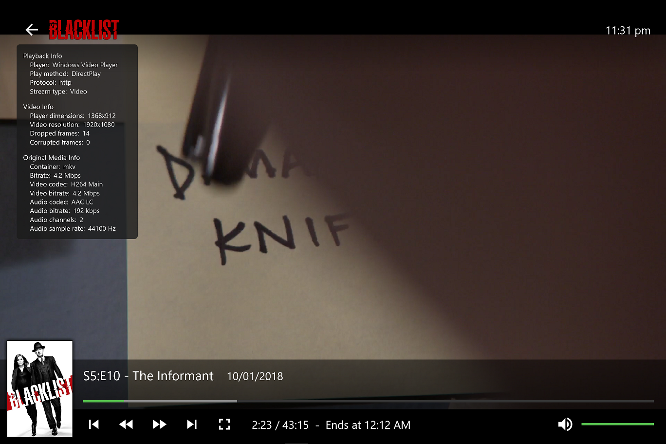

In this next screenshot, Connected Standby is disabled. After 2 mins there are only 14 dropped frames, and all of those were in the first few seconds. Notice that the play bar also shows that the video is actually buffering now.
