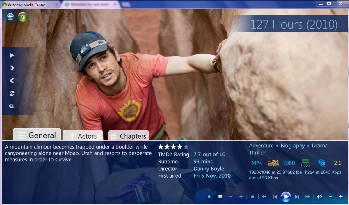

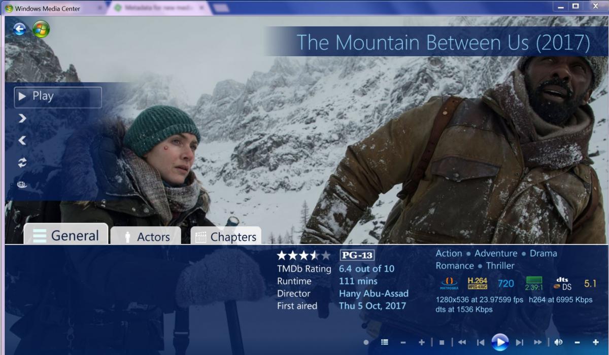

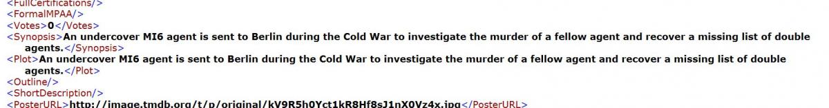

shavid0610 0 Posted January 15, 2018 Author Posted January 15, 2018 @@shavid0610, what metadata exactly is missing? Hi The synopsis is missing. The actors are all there, and the media info. I attach 2 screen shots, the first showing an older media file (127 Hours) that is working fine and the second showing the missing information (The Mountain Between Us). I will also attach a snip from the xml file for The Mountain Between us, which has the metadate present for the synopsis. I also had the Australian Classifications Icons working yesterday but today they have vanished again, so not sure what that is all about. Sharon

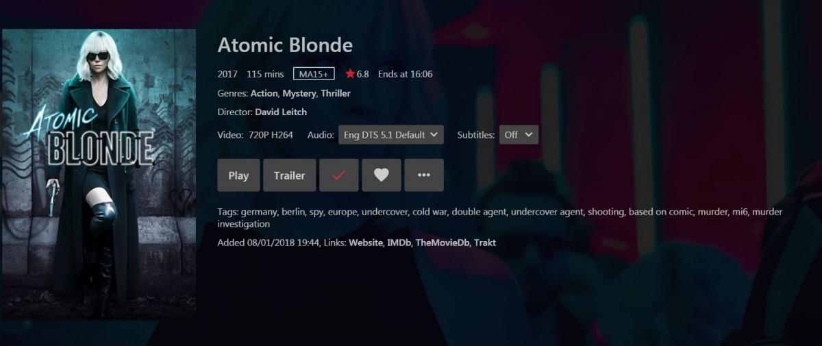

shavid0610 0 Posted January 15, 2018 Author Posted January 15, 2018 Just installed new a portable and xml plugin and added library. "Download artwork and metadata from the internet" disabled. Don't see any issues. This test was done on current beta server though. ***Tested on stable also without issue. Hi The issues I am having is within Emby for WMC with no synopsis showing up for new media. owever, I looked at a new title through the web browser and found that it is hsowing taglines only and not the synopsis there either, snips attached.
Solution Luke 42204 Posted January 15, 2018 Solution Posted January 15, 2018 Ok, so there's no Emby problem here, the problem is your xml. I don't know what software created that Xml, but it's formatted differently from the xml we support using the xml metadata plugin. For example, the overview should be in a node called "Overview" or "Description", not Synopsis. Sorry. At this point the best thing to do is refresh the titles manually using Emby and let Emby fetch internet metadata. 1
Happy2Play 9802 Posted January 15, 2018 Posted January 15, 2018 As far as I know Emby only reads "Overview" not "Synopsis". So is that field populated?
shavid0610 0 Posted January 15, 2018 Author Posted January 15, 2018 Hi My XML's are created with Media Center Master and all the previous media titles are working fine. It's only the new media I have added since re-loading the HTPC with Windows 7 and re-loading Emby from scratch along with MCM and all my other programs. Looking at an older xml it shows the overview is there but is missing with the new ones, so I'll follow up with Pete and see if he has changed something in the MCM settings that is not generating this field any more. Thank you for your help. Sharon
Happy2Play 9802 Posted January 15, 2018 Posted January 15, 2018 (edited) I use MCM and the screenshot above is xml metadata. Replied to post on MCM also. Edited January 15, 2018 by Happy2Play
