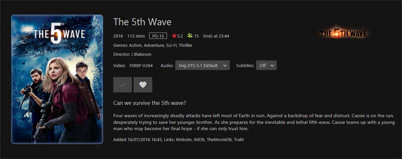

GhostRider 49 Posted January 12, 2018 Posted January 12, 2018 @@Luke, running via task scheduler is not a 100% solution. If you log on to the server machine and use the web interface the play and trailer buttons are missing. Please consider bringing back the service installation.
Luke 42210 Posted January 12, 2018 Posted January 12, 2018 @@Luke, running via task scheduler is not a 100% solution. If you log on to the server machine and use the web interface the play and trailer buttons are missing. Please consider bringing back the service installation. The play and trailer buttons won't have anything to do with task scheduler. As always we're happy to help. Please see how to report a problem. Thanks !

Luke 42210 Posted January 12, 2018 Posted January 12, 2018 Agree with dcook. Coding a Windows service should be well documented and easier to add than all the complex stuff the Devs do. Apologies for adding to this thread but the scheduled task method does not work 100%. I doubt it is a server issue, feels more like the task has no console connection. A log file attached for @@Luke in case it helps. Where exactly is the play and trailer button missing from? can you show screenshot examples? thanks.
GhostRider 49 Posted January 12, 2018 Posted January 12, 2018 (edited) its on the main movie page. No means to play the movie. Edited January 12, 2018 by GhostRider

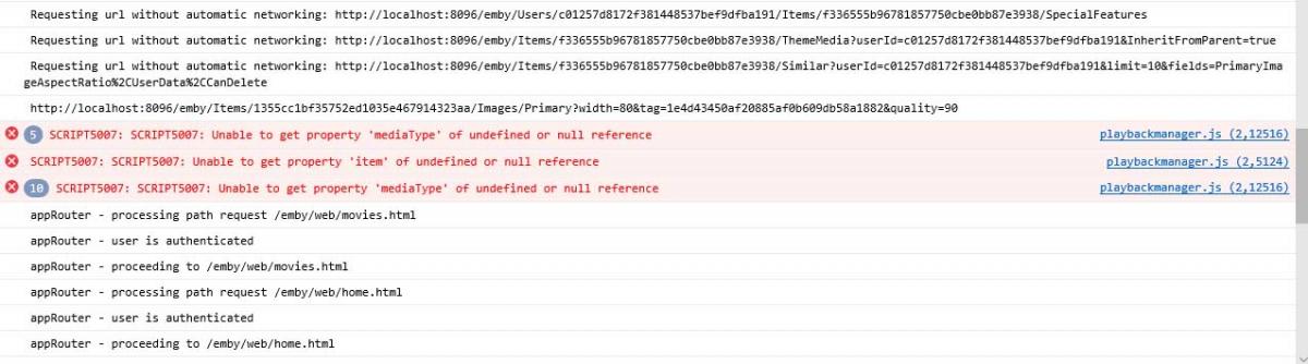

GhostRider 49 Posted January 12, 2018 Posted January 12, 2018 (edited) Hi Luke, Browser is Edge, console has some errors see attached. Edited January 12, 2018 by GhostRider

GhostRider 49 Posted January 13, 2018 Posted January 13, 2018 Hi Luke, Browser is Edge, console has some errors see attached. @@Luke, does the browser console help with any pointers why the play and trailer buttons disappear? Not expecting an immediate fix but would be keen to hear if the cause of the problem can be identified and there is hope for the scheduled task approach in a future release.
Luke 42210 Posted January 13, 2018 Posted January 13, 2018 @@Luke, does the browser console help with any pointers why the play and trailer buttons disappear? Not expecting an immediate fix but would be keen to hear if the cause of the problem can be identified and there is hope for the scheduled task approach in a future release. I'm not quite sure. Haven't seen this before, but I'm making a couple adjustments to try and avoid what might be causing this. Please try again with the next release of emby server. thanks.
