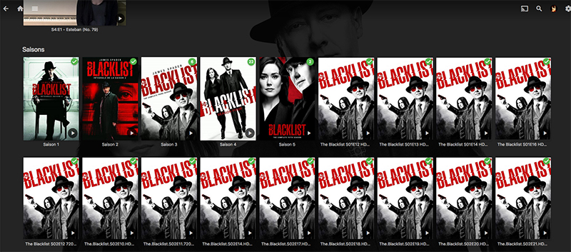

glenllivet 0 Posted January 12, 2018 Posted January 12, 2018 (edited) Hello,I built my library some days ago and there is something that I don't understand...Some TV episodes are correctly named and appear inside a season 'folder' in the library.The NFO seems to be correct.But then, some of them also appear outside the season folders, with the file name...Have a look at this screen capture:At first, I thought about naming conventions and folder structure, but it doesn't seem to be the problem because other series are named like this and don't have any issue. Edited January 12, 2018 by glenllivet

glenllivet 0 Posted January 13, 2018 Author Posted January 13, 2018 (edited) Some episodes are directly in the series folder:/video/TV Series/The Blacklist/ Some others (like the ones above) are in a subfolder: /video/TV Series/The Blacklist/The Blacklist S01E12 HDTV x264-LOL[ettv] At first, I thought it could be a problem, but some other series have the exact same folder structure and are correctly listed...Even some of the same show (like this one: /video/TV Series/The Blacklist/The Blacklist S02E01 HDTV x264-LOL[ettv] ) do not appear in the incorrect items. Edited January 13, 2018 by glenllivet

glenllivet 0 Posted January 17, 2018 Author Posted January 17, 2018 (edited) No, it's not.21 episodes are incorrect (see the screenshot below)As you can see, all the incorrect episodes are in subfolders... but not all of the episodes in subfolders are incorrect! (S01E02, S02E08, S02E09, etc. are correct).I really don't understand what could be the issue...Moreover, I noticed this morning that some episodes are listed several times inside Season 2 only (even S02e08, which is not appearing incorrectly on the main show page is listed three times inside Season 2 page ; S02E10 is listed twice, ...).EDIT : as far as these are concerned, I have a clue.Inside the episode folder, I found a subfolder containing a sample (e.g. 'the.blacklist.210.hdtv-lol.sample.mp4').I think the sample has been considered as an episode too because the duplicate entries disappeared when I earsed these.And episode 2x08 appeared three times because I realised that it had been downloaded twice under different names (+ the sample). Edited January 17, 2018 by glenllivet
glenllivet 0 Posted January 17, 2018 Author Posted January 17, 2018 I tried this:1)- move some episodes (S01E12 and S02E10) subfolders to a temp folder somewhere else- update metadata for the show--> As expected they are correctly removed from the library.- then I put them back in the show folder and updated metadata again--> They were incorrectly listed as they were before.2)- I erased the nfo files for these episodes and updated the metadata: nothing changes... but no new nfo is created inside the episode subfolder.3)- Moved the video and subtitles files to the main folder of this show, updated metadata --> As expected, everything is fine.In conclusion, I don't why some folders are well handled by the scan and other don't but it definitely seems that the issue comes from the folder structure/naming.
