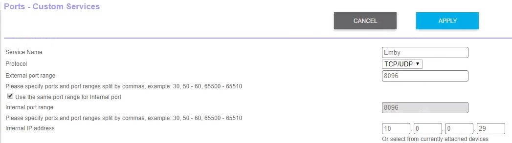

justinds89 3 Posted January 11, 2018 Author Posted January 11, 2018 Okay, there is really only one way to forward the port on the router though and I even rebooted the router after forwarding the port to make sure the rule was active. Here is a screenshot for reference. The Internal IP Address is the local IP of the server running Emby.
Koame 0 Posted January 11, 2018 Posted January 11, 2018 Okay, there is really only one way to forward the port on the router though and I even rebooted the router after forwarding the port to make sure the rule was active. Here is a screenshot for reference. The Internal IP Address is the local IP of the server running Emby. Hi - You need to specify the device you're forwarding and the IP address - make sure that you've given the device a static internal IP to make that task easier. If you could also let us know what router you're using I can hopefully find a guide on forwarding on that specific router for you.
justinds89 3 Posted January 11, 2018 Author Posted January 11, 2018 Hi - You need to specify the device you're forwarding and the IP address - make sure that you've given the device a static internal IP to make that task easier. If you could also let us know what router you're using I can hopefully find a guide on forwarding on that specific router for you. Hello! I did specify the device and IP address. The internal IP address is to the server itself. The router I am using is a Netgear Orbi.
Koame 0 Posted January 11, 2018 Posted January 11, 2018 Hello! I did specify the device and IP address. The internal IP address is to the server itself. The router I am using is a Netgear Orbi. Looking up that router - it seems you need to disable UpNP to allow port forwarding to work, can you disable and test again? May need to reboot the router again afterwards.

justinds89 3 Posted January 11, 2018 Author Posted January 11, 2018 You need to use the external IP, not the the local IP. I thought I was forwarding the port to the local IP of the server? So basically when I hit the external IP it points it to the internal server. I don't see how putting the external IP in there would work at all, but I can try it.
ebr 16312 Posted January 11, 2018 Posted January 11, 2018 You need to use the external IP, not the the local IP. No, he needs to map to the internal address of the server machine.

Koame 0 Posted January 11, 2018 Posted January 11, 2018 I thought I was forwarding the port to the local IP of the server? So basically when I hit the external IP it points it to the internal server. I don't see how putting the external IP in there would work at all, but I can try it. Do you have the model number of the router to hand? Seems like there's a few differences per router on that product range.

justinds89 3 Posted January 11, 2018 Author Posted January 11, 2018 Do you have the model number of the router to hand? Seems like there's a few differences per router on that product range. The model number is RBR50.
Koame 0 Posted January 11, 2018 Posted January 11, 2018 The model number is RBR50. Can you follow this for me and see how far you get?

justinds89 3 Posted January 11, 2018 Author Posted January 11, 2018 Can you follow this for me and see how far you get? I have done everything in that link already except for the port check. I went through everything again to make sure and I rand their port checker. I get "Your port is NOT OPEN or not reachable!". I don't see what else I can really do differently as far as the forwarding goes.
Koame 0 Posted January 11, 2018 Posted January 11, 2018 I have done everything in that link already except for the port check. I went through everything again to make sure and I rand their port checker. I get "Your port is NOT OPEN or not reachable!". I don't see what else I can really do differently as far as the forwarding goes. I've had similar issues in the past that only started working after a full factory reset of the router. All else fails, try that and if that continues to not work; contact the manufacturer as this will be an issue with the router itself.
