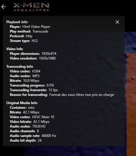

Radeon24 4 Posted April 3, 2018 Posted April 3, 2018 (edited) Thank you for your answer @@Luke , there is the logs and screenshots taken when i try to play an HEVC/H265 file. The result is the same with Emby Theater. Plese tell me if you need more informations . server_log.txt ffmpeg_h265_log.txt Edited April 3, 2018 by Radeon24
Luke 42208 Posted April 3, 2018 Posted April 3, 2018 It's burning in subtitles and that can use a lot of resources. You could try playing something else that doesn't require that. The next release of emby server will also have an updated ffmpeg which may help.
Radeon24 4 Posted April 3, 2018 Posted April 3, 2018 Without subtitles, I have 22fps transcoding instead of 13, but it's still software transcode : 100% CPU, 1% GPU. Do you think the next ffmpeg release will correct that problem ? Thanks !
Luke 42208 Posted April 3, 2018 Posted April 3, 2018 This is something that varies per environment. You will have to try and let us know. I would suggest making sure that Windows is fully up to date and that your graphics drivers are up to date.
