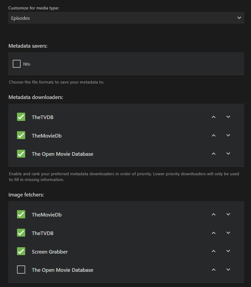

ebr 16310 Posted January 8, 2018 Posted January 8, 2018 Do you have the screen grabber enabled for episodes?
feerlessleadr 173 Posted January 8, 2018 Author Posted January 8, 2018 (edited) It is enabled for episodes (although it is the lowest priority): Edited January 8, 2018 by feerlessleadr

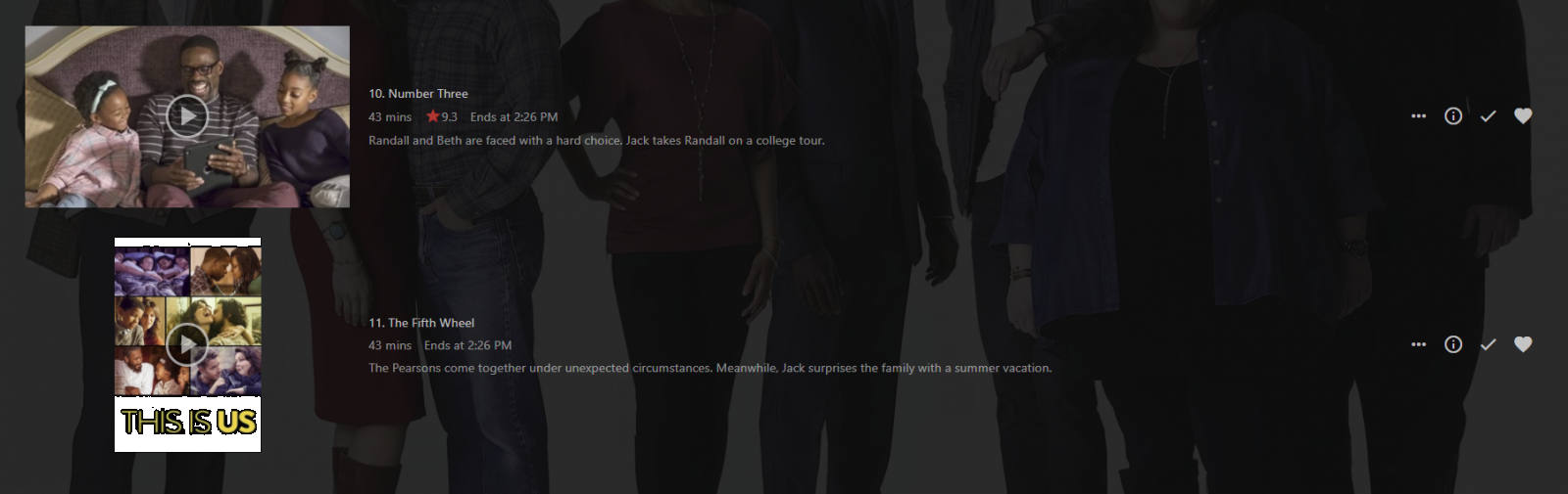

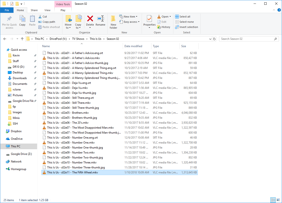

feerlessleadr 173 Posted January 10, 2018 Author Posted January 10, 2018 (edited) So I forgot to turn on debug logging, but the same thing happened last night with a new episode of This is Us (season 2 episode 11). See the attached log. This appears to be the relevant section of the log, which is very strange: 2018-01-10 02:08:39.504 Info LibraryMonitor: Season 2 (V:\TV Shows\This Is Us\Season 02) will be refreshed.2018-01-10 02:08:39.504 Info LibraryMonitor: This Is Us (V:\TV Shows\This Is Us) will be refreshed.2018-01-10 02:08:39.786 Info HttpClient: POST: https://api.opensubtitles.org/xml-rpc2018-01-10 02:08:40.098 Info HttpClient: POST: https://api.opensubtitles.org/xml-rpc2018-01-10 02:08:40.238 Info HttpClient: GET: https://api.themoviedb.org/3/tv/67136/season/2/episode/11?api_key=f6bd687ffa63cd282b6ff2c6877f2669&append_to_response=images,external_ids,credits,videos&language=en&include_image_language=en,null2018-01-10 02:08:40.368 Info HttpClient: GET: https://image.tmdb.org/t/p/original/hWiDctyD1t4Cy2ow4Byzm6dkIu2.jpg2018-01-10 02:08:40.488 Info ProviderManager: Saving image to V:\TV Shows\This Is Us\Season 02\This Is Us - s02e11 - The Fifth Wheel-thumb.jpg2018-01-10 02:08:45.697 Info App: Emby.Kodi.SyncQueue: Starting Library Sync...2018-01-10 02:08:45.844 Info App: Emby.Kodi.SyncQueue: "LIBRARYSYNC" Added 1 items: 97b80fd2cdb93bd311d9b98cae7e75662018-01-10 02:08:45.844 Info App: Emby.Kodi.SyncQueue: "LIBRARYSYNC" Removed 0 items:2018-01-10 02:08:46.206 Info App: Emby.Kodi.SyncQueue: "LIBRARYSYNC" Updated 1 items: a2352f1617b3b4088ad0eb833cae626f2018-01-10 02:08:46.206 Info App: Emby.Kodi.SyncQueue: Finished Library Sync Taking 00:00:00.50916282018-01-10 02:08:59.661 Info Trakt: Timer elapsed - Processing queued items It looks like Emby thinks that it saved the thumbnail to the correct location, but when I look on the hard disk, that file is not there. Additionally, in the Emby interface, the episode shows that there is no thumbnail. I can re-download the thumb using the emby interface and it shows up fine however. I don't think this is a permissions issue, since all of my media folders are full access. server-63651139200.txt Edited January 10, 2018 by feerlessleadr
feerlessleadr 173 Posted January 10, 2018 Author Posted January 10, 2018 Here is what I see in emby for that episode. I also included another episode that does have a thumb present on the hard disk: Not sure why the poster looks like that, but it has to be something with my screenshot software. On my hard disk, you can see that no thumb was created:
Luke 42210 Posted January 10, 2018 Posted January 10, 2018 Maybe something else deleted the image? because if there was a failure to save it would be in the log. maybe what you can do next time is monitor a new episode personally as it is imported.
feerlessleadr 173 Posted January 10, 2018 Author Posted January 10, 2018 Maybe something else deleted the image? because if there was a failure to save it would be in the log. maybe what you can do next time is monitor a new episode personally as it is imported. Thanks Luke - I'll check it out tonight (hopefully this happens again). I'm not sure what else would be deleting the image, I don't have any post processing scripts running, or anything like that. I'll check it out though.
feerlessleadr 173 Posted January 10, 2018 Author Posted January 10, 2018 (edited) I don't have metadata saved in NFO files. I just use the default emby xml files, since I use the emby for kodi addon and don't need other programs to read the nfo files. Although now that I'm looking at my library settings under metadata, I don't see an option for emby xml files anymore, just an option for nfo files. Edited January 10, 2018 by feerlessleadr
Luke 42210 Posted January 10, 2018 Posted January 10, 2018 The xml option became legacy a long time ago. Nfo has been our default for quite some time. Probably three years now.
feerlessleadr 173 Posted January 10, 2018 Author Posted January 10, 2018 yikes! I guess you can see how long it's been since I've touched that option. I'm assuming, I should go ahead and re-enable nfo?
Luke 42210 Posted January 10, 2018 Posted January 10, 2018 Yes but it shouldn't have any impact on this particular topic.
feerlessleadr 173 Posted January 10, 2018 Author Posted January 10, 2018 Got it - thanks. I'll re-enable, but still try to see this live later tonight.
