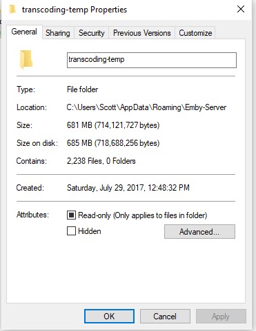

Scott D 69 Posted January 9, 2018 Posted January 9, 2018 (edited) I experience the same thing on a regular basis. Just read this post this morning and sure enough, I have a sample from last night. See attached. Hope this helps. Server Log.txt ffmpeg Log - MBU Movie.txt ffmpeg-Snowman Movie.txt Edited January 9, 2018 by Scott D

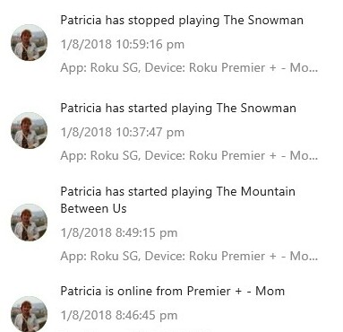

ebr 16354 Posted January 9, 2018 Posted January 9, 2018 This is very interesting: 2018-01-08 22:35:51.601 Info HttpServer: HTTP Response 204 to REDACTED. Time: 2ms. http://REDACTED:8096/emby/Sessions/Playing/Progress 2018-01-08 22:36:37.764 Info HttpServer: HTTP GET http://REDACTED:8096/emby/system/info/public?format=json. UserAgent: Roku/DVP-8.1 (298.01E04042A) 2018-01-08 22:36:37.765 Info HttpServer: HTTP Response 200 to REDACTED. Time: 1ms. http://REDACTED:8096/emby/system/info/public?format=json 2018-01-08 22:36:38.158 Info HttpServer: HTTP GET http://REDACTED:8096/emby/system/info?format=json. UserAgent: Roku/DVP-8.1 (298.01E04042A) 2018-01-08 22:36:38.178 Info HttpServer: HTTP Response 200 to REDACTED. Time: 20ms. http://REDACTED:8096/emby/system/info?format=json 2018-01-08 22:36:38.757 Info HttpServer: HTTP GET http://REDACTED:8096/emby/Users/f1af3a9554ff415b88568f4ae6824c53. UserAgent: Roku/DVP-8.1 (298.01E04042A) 2018-01-08 22:36:38.759 Info HttpServer: HTTP Response 200 to REDACTED. Time: 1ms. http://REDACTED:8096/emby/Users/f1af3a9554ff415b88568f4ae6824c53 2018-01-08 22:36:39.256 Info HttpServer: HTTP POST http://REDACTED:8096/emby/Sessions/Capabilities/Full. UserAgent: Roku/DVP-8.1 (298.01E04042A) 2018-01-08 22:36:39.315 Info HttpServer: HTTP Response 204 to REDACTED. Time: 58ms. http://REDACTED:8096/emby/Sessions/Capabilities/Full It looks like the app re-started during playback (or perhaps at the very end of the first movie). Do you know if maybe she hit the Roku "Home" button during the credits and then re-opened the app?
Scott D 69 Posted January 9, 2018 Posted January 9, 2018 This is very interesting: 2018-01-08 22:35:51.601 Info HttpServer: HTTP Response 204 to REDACTED. Time: 2ms. http://REDACTED:8096/emby/Sessions/Playing/Progress 2018-01-08 22:36:37.764 Info HttpServer: HTTP GET http://REDACTED:8096/emby/system/info/public?format=json. UserAgent: Roku/DVP-8.1 (298.01E04042A) 2018-01-08 22:36:37.765 Info HttpServer: HTTP Response 200 to REDACTED. Time: 1ms. http://REDACTED:8096/emby/system/info/public?format=json 2018-01-08 22:36:38.158 Info HttpServer: HTTP GET http://REDACTED:8096/emby/system/info?format=json. UserAgent: Roku/DVP-8.1 (298.01E04042A) 2018-01-08 22:36:38.178 Info HttpServer: HTTP Response 200 to REDACTED. Time: 20ms. http://REDACTED:8096/emby/system/info?format=json 2018-01-08 22:36:38.757 Info HttpServer: HTTP GET http://REDACTED:8096/emby/Users/f1af3a9554ff415b88568f4ae6824c53. UserAgent: Roku/DVP-8.1 (298.01E04042A) 2018-01-08 22:36:38.759 Info HttpServer: HTTP Response 200 to REDACTED. Time: 1ms. http://REDACTED:8096/emby/Users/f1af3a9554ff415b88568f4ae6824c53 2018-01-08 22:36:39.256 Info HttpServer: HTTP POST http://REDACTED:8096/emby/Sessions/Capabilities/Full. UserAgent: Roku/DVP-8.1 (298.01E04042A) 2018-01-08 22:36:39.315 Info HttpServer: HTTP Response 204 to REDACTED. Time: 58ms. http://REDACTED:8096/emby/Sessions/Capabilities/Full It looks like the app re-started during playback (or perhaps at the very end of the first movie). Do you know if maybe she hit the Roku "Home" button during the credits and then re-opened the app? I cannot say how she got from one movie to another. But I have similar results almost daily. I have been restarting my server on a daily basis for quite some time. This always clears the cache. I will try a few tests on my end so I can report back.
ebr 16354 Posted January 9, 2018 Posted January 9, 2018 I cannot say how she got from one movie to another. But I have similar results almost daily. I have been restarting my server on a daily basis for quite some time. This always clears the cache. I will try a few tests on my end so I can report back. I can reproduce this scenario by hitting the home button during playback. I'll see how the app can properly handle that and get a beta out for you to test. Thx.
ebr 16354 Posted January 9, 2018 Posted January 9, 2018 Oh, my... it appears based on my research that there is absolutely no notification to the app when the user exits via the "Home" button. My initial testing appears to confirm that research.
