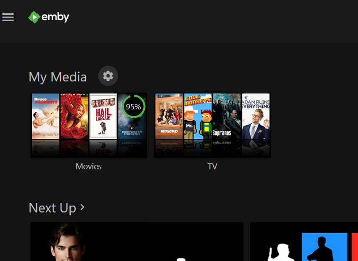

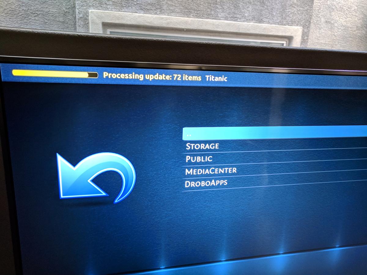

ChipWhisperer 5 Posted January 7, 2018 Posted January 7, 2018 This will be part 2 of this problem. I originally posted it in the Kodi section of the forums, but was told incremental syncs are initiated server side, and not by the Kodi addon. After a few restarts of the server, the problem seems to have gone away, but it's back again. Essentially, there appears to be some sort of library scanning loop. The server goes over the same 72ish items over and over again.This can be seen in Kodi and on the server Dashboard, as it dutifully does the 90-100% of the library scan repeatedly. Once the scan reaches 100% ,Kodi incrementally updates the 72 items, and the process begins again. The previous Topic is here: https://emby.media/community/index.php?/topic/54446-incremental-sync-running-frequently-always-seems-to-be-parsing-same-items/ Thank you! log1.txt log2.txt
Luke 42204 Posted January 7, 2018 Posted January 7, 2018 Hi there, can you please discuss some examples of what exactly is being resynced. There are some videos here that had subtitles downloaded during the library scan, so those certainly i imagine would be resynced.
ChipWhisperer 5 Posted January 7, 2018 Author Posted January 7, 2018 Hi there, can you please discuss some examples of what exactly is being resynced. There are some videos here that had subtitles downloaded during the library scan, so those certainly i imagine would be resynced. While the photos seem to suggest a scan of the TV Library, the updates that flow by in Kodi have all been movies as far as I can tell.
ChipWhisperer 5 Posted January 7, 2018 Author Posted January 7, 2018 Sorry. I misspoke in my previous reply. The scans are of the movie library, and the photos show that.
