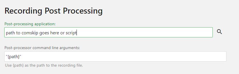

Luke 42245 Posted January 5, 2018 Posted January 5, 2018 What you can do is configure a recording post processor in Emby settings, and then use a comskip application to post process and remove the commercials after a recording. 2

dcrdev 255 Posted January 5, 2018 Posted January 5, 2018 Comskip doesn't actually remove the commercials - it detects and bookmarks them in an edl file, I don't believe emby supports edl. So you need to re-encode them in your post processing script as well - to do that in the context of docker, you'd have to put the comskip binary, post processing script in a folder that's exposed to the docker container for example your media folder. Then your best bet would be to look at this: https://emby.media/community/index.php?/topic/45267-using-comskip/ 2

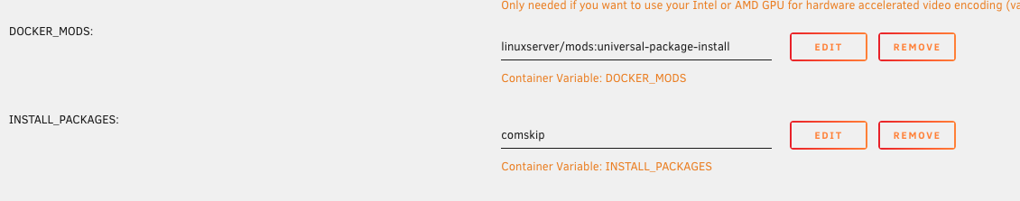

Skitals 2 Posted December 8, 2022 Posted December 8, 2022 Since this is the #1 google result when you search "emby comskip docker", I will post what I have learned. It is stupid easy to get comskip installed and working in linuxserver.io's emby docker container thanks to their docker mod layer and the universal-package-install mod. 1) To your lscr.io/linuxserver/emby container add two environment variables: DOCKER_MODS=linuxserver/mods:universal-package-install and INSTALL_PACKAGES=comskip 2) Put the comskipper dll into the emby appdata plugins folder. 3) Find a suitable comskip.ini and put into the emby appdata folder. 4) Emby settings Recording Post Processing Post-processing application: /usr/bin/comskip Post-processor command line arguments: --ini=/config/comskip.ini "{path}" That's it. comskip will run after a recording and create your edl file, the comskipper plugin will read the edl during playback and auto skip commercials.

pix64 2 Posted August 24, 2023 Posted August 24, 2023 here is was seems to have worked for me at the moment AND, it wasn't until AFTER i was sure the INI file was in the right place, && the live TV post processing steps were correctly entered, did it actually install on the docker run/compose step I do think I may have a permissions issue though as my emby log shows this after recording completes...which Im not sure at the moment how to fix Fontconfig error: No writable cache directories Fontconfig error: No writable cache directories Fontconfig error: No writable cache directories Fontconfig error: No writable cache directories /usr/bin/comskip: /app/emby/libstdc++.so.6: version `GLIBCXX_3.4.29' not found (required by /lib/x86_64-linux-gnu/libopenmpt.so.0) /usr/bin/comskip: /app/emby/libstdc++.so.6: version `GLIBCXX_3.4.29' not found (required by /lib/x86_64-linux-gnu/libchromaprint.so.1) /usr/bin/comskip: /app/emby/libstdc++.so.6: version `GLIBCXX_3.4.29' not found (required by /lib/x86_64-linux-gnu/libsrt-gnutls.so.1.4) /usr/bin/comskip: /app/emby/libstdc++.so.6: version `GLIBCXX_3.4.29' not found (required by /lib/x86_64-linux-gnu/libzmq.so.5)
