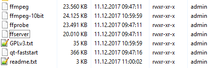

DaOptika 0 Posted January 2, 2018 Author Posted January 2, 2018 - I downloaded the armhf-build from here: https://johnvansickle.com/ffmpeg/ - Extracted the package and copied to: /usr/local/bin/ffmpeg_static/ - Then I set the Execute-Bit for every file - I set the transcode-path in Emby to /usr/local/bin/ffmpeg_static/
Luke 43720 Posted January 2, 2018 Posted January 2, 2018 Are you sure you set the execute bit for the ffprobe file because it looks like it's having trouble launching ffprobe. That's what it looks like from the log file at least.
DaOptika 0 Posted January 2, 2018 Author Posted January 2, 2018 (edited) Yes, I set it for every file Edited January 2, 2018 by DaOptika
