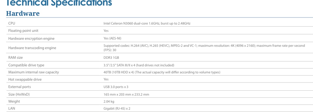

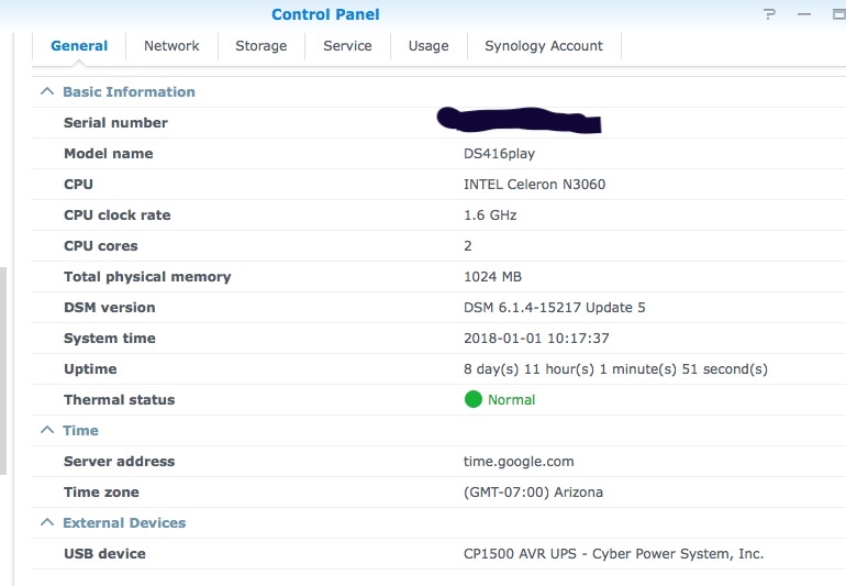

Landonth 0 Posted January 1, 2018 Posted January 1, 2018 Hi guys, I am running "the other guys" media server and am having trouble with Live TV play back being choppy/freezing, I am looking at installing Emby instead. But before I spend a bunch of time migrating everything over I wanted to see if I could get some feedback first. I am running a Synology DS416play and have a HDHomeRun connect DUO. Live TV from the HDHR app works fine as well as the HDHR DVR software running on the synology. Does Emby have the same issues with Live TV as the "other guys" media server? Is this a known issue? Or is the DS416play not powerful enough to do this? Specs for the Synology DS416play are attached. I have checked the CPU/Server load/Network speeds and nothing seems to be overloaded or saturated, so this make me think this is a bug. Thanks, Landon
