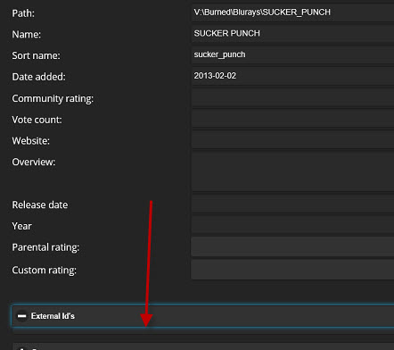

ebr 16357 Posted March 10, 2014 Posted March 10, 2014 And for my latest issue I attached a screenshot. I have no way of entering in the IMDB or TMDB codes because for some reason the dropdown is empty. I tried restarting the server, but that didn't fix it. From what I see, there's no way to fix this one. This means that the item was not identified as a show. It probably thinks it is just a folder. Look at the structure of that item and be sure it conforms to the accepted standards.
