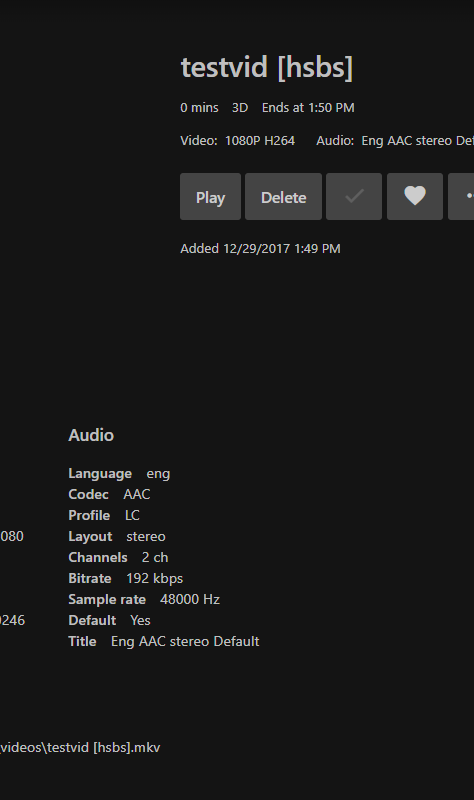

Luke 42201 Posted December 29, 2017 Posted December 29, 2017 Hi, I just tested this, no problem found.

chjohans 34 Posted December 29, 2017 Author Posted December 29, 2017 Glad it works for you, however that does not help me at all Any other suggestions? This is driving me nuts and something changed at some point that broke this (for me). I noticed you use lowercase in your filename for [hsbs], I use upper case as in [HSBS] but can't be that simple. But according to the info here (https://github.com/MediaBrowser/Wiki/wiki/3D%20videos) 3D files are identified by either a "file name tag" or by manually using the web interface. This is consistent with what I was told on this forum some time ago when I asked how to identify 3D files. So I thought nothing else in the metadata could cause 3D to be (un)identified? And how is this consistent with " I am guessing it is due to whatever metadata file is supplied by mcm"? See the attached .nfo files (generated by MCM) Avengers, Age of Ultron (2015) [HSBS].nfo - this one is correctly identified as 3D, media filename is the same except with mp4 extention. Captain America, The First Avenger (2011) [HSBS].nfo - this one is *not* identified as 3D, media filename is the same except with mp4 extention. Both of these were correctly identified by Emby as 3D "some time ago", sorry but can't really be more specific as to when this broke.

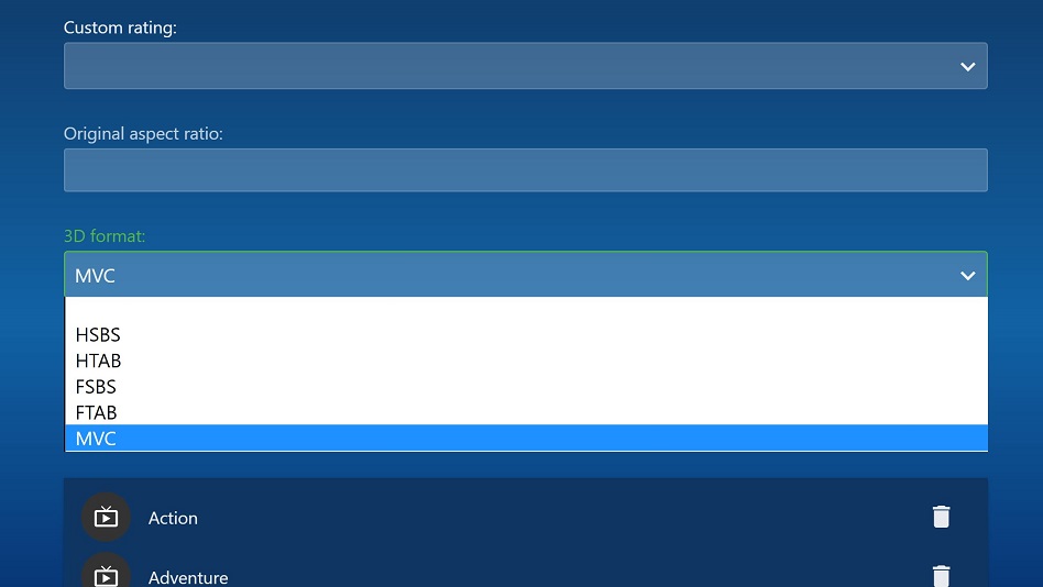

Guest asrequested Posted February 3, 2018 Posted February 3, 2018 In the mean time, if you use the web app, and use edit info, you can choose the 3D type.

chjohans 34 Posted February 3, 2018 Author Posted February 3, 2018 I can do that, but as I wrote in my initial post once a media library scan is run the 3D type is removed again and it's set back to non-3D. In the mean time, if you use the web app, and use edit info, you can choose the 3D type.

chjohans 34 Posted February 19, 2018 Author Posted February 19, 2018 Sure, but in my installation the server has no write access to my movies folders, something I for many reasons can't easily change. So Emby never writes any .nfo's. So I would appreciate it if you had an example .nfo from a 3D movie. If Luke can't give an example, I would greatly appreciate if someone else could post an exampe nfo for a 3D movie. It all else fails I will set up a test server Emby installation, something I probably should have anyhow. Something has changed in the server since I posted the above though. If I manually set "3D format" to HSBS this were just reset back to "blank" the next library scan. But now at least on the latest beta server the value sticks so if I manually set my 3D titles to HSBS it is not deleted the next library scan and CoverArt will add the proper 3D symbol.

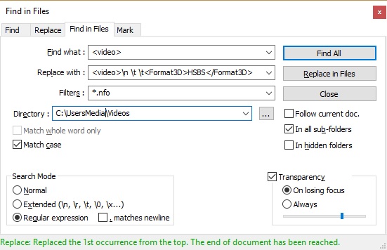

Happy2Play 9802 Posted February 19, 2018 Posted February 19, 2018 @@chjohans Is there a reason you don't just use the xml plugin as you don't have Emby write metadata? Last resort you could do something like this to add <Format3D>HSBS</Format3D> with notepad++.
chjohans 34 Posted February 19, 2018 Author Posted February 19, 2018 Thanks. I did try an import with xml as preferred metadata reader, Emby still didn't recognize my 3D files. I also tried to add the exact same Format3D tag to my nfo's, in the <video> section, but still a no go. I ended up just setting HSBS manually in Emby metadata manager, it's just 80 titles so not a big deal. And the setting seems to "stick" through a library scan now, in previous versions it would just reset it to "blank". I've asked Pete over at the MCM forum to add the appropriate 3D tag(s) to the nfo's created by MCM. There seems to be a slight issue with the CoverArt plugin and how the "3D overlay" is added back, some of my 3D titles has it now and some don't. But at least they're all tagged (manually) as 3D/HSBS so maybe CoverArt will do "it's thing" for all my 3D titles with time. Not sure how that logic works.
