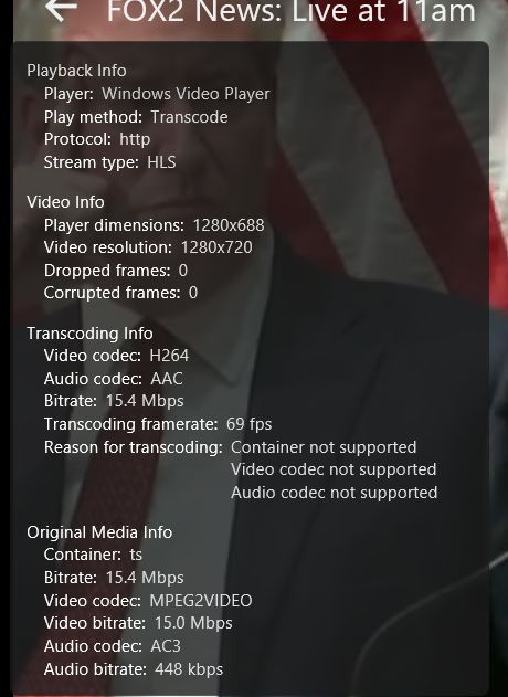

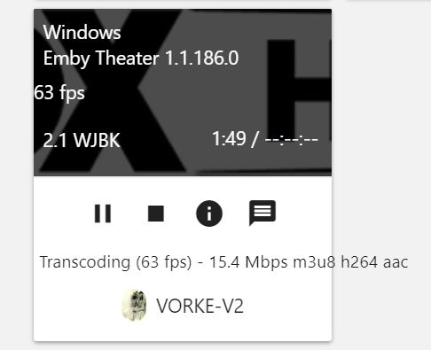

clarkss12 304 Posted December 29, 2017 Posted December 29, 2017 (edited) I noticed yesterday that my Live TV streams are transcoding, and they did not used to do that. Running Server on Vorke V2 (Windows 10) and client on same device. Server log.txt Transcoding Log.txt Edit: Disregard. Rebooted my router and now it is Direct Playing....... Really strange. I keep forgetting that rebooting my router solves my problems.. Edited December 29, 2017 by clarkss12

clarkss12 304 Posted December 29, 2017 Author Posted December 29, 2017 Back to transcoding the Live TV stream. First router reboot, solved the problem. After updating the firmware for Widows (another story), back to transcoding again. Rebooted the router again, but did not help this time. Running the client and server on the same Vorke V2 (Windows 10), getting the transcoding. Using a different Android client, and same sever, I get direct streaming........ Not sure if it is my networked system, but a few days ago, all my clients AND servers played my Live TV streams with Direct Playing. ffmpeg remux.txt Server Log.txt Transcode.txt

Jdiesel 1437 Posted December 29, 2017 Posted December 29, 2017 Is your quality set to auto perhaps? Slow network speeds might be causing the transcode.

clarkss12 304 Posted December 29, 2017 Author Posted December 29, 2017 Is your quality set to auto perhaps? Slow network speeds might be causing the transcode. Yes, I leave my devices set to auto.
