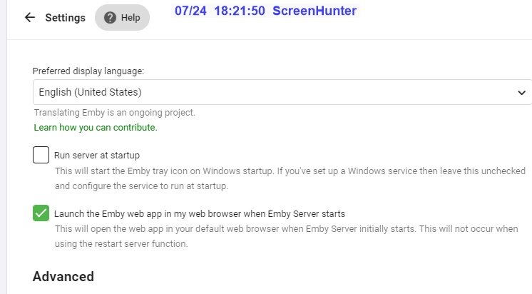

EricE 2 Posted December 29, 2017 Author Posted December 29, 2017 Yes, I think it was possible I had two servers running. I had installed the windows service version and somehow got the checkbox (in settings) checked to run the other too. I think I have it running fine now. Thanks for twigging my memory and pointing me in the right direction. I am afraid to reboot now. hehe. I hope it still runs after I reboot. I'll post back if for some reason I don't have it solved now.
Omphalos 3 Posted July 25, 2021 Posted July 25, 2021 On 12/29/2017 at 4:57 PM, EricE said: Yes, I think it was possible I had two servers running. I had installed the windows service version and somehow got the checkbox (in settings) checked to run the other too. I think I have it running fine now. Thanks for twigging my memory and pointing me in the right direction. I am afraid to reboot now. hehe. I hope it still runs after I reboot. I'll post back if for some reason I don't have it solved now. I've noticed the same issue lately for some reason. Whenever I reboot the system, I end up with two instances of Emby Server running and I get the same error you mentioned on library scans. How did you set it to allow the service to continue to run at startup but stop the other instance from starting?
Omphalos 3 Posted July 25, 2021 Posted July 25, 2021 (edited) 14 hours ago, Omphalos said: I've noticed the same issue lately for some reason. Whenever I reboot the system, I end up with two instances of Emby Server running and I get the same error you mentioned on library scans. How did you set it to allow the service to continue to run at startup but stop the other instance from starting? Never mind, found it in settings - literally the very first check box in the setup menu. LOL. I unchecked this box, rebooted my system, and the issue is resolved - no more dual instances running, and no more library scan errors. Edited July 25, 2021 by Omphalos 1
