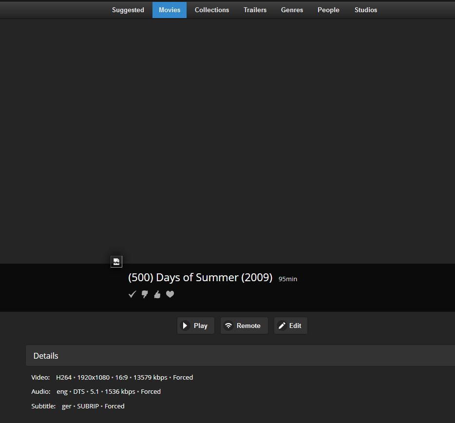

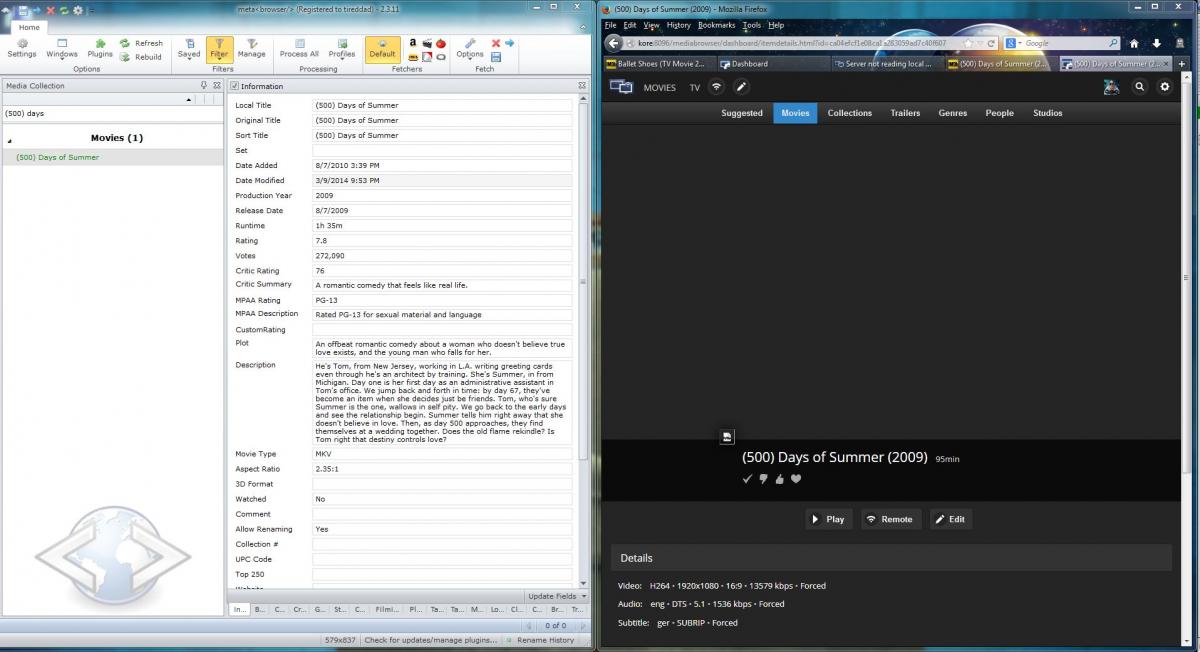

tired dad 28 Posted March 10, 2014 Author Posted March 10, 2014 (edited) Probably going to need some concrete examples, with sample xml files, screenshots of the editor, screenshots of the file system, steps to reproduce the problem, etc. Sure thing, here you go: File called "sidebyside" is the screengrab showing both meta<browser/> with the data and MB Server without. File "two" shows the metadata after pressing refresh and the option to refresh all metadata is selected, while "three" shows that the movie.xml file does indeed exist. The movie.xml file is attached for your review. Step taken: max_anger=10 For x =1 to "max_anger" Press "refresh" next x (sorry, a little basic humour...) Anyway, pressing refresh had no effect. I tried refreshing the library a few times (that's when movies started disappearing and re-appearing,at one point 50% were missing) as well as starting the servers as both a Windows service and just as the program. No effect. I deleted the XML file so that meta<browser/> would re-do it, which it did, but the server still doesn't see the data. The refresh option via the client machine does nothing either. This is on the latest build of both client and server. I tried a second example with a brand new file and folder where once again, I used meta<browser/> to find the data first to make sure the xml file existed. I then went to the media library, where I saw what you see in "ballet1"; after pressing "edit", I got to the standards screen and then pressed "refresh", but nothing happened. Both files are on the same server, but different drives. For fun, I rescanned the library (again losing half the movies in the database, but no error messages), and the second movie showed up (file "four"), but the first did not (file "five"). Most of the missing data is from movies on the second server. I used to have the first server run MB as a service, which used to work fine until one of the later server builds and then I started getting "access to path denied" errors, so I switched to the application loading at startup as per one of the suggestions. Seems odd that this has started to happen. movie.zip Edited March 11, 2014 by tired dad
