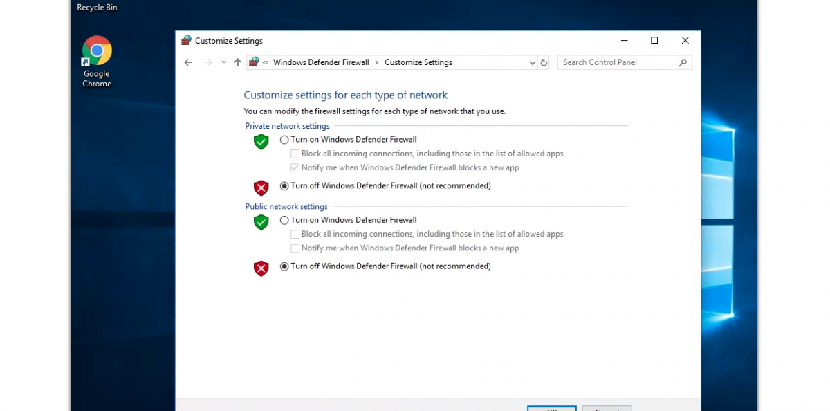

gijoeyl35 0 Posted December 24, 2017 Author Posted December 24, 2017 I also have turned off the Windows Defender Firewall on the server machine....still nothing!!!
Tur0k 148 Posted December 24, 2017 Posted December 24, 2017 (edited) Ok, confirm that windows firewall is completely off for all network zones. What do you use for anti-virus? Does it include a software firewall as well? Looks like you are on time warner. I don't think they are explicitly blocking 8096 though web searching indicates they may block email server transmission ports in residential networks. The zoom 5354 is a modem/home router and should support port forwarding. Can you take screenshots? Also, do you have any other network equipment between the zoom modem/router and your Emby server? Sent from my iPhone using Tapatalk Edited December 24, 2017 by Tur0k

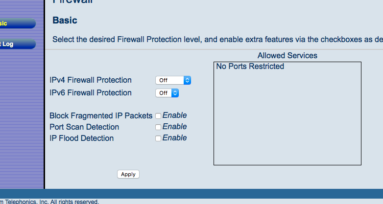

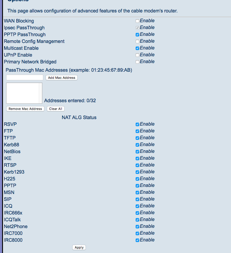

gijoeyl35 0 Posted December 24, 2017 Author Posted December 24, 2017 Here are some relevant screen shots. I do have a Ubiquiti Wifi access point in the house. But the computer with the emby server software is hooked up with a wire directly to the zoom modem. What else should I be looking at?
xilex 9 Posted December 24, 2017 Posted December 24, 2017 Try removing the external IP address. I've never had to configure that in any prior router when doing basic port forwarding. (see http://www.tomshardware.com/answers/id-2889389/external-port-forwarding-page.html) Also, you can enable UPnP on last page and not have to worry about setting up port forwarding yourself. Then reenable Windows Firewall and router firewalls once you see everything is working. 1
tdiguy 99 Posted December 27, 2017 Posted December 27, 2017 (edited) I need to some help making sure my settings are correct. I have a 5354 model zoom router and cannot access emby remotely. This is what I currently have in the port forwarding section. What I am doing wrong? Local IP: 192.168.10.20 (IP of the computer with the server installed) Local Start Port: 8096 Local End Port: 8096 External IP address: 71.71.200.125 (Address shown as remote address inside emby) External start port: 8096 External end port: 8096 Protocol: Both Enabled: On Help! Interesting router, I notice there is a NAT ALG on it. I dont know if emby would trigger any of them for protection but for testing purposes i would disable all of them. Are there any other routers or anything acting like a router in your network between the emby server and your ISP? For example I have a ooma phone which acts like a router so its server ---> buffalo router --> ooma router / voip --->isp. I had to log into the ooma device to see the correct external IP address to use. Edited December 27, 2017 by tdiguy
