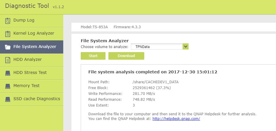

PenkethBoy 2068 Posted December 30, 2017 Posted December 30, 2017 I'm curious why yours would be so slow - your Xeon and memory are very similar to my 2012r2 server with 4790s i7 in passmark scores so horsepower is very unlikely to be the cause. Did you run that scrub? do you have a static/thick/thin volume? mines Static as that gives the best performance although its not a night and day improvement
PenkethBoy 2068 Posted December 30, 2017 Posted December 30, 2017 FWIW - these are my disk speeds using the QNAP diagnostic tool
joelang6126 10 Posted December 30, 2017 Author Posted December 30, 2017 Yeah I did run the scrub at set it for weekly. No improvement. I can't remember how it's provisioned I'll check when I get back home. Almost sure it's thick.
