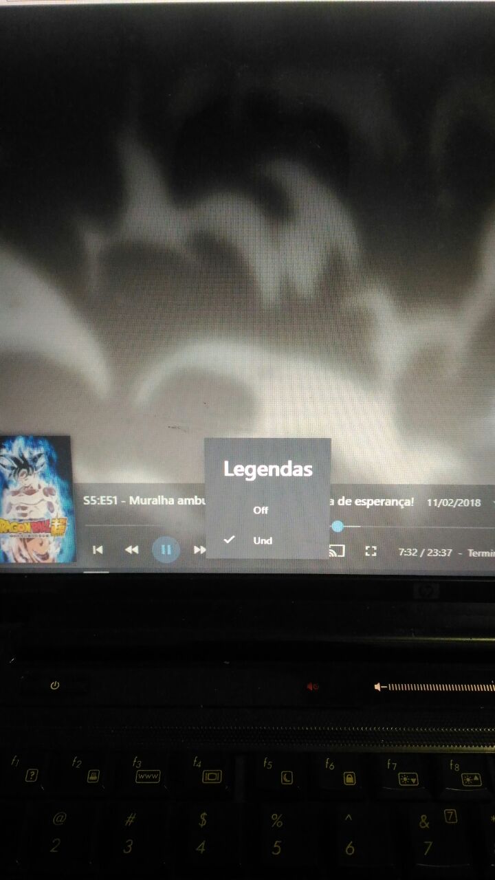

Luke 42221 Posted December 6, 2017 Posted December 6, 2017 did you activate the subtitles using the video player menu?
Gaspar Filmes 8 Posted January 16, 2018 Author Posted January 16, 2018 did you activate the subtitles using the video player menu? Yes, but it didnt load anyways.

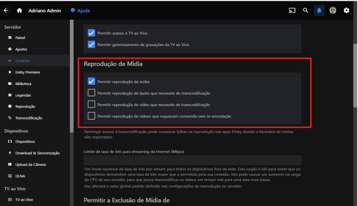

Wash 1 Posted April 5, 2018 Posted April 5, 2018 I also have this problem, the thing i point is: when I enable transcoding (4 marked option) the subtitle loads but, transcoding and my hardware ir poor, i got 2 blue screens after 1 transcoding.. so i'm very interested in a solution for that, 'cause dont, i'll have to convert every single file to embed the subtitle on them,,, that will cause a lot of frustation on my library (40 anime series at 1080p). 1

Gaspar Filmes 8 Posted April 5, 2018 Author Posted April 5, 2018 I also have this problem, the thing i point is: when I enable transcoding (4 marked option) the subtitle loads but, transcoding and my hardware ir poor, i got 2 blue screens after 1 transcoding.. so i'm very interested in a solution for that, 'cause dont, i'll have to convert every single file to embed the subtitle on them,,, that will cause a lot of frustation on my library (40 anime series at 1080p). that was exacly my point, I teste marked this 4 options and the sub loads, but i dont want to transcode, we'll have to convert all the files to embed the subs?????? this is crazy

Guest Posted April 5, 2018 Posted April 5, 2018 Returning to the subject, I've also been able to display captions with transcoding, but that's not what we want to have, as this drops the emby server.  It really is very important that Emby can re-display the subtitles of STRM files without having to mark the 4 options on transcoding.  The idea of ​​embedding subtitles in files is impractical. I look forward to the solution.
