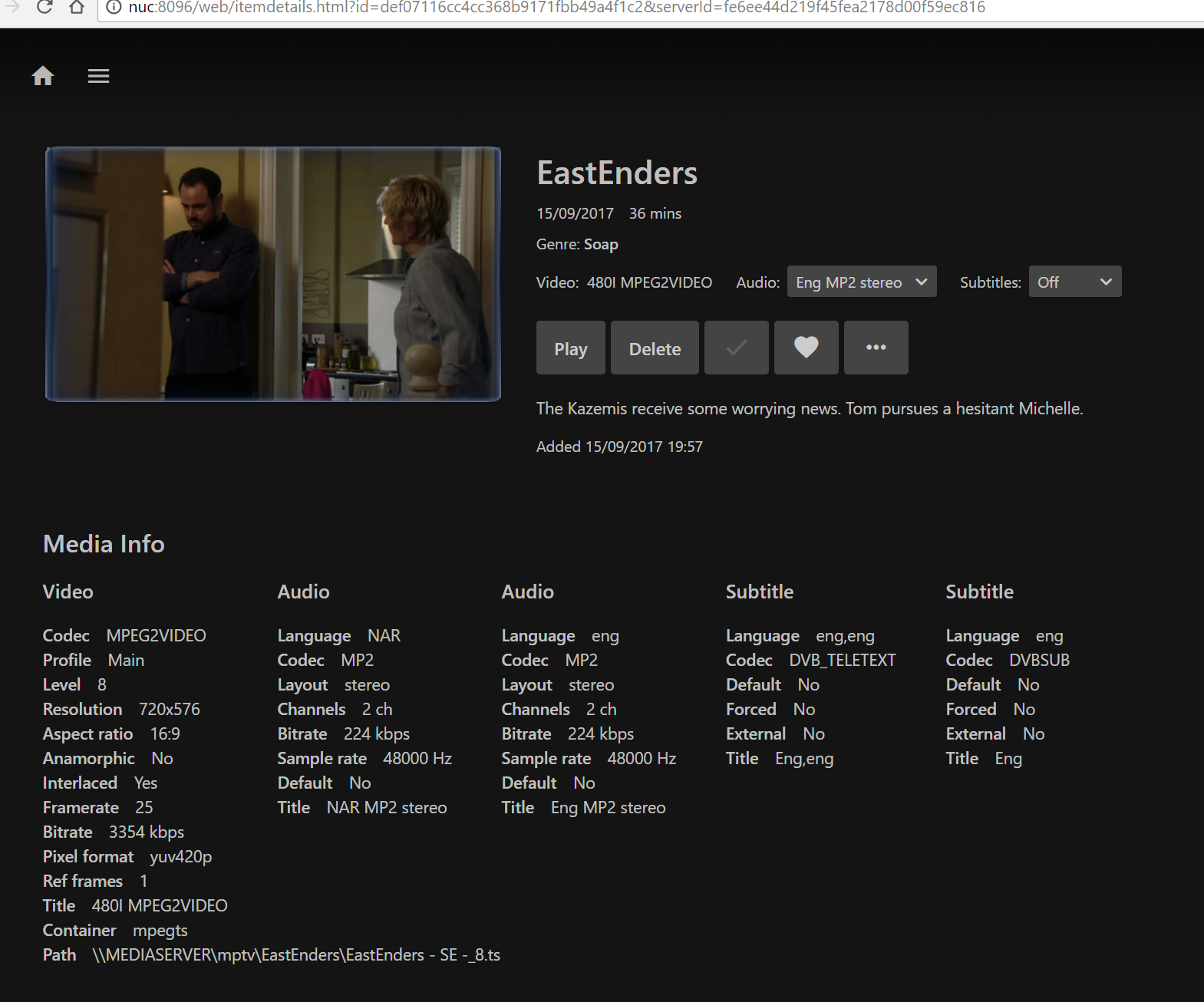

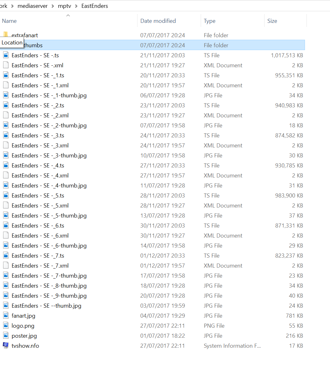

Spaceboy 2573 Posted December 2, 2017 Author Posted December 2, 2017 Actually its even better than that, the media items its reporting dont actually exist anymore, they were series recordings and have been deleted several months ago. example: note the path vs the path in the browser. but then below: the file isnt even there!!!
