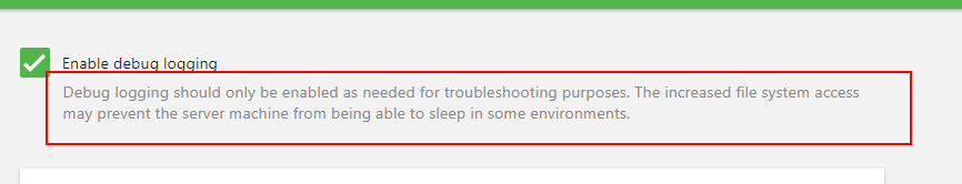

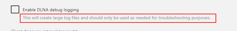

Happy2Play 9802 Posted November 28, 2017 Posted November 28, 2017 (edited) Also unless something has changed you will have to restart your server after enabling and disabling these options. Edited November 28, 2017 by Happy2Play
