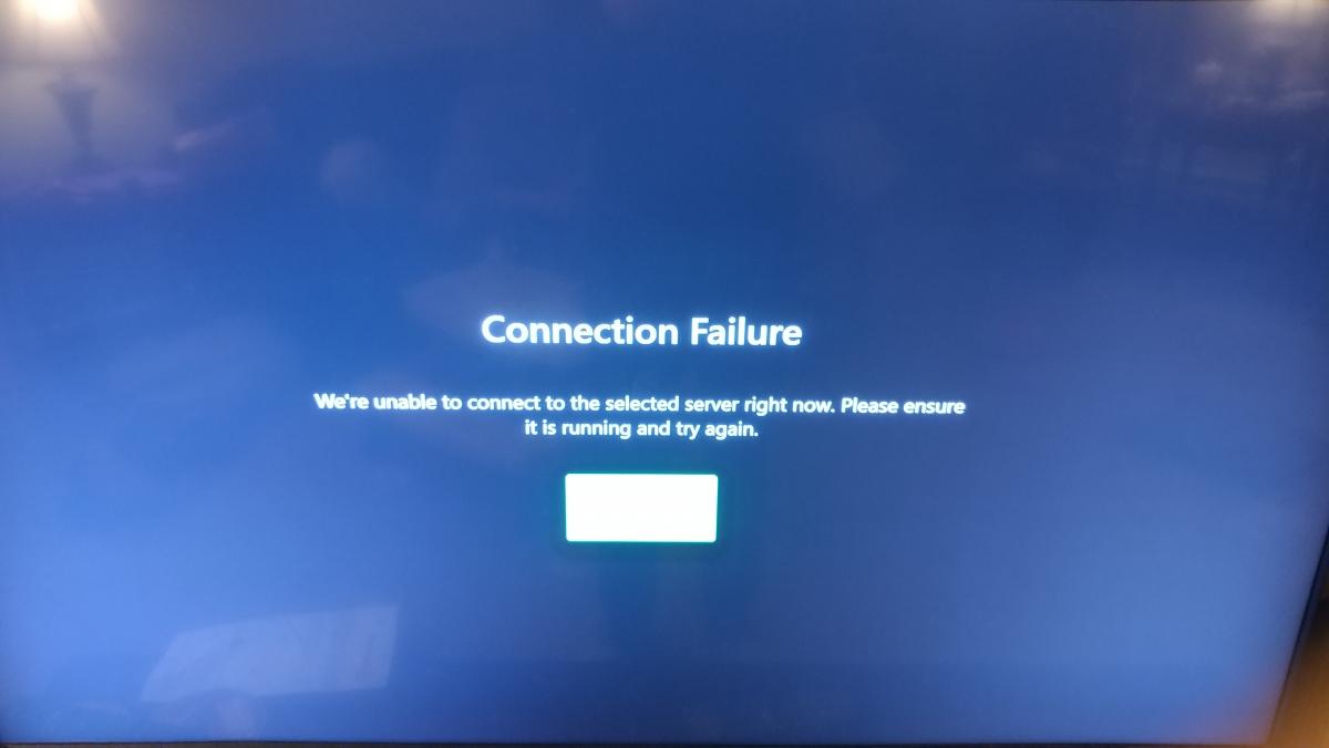

dieharddan 0 Posted November 23, 2017 Author Posted November 23, 2017 The first screen which asks to choose a server, manual connection or emby connect, after choosing it says something along the lines of unable to connect check if the server is running, which it is
dieharddan 0 Posted November 23, 2017 Author Posted November 23, 2017 Here is the first screen that pops up when i start emby theater.. i select my server and get the error; adding the server manualy doesnt work either
Luke 42243 Posted November 24, 2017 Posted November 24, 2017 Try clicking the add server button and then enter the server ip address. see if that allows you to connect. thanks.
dieharddan 0 Posted November 24, 2017 Author Posted November 24, 2017 (edited) Ive tried that and It still won't connect Edited November 24, 2017 by dieharddan
Luke 42243 Posted November 24, 2017 Posted November 24, 2017 Are you sure the server is started and running? What ip address are you entering? Are you sure the ip address is correct?
dieharddan 0 Posted November 24, 2017 Author Posted November 24, 2017 Yeah, its running and im quite certain i got the correct ip and port. All I have to do is enable tethering on my phone to give the pc internet access and emby theater will connect immediately

dieharddan 0 Posted November 24, 2017 Author Posted November 24, 2017 (edited) It's the ip emby server lists in the settings Edited November 24, 2017 by dieharddan
Luke 42243 Posted November 24, 2017 Posted November 24, 2017 You're trying to use your external ip address and that will require an internet connection because that address is your internet address. Â You need to use your internal LAN ip address, which is normally displayed on the server dashboard but looks like in your case emby server wasn't able to detect it. do you know your internal LAN address?
dieharddan 0 Posted November 24, 2017 Author Posted November 24, 2017 I dont have it connected to a private network, so im not sure what address you're looking for;an ipconfig /all turns up nothing
Luke 42243 Posted November 24, 2017 Posted November 24, 2017 is emby server on the same machine as emby theater?
