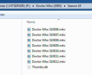

Marc_G 95 Posted November 22, 2017 Author Posted November 22, 2017 Probably because you left metadata inside the folder and that metadata was picked up. Is that correct? Nope, I removed all the metadata (the old folder called Metadata, and all the jpgs and nfo files and such, before renaming). Here's what it looks like:

Marc_G 95 Posted November 23, 2017 Author Posted November 23, 2017 Hi everyone, After experimenting a bit, I believe the problem was user error in part, or at least user ignorance. Plenty of that going on with me. :-) When I deleted the metadata in the \Season 10\ folder, I didn't delete the .nfo file in the parent \Doctor Who (2005)\ folder, and that appears to have been necessary. I thought that deleting the .nfos for each episode, along with the thumbnails, would be sufficient. It's not, apparently. Oops. As for the "Metadata folder" issue, I'll start another thread dedicated to that, if I don't figure it out. Thanks to everyone for their help in this thread.

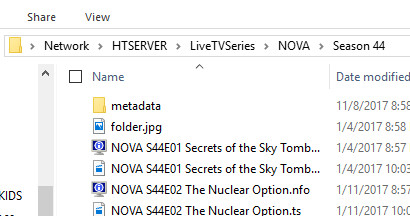

Marc_G 95 Posted November 23, 2017 Author Posted November 23, 2017 (edited) EMBY doesn't put metadata into a subfolder named metadata fyi eg. TV Show\Season 01\metadata\ It only places the metadata in the same folder as the media files themselves. Respectfully, in my experience it does, though i'm not sure if it is Emby itself or the CoverArt plugin. Any TV series library I have, the individual season folders contain a Metadata folder, which contains .jpgs of each episode. Here is an example: At some point after my server reinstallation, it started putting the jpgs directly into the season folder instead of the metadata subfolder. Not sure why. Edited November 23, 2017 by Marc_G
ebr 16310 Posted November 24, 2017 Posted November 24, 2017 We eliminated the metadata folder a couple of years ago I believe. 1
CBers 7542 Posted November 24, 2017 Posted November 24, 2017 We eliminated the metadata folder a couple of years ago I believe. I found a load in my TV and Movies library yesterday. I deleted them and then rescanned my library and they weren't recreated. 1
Marc_G 95 Posted November 24, 2017 Author Posted November 24, 2017 That saddens me. I preferred having stuff in the metadata folders for tidiness. But, at least I know that there's no settings I need to tweak to get them back. My server was rebuilt (hardware wise) a year ago and I migrated content (with no metadata) at that time. Metadata subfolders were created then and have been updated as I add new content episodes to those series all year. But no longer I suppose. [emoji31]
