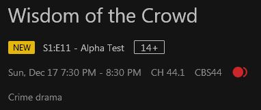

dranderson402 31 Posted December 12, 2017 Author Posted December 12, 2017 Was that info in the guide data to begin with? The nfos are saved with all available guide data. When you refresh manually that's when it uses the internet metadata and that's why you might get additional information. But by default, we save with just the original guide data that we had available. I use Schedules Direct and I'm not sure what info is included with the guide data. Here is a screen shot of what I see for the next upcoming recording of the same show in my example. I can also say that I used schedules direct with mythtv prior to emby and the aired date was there but I'm not sure if mythtv got it from the guide or did an internet lookup. So from what I gather you are saying, recordings do not lookup metadata from the internet, it just uses what it sees in the guide data. I assumed emby was looking up the metadata from the internet because I would see this in the log file when the recording starts. 2017-12-10 19:00:01.026 Info LibraryMonitor: Season 1 (\\192.168.10.51\Multimedia\Recordings\Series\Wisdom of the Crowd\Season 1) will be refreshed. Then I would see the following at the end of the recording leaving me to believe there was an error getting the metadata. 2017-12-10 21:00:04.030 Error HttpServer: Error in HttpListenerResponseWrapper: An existing connection was forcibly closed by the remote host *** Error Report *** Version: 3.2.50.0 Command line: C:\Users\Dave\AppData\Roaming\Emby-Server\system\EmbyServer.dll Operating system: Microsoft Windows NT 6.2.9200.0 64-Bit OS: True 64-Bit Process: True User Interactive: True Processor count: 8 Program data path: C:\Users\Dave\AppData\Roaming\Emby-Server Application directory: C:\Users\Dave\AppData\Roaming\Emby-Server\system System.Net.Sockets.SocketException (0x80004005): An existing connection was forcibly closed by the remote host at SocketHttpListener.SocketStream.Write(Byte[] buffer, Int32 offset, Int32 count) at SocketHttpListener.Net.HttpResponseStream.DisposeCore() at SocketHttpListener.Net.HttpResponseStream.Dispose(Boolean disposing) at System.IO.Stream.Close() at Emby.Server.Implementations.HttpServer.SocketSharp.WebSocketSharpResponse.CloseOutputStream(HttpListenerResponse response) System.Net.Sockets.SocketException at SocketHttpListener.SocketStream.Write(Byte[] buffer, Int32 offset, Int32 count) at SocketHttpListener.Net.HttpResponseStream.DisposeCore() at SocketHttpListener.Net.HttpResponseStream.Dispose(Boolean disposing) at System.IO.Stream.Close() at Emby.Server.Implementations.HttpServer.SocketSharp.WebSocketSharpResponse.CloseOutputStream(HttpListenerResponse response)
Luke 42204 Posted December 12, 2017 Posted December 12, 2017 No that entry in the log is not related. I guess what we can do is if we don't have original air date in the guide data, then we can use today's date if the episode is marked as new. thanks.
