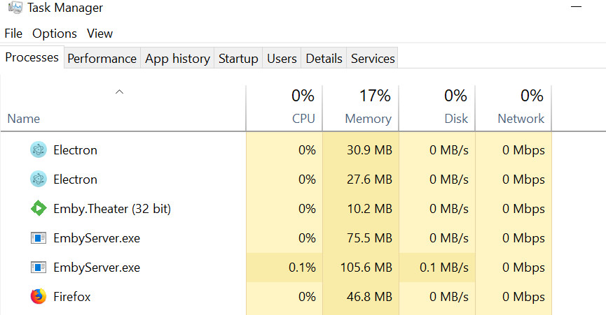

Marc_G 95 Posted November 18, 2017 Author Posted November 18, 2017 Check these out. Is this normal? I don't recall seeing the double entries before. Please advise
Luke 42203 Posted November 18, 2017 Posted November 18, 2017 No that's not normal. Looks like maybe you have embyserver.exe in two different places? try to find the full path to those.
Marc_G 95 Posted November 18, 2017 Author Posted November 18, 2017 (edited) They are the same file, in c:\users\<username>\appdata\roaming\Emby-Server\System\ I'm pretty sure this relates to having an entry for windows to auto start the service, then me following the newer instructions using the NSSM tool. So, two entries to run the service. The old one always listed the process as Emby. I followed the instructions and called new one via NSSM Emby Server. So, in services, one shows up as Emby, and one as Emby Server. How do I undo the old windows service settings that I had prior to reinstallation? (corrected typo in path) Edited November 18, 2017 by Marc_G
