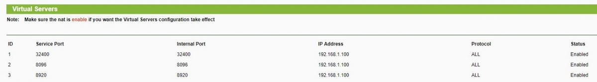

RogerO 5 Posted November 16, 2017 Posted November 16, 2017 I've been running Emby for just a day or two. I've loaded all my media and was gradually fixing the missing metadata, and everything's been looking great. I was accessing from a PC on the LAN and from my phone over wireless and 4G, and a family member could access it externally as a test. Then a few hours ago, everything suddenly stopped working. I was in the throes of metadata editing at the time, so I can't think of anything I was doing at the time that could have caused the problem. Now, I can't even start the server on my QNAP NAS, just getting the error "This site can't be reached" if I try via 192.168.1.100:8096, or "We're unable to connect to the selected server right now...", if I try to connect via app.emby.media. I get the same errors if I try to connect via either Chrome or the Emby app on my phone (on the same network via via wifi). Some facts and observations: my clients are a Windows 10 PC via app.emby.media (and I'm pretty sure I also connected directly via 192.168.1.100:8096), and an Android Galaxy S8 phone via the Emby app my server is a a QNAP TVS-871, running the latest version of Emby downloaded 1-2 days ago. It has a statically assigned IP address and has been that way forever I have unblocked ports 8096 and 8920 on my router in exactly the same way that I have unblocked port 32400 for Plex. However, if I test with canyouseeme.org it says it could not see 8096/8920, even though it can see 32400 (and Plex still works fine, either locally or remotely). I've attached a screenshop of that config page. There's gotta be a clue there! But I'm not sure what else to try. (I have put a call into my ISP to see if they block 8096 and/or 8920, and am waiting for a reply. But since this problem also occurs on my LAN, I guess that's not the problem) I don't recall setting the "Bind to local network address" field in "server dashboard - advanced", and I can't do that now because I can't connect to Emby at all I tried turning off the Windows firewall on my client PC, which makes no difference I tried turning off the SPI firewall on my TP-LINK AC1750 router, which made no difference I have tried putting the server 192.168.1.100 in the DMZ, which made no difference I tried turning off-then-on my PC, NAS, router and modem all at the same time, and for maybe 15-30 seconds everything worked! But then it just stopped again, with the same errors described above I then tried turning off each item one by one, but no single off/on process made any difference. I should probably try turning everything off/on at the same time again, but even if it worked for another 15-30 seconds, I'm not sure what that would tell me about the problem I'm worried that I'm missing something terribly simple. Do you have any ideas what's going on, or what I might try next?
