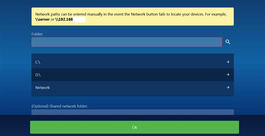

d00zah 152 Posted November 16, 2017 Posted November 16, 2017 Win 7 (x64), Server v3.2.36.0 Unsure when this happened, but I was doing some testing which required adding a new folder to an existing library. For years, I've been able to add a network folder: by clicking on Network, which would traditionally expand to available network host content. Now, it just adds 'Network' as the path without expanding/displaying network content clearly visible when browsing with Windows Explorer: Copying/pasting path from Explorer address bar to Emby management UI works, so it's still functional, but I used to be able to browse directly to my target folder within the UI. This happens in both FF 56.0.2 & IE (whatever), so it doesn't seem to be a browser issue.

Luke 42213 Posted December 11, 2017 Posted December 11, 2017 You should be able to type in the path though, thanks. 1
Solution Luke 42213 Posted December 11, 2017 Solution Posted December 11, 2017 The network browsing will be restored for the next release, thanks. 3
d00zah 152 Posted December 22, 2017 Author Posted December 22, 2017 Confirmed fixed in server v3.2.60.0. Thank you!

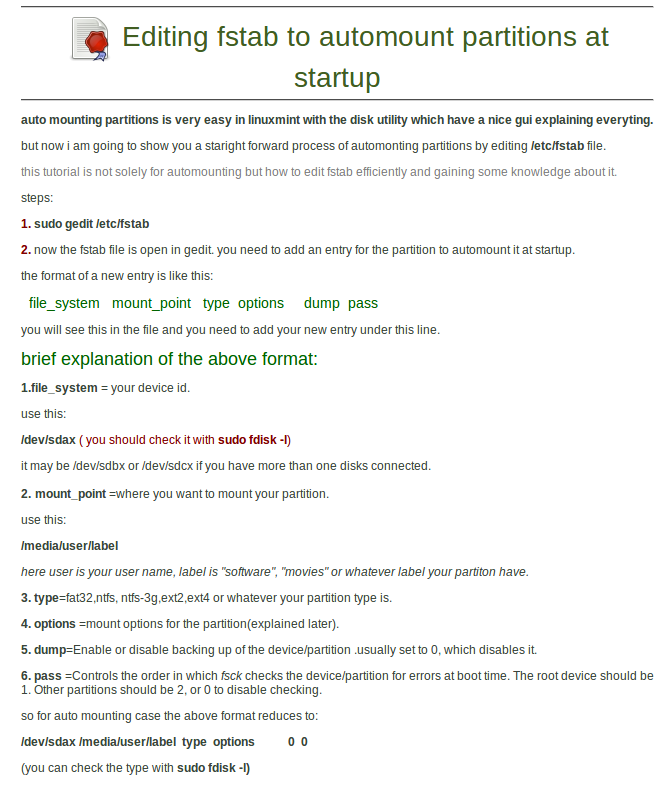

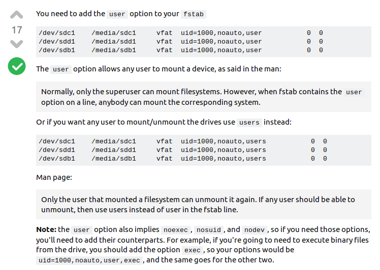

xbmcgotham 35 Posted January 3, 2018 Posted January 3, 2018 Hi, it worked. :-) Luckely I had some experience with configuration of cumputers, however normal users would not be able to get it done I guess. Dont know why linux (Ubuntu) is still not more configuration friendly after so many years. Just to help out, I have written down the steps I took below and the errors I received. Feel free to move this to another threat. *************************************** 1. First edit fstab. used the following information to open fstab for editing. It also shows some extra info on config options (https://community.linuxmint.com/tutorial/view/1513) 2. Add the correct mounting line to the fstab. I used the following information as basis for config of my NAS drive. (https://unix.stackexchange.com/questions/178187/how-to-edit-etc-fstab-properly-for-network-drive) //192.168.0.67/test /home/pi/test cifs username=myname,password=123,iocharset=utf8,sec=ntlm 0 0 3. I saved the fstab file and rebooted PC. 4. When opening the "Files" browser the NAS drive was not mounted and I got an error saying: Only root can mount ... 5. I found out that I needed to add an extra option to the fstab entry I added in step 2. (https://askubuntu.com/questions/336387/only-root-can-mount-dev-sdb1-on-media-sdb1-contribute-to-external-usb-drive/336764) So I added "user" to the line: //192.168.0.67/test /home/pi/test cifs user,username=myname,password=123,iocharset=utf8,sec=ntlm 0 0 6. I rebooted PC and got the following error: mount: wrong fs type, bad option, bad superblock ... 7. I found the following information that solved the problem. (https://askubuntu.com/questions/525243/why-do-i-get-wrong-fs-type-bad-option-bad-superblock-error) So in my case, as I used "cifs" I installed cifs-utils by adding the line "sudo apt install cifs-utils" in terminal. and after install I rebooted and the NAS drive was correctly mouted and accessible in Emby library browser. :-)
djhifi 56 Posted October 15, 2018 Posted October 15, 2018 I'm just digging this one up to ask something. I've been testing browsing the "manage library" section of the server to outside my NAS paths. I have the same problem as the OP clicking "Network" does nothing. But if I manually type \\192.168.2.69 (one of my windows pc IP adresses) I can see the shares. Was this issue never fixed? And also, why isn't the server accepting the name of the PC as a smb path but rather only the IP? I'm planning on adding a second Synology to my library so I was just testing this.
