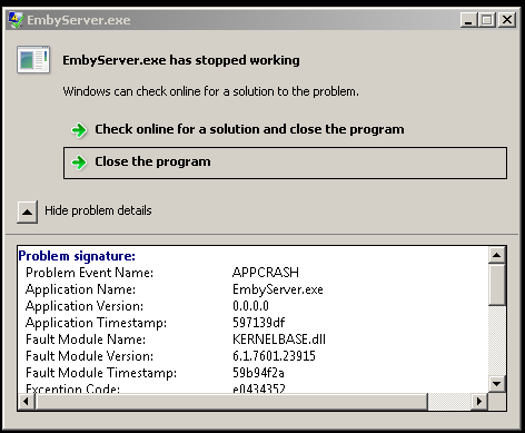

rms8 14 Posted November 15, 2017 Posted November 15, 2017 Emby Server is running on a Win7 PC. I have another Win7 PC that I use in the home theater which runs Emby for WMC. I appears that Emby Server keeps crashing. I "think" it might be crashing when the WMC PC connects to the Server. I start WMC and sometimes the cover art will display for the first folder but when I move to the next, there is never any cover art. Or when Emby for WMC starts and there is just no cover art at all. These let me know that Emby server has stopped running. I look at the serve and sure enough the Mediabrowser app is no longer running. If I try to start it it will restart and stay up. Logs attached. I also attached the Windows error message that pops u[p sometimes when trying to restart Emby Server (server.txt) server-63646355100.txt server-63646354952.txt server.txt

rms8 14 Posted November 16, 2017 Author Posted November 16, 2017 (edited) Have you made sure your windows installation is up to date with windows updates? GEEZUS ! When I built the server (and the HTPC as well which runs Emby WMC), SP1 was already on my Windows 7 disc (I streamlined SP1 into it). Then I turn off updates. Apparently one of the updates obviously fixed something that was broke in Win7 that a newer version of Emby needed to work. I took your advice and re-enabled WU. Installed all the fixes and even the security patches. All working again! Although when the server PC restarts I still get this : But at least everything appears top be functioning normally now. THANKS LUKE...You the man....I seriously feel so stupid for not checking something so simple as a windows update........ server.txt Edited November 16, 2017 by rms8
