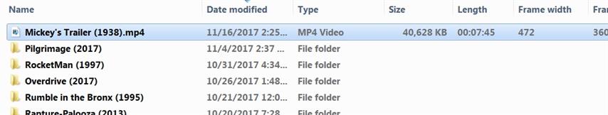

flowlee 1 Posted November 15, 2017 Posted November 15, 2017 (edited) The classic cartoon Mickey's Trailer is not picked up during a library scan. The filename is "MickeysTrailer (1938).mp4" so I guess this has something to do with the word "trailer". The file also does not show up in the metadata manager. Is there some way I can get the scraper to pick up the file or point the metadata manager to the file location? Thank you! Edited November 16, 2017 by flowlee

flowlee 1 Posted November 16, 2017 Author Posted November 16, 2017 (edited) The problem is that the file doesn't even get picked up at all, so there is nothing to identify. The file is not listed in the metadata manager. My guess is that the word "trailer" somehow confuses the scraper and makes it think that this is a trailer for a different movie. The library type is mixed, I'll try movie and report back. Edited November 16, 2017 by flowlee
flowlee 1 Posted November 16, 2017 Author Posted November 16, 2017 Even with library type set to movie the file is not being recognized. The only difference between my naming scheme and d00zah's seems to be the subfolder with the movie's name and I would rather not do that to keep my library consistent. The only way I can figure out how to get around this is to insert a typo in the filename to let the file be scraped and then identify it manually. But that would not be a sensible or clean way to do it at all. Does anyone know of a way to maybe point the scraper towards a specific file?

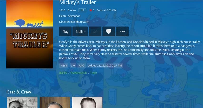

Solution flowlee 1 Posted May 6, 2018 Author Solution Posted May 6, 2018 I'm happy to report that the file is now picked up and displayed correctly in the latest stable version of the server. 1
