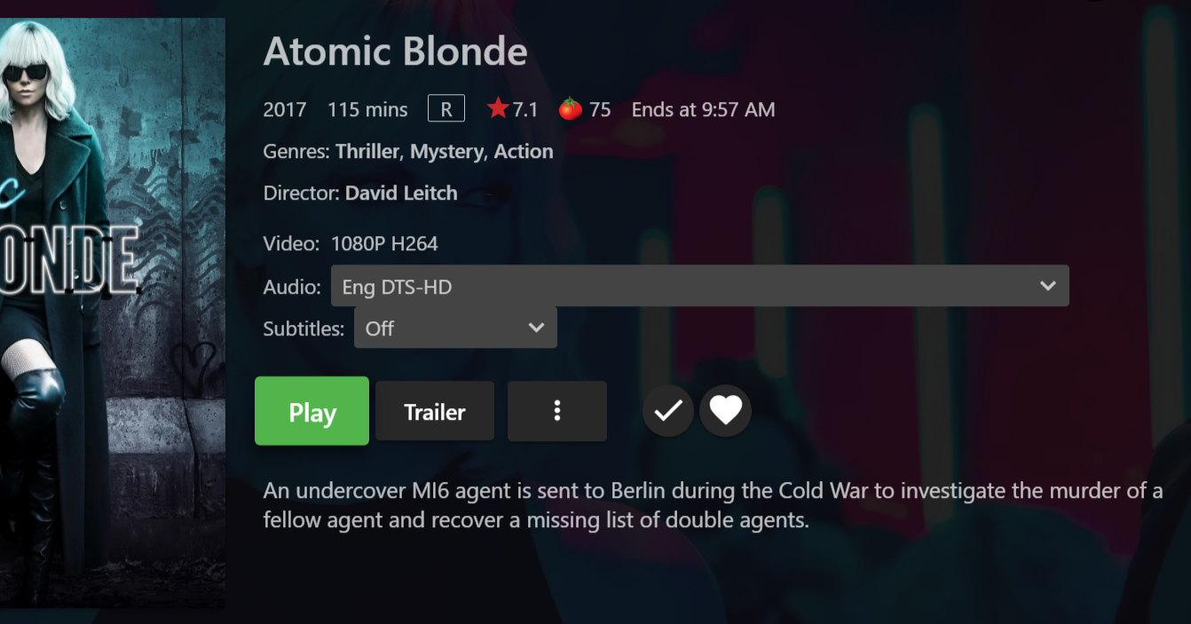

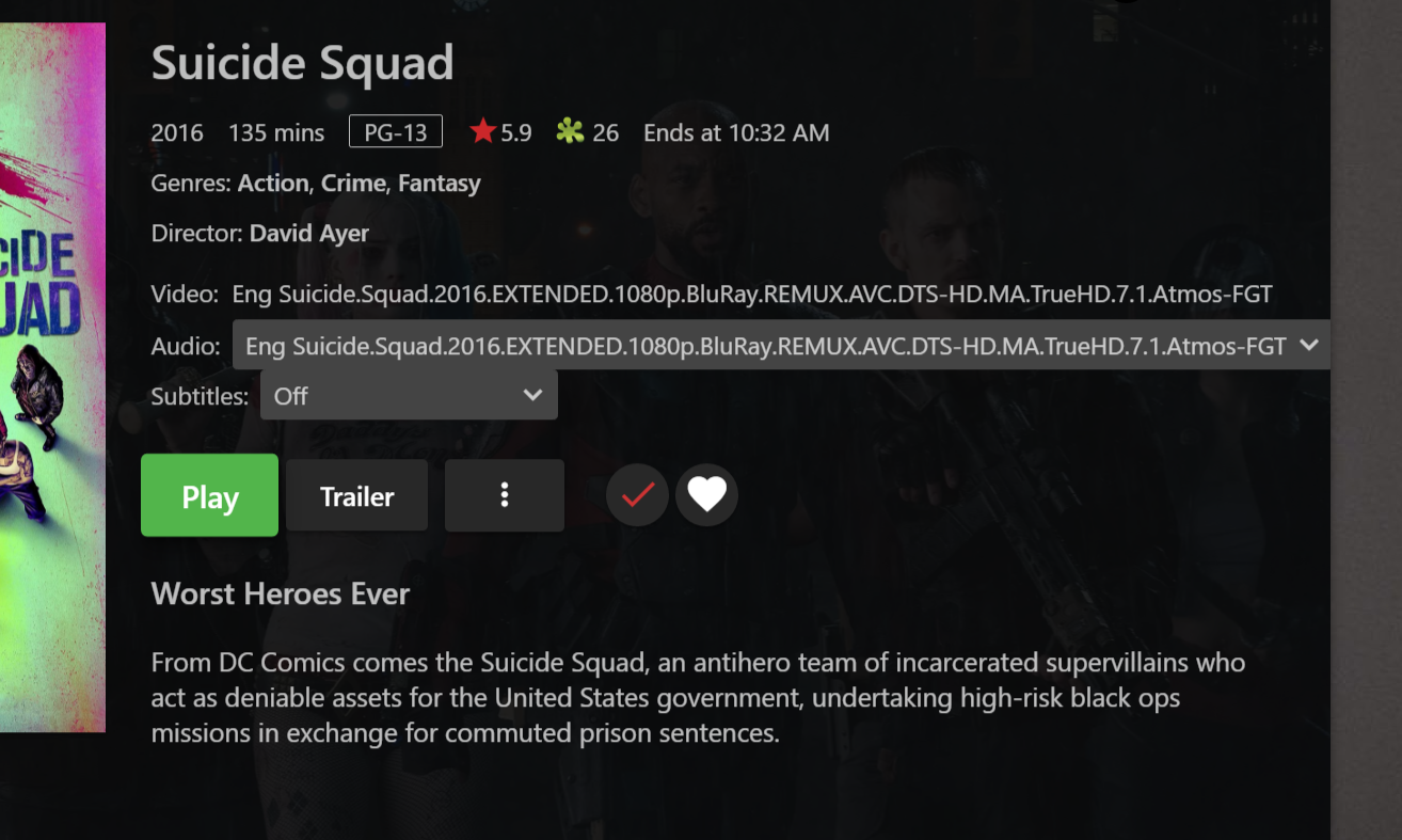

pir8radio 1313 Posted November 12, 2017 Posted November 12, 2017 (edited) So, I like the feature, but don't like how it looks... the audio "dropdown" is too long (dynamic depending on audio tracks), and the audio and subtitle dropdowns are touching each other when forced to the second line.. Maybe if subtitles had its own line rather than being pushed there? Plus these are DROPDOWN's that don't actually drop down, they pop up a selection window... If they are going to remain selection buttons rather than drop downs can we make them set dynamic buttons sized to the current selection and NOT sized based on the not selected longer titles like: "English Commentary with Director David Leitch and Editor Elisabert ROnaldsdottir" What I'm getting at is size the selection buttons based on CURRENTLY selected subtite, or audio track, so there is not a big blank spot. Edited November 12, 2017 by pir8radio
pir8radio 1313 Posted November 12, 2017 Author Posted November 12, 2017 (edited) Also I would rather the interface not display the VIDEO field... I'm going to have to start renaming my movie video and audio tracks now? Eeeek more work I don't want to have to do... I guess my vision is a SINGLE BUTTON that opens up a selection window that lets you pick your video, audio and subtitles on one pop-up screen two or three columns, rather than two fake dropdowns on the media info page, that have dynamic layouts and screw up the flow of the page depending on title info. Also I personally would rather this video title info remain hidden, it can be changed and does not represent the actual video info. But I get why it's there... Edited November 12, 2017 by pir8radio

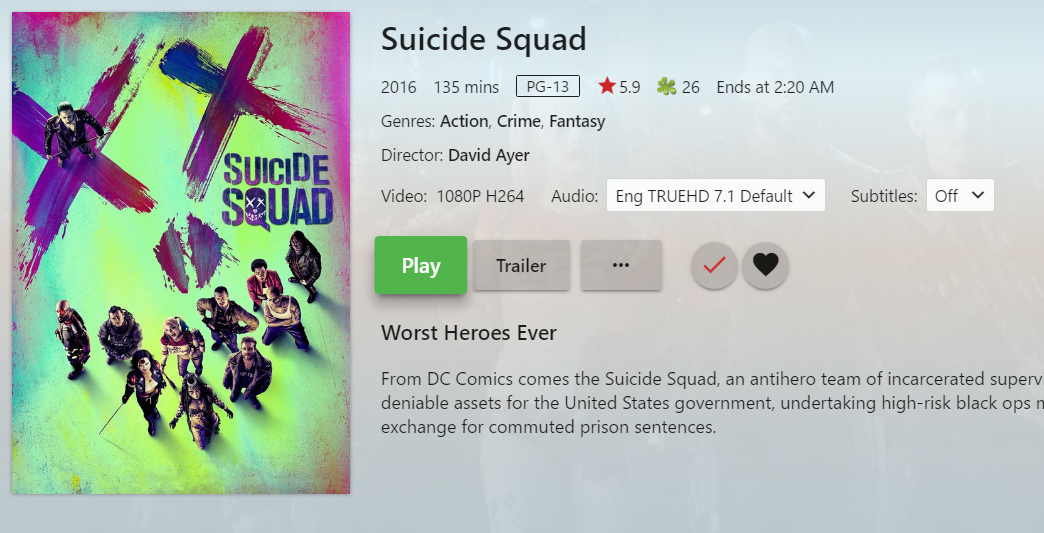

pir8radio 1313 Posted December 8, 2017 Author Posted December 8, 2017 (edited) Thanks, this looks great, and looks the same for every movie! Good work guys! Edited December 8, 2017 by pir8radio

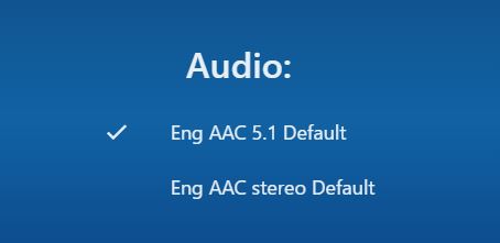

Guest asrequested Posted December 10, 2017 Posted December 10, 2017 In my testing it seems to work fine. can you please discuss an example? see how to report a media playback issue. thanks ! Hopefully this is clear enough
Guest asrequested Posted December 10, 2017 Posted December 10, 2017 Same thing if I play from the beginning
Guest asrequested Posted December 10, 2017 Posted December 10, 2017 I just added a movie. Both audio tracks are default???
Luke 42243 Posted December 10, 2017 Posted December 10, 2017 It is possible to tag multiple tracks as default. That must be what ffprobe told us.
Guest asrequested Posted December 10, 2017 Posted December 10, 2017 It is possible to tag multiple tracks as default. That must be what ffprobe told us. That's why I posted that second picture. Only one track is the default.

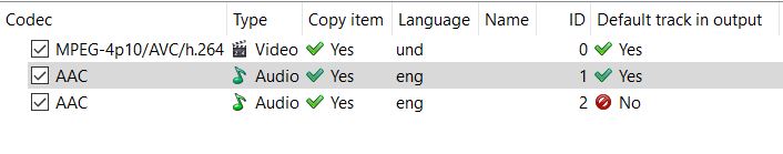

Guest asrequested Posted December 10, 2017 Posted December 10, 2017 But here's something. The file is an MP4, when loaded into mkvtoolnix (see above pic), it shows only one track as default. But if look at the options, it isn't designated as default. This must be an error with MP4 container.
Guest asrequested Posted December 10, 2017 Posted December 10, 2017 I remuxed it, and it's corrected.
