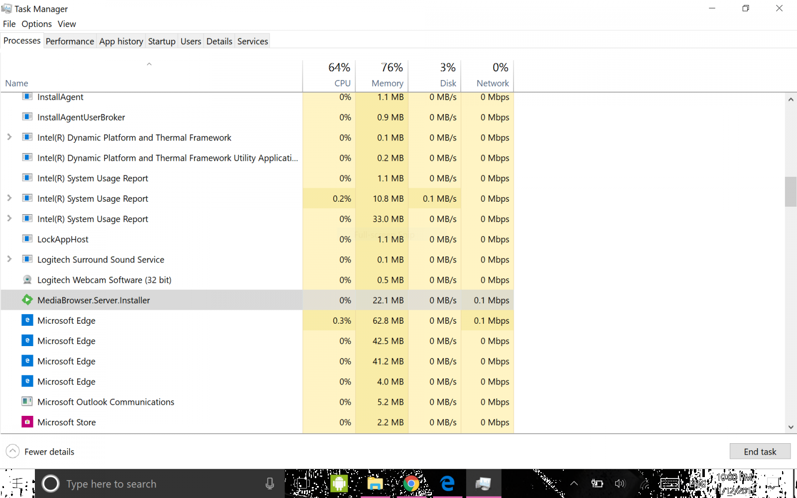

quixotic33 0 Posted November 12, 2017 Author Posted November 12, 2017 Well I did write a post asking why I can't download and install Emby by using the Setup.exe or by downloading the zip files direct from github server. For some reason my post ended up blank??? Anyway how do I install this program the installer hangs for 8 hours whille it attempts to download the server. I have tried 20 times now to download the zip file directly from Github and each time it fails after half an hour and only 8mb downloaded. I think there is something wrong with the github servers...can anyone tell me how to install this program by downloading from an alternate location?

quixotic33 0 Posted November 12, 2017 Author Posted November 12, 2017 There is something wrong with your forum even though I am typing a response it is not posting it. The fie you linked is the first thing I tried. It downloads the installer then that installer starts to download the actual server this is where the installation stops after 8 hours there was no progress. I have tried downloading and intsallling on another machine and have the same problem. The server disconnects me before I can download 10% of the file. Why does the server installer need to download, why not have one installer or a way to install offline? IS there any where I can download the actual server installation files?

quixotic33 0 Posted November 12, 2017 Author Posted November 12, 2017 Yes as you can see I am having issues with this forum. Second attempt now at the same post Here are screen shots showing that nothing is happening with the installer, showing how long it is taking to dowload directly, and how the process stays running after I have cancelled the installation. This is happening on 2 windows 10 computers with the latest updates.

Solution Luke 42204 Posted November 12, 2017 Solution Posted November 12, 2017 That's interesting. It downloads from GitHub. What you can do is try the portable instructions that are on the download page. Thanks. 1

badracoon3 0 Posted November 14, 2017 Posted November 14, 2017 Ok. The x64 portable download finally worked. Had to connect to a VPN and then it would download fully. Attempted installer with VPN but it still hung just saying it was downloading and nothing happened for 10 minutes. Sent from my Nexus 6P using Tapatalk
Luke 42204 Posted November 14, 2017 Posted November 14, 2017 Because the installer has to download a large file. Try the portable instructions.

jsrivard 1 Posted December 27, 2017 Posted December 27, 2017 (edited) Just like to chime in that I am having the same problem as quixotic33. My emby server download stalls, the progress bar does not move. I'm trying to do the manual upgrade from .36 to .60. I can download the portable version but how do I install this on top of a prior version so that settings and everything else is retained. Edit: Finally got it to intall via the standard windows installer. It seems to have been some problem with my 5G wifi band. I switched to the 2.4G band and the install went fine. Very strange. Edited December 28, 2017 by jsrivard
