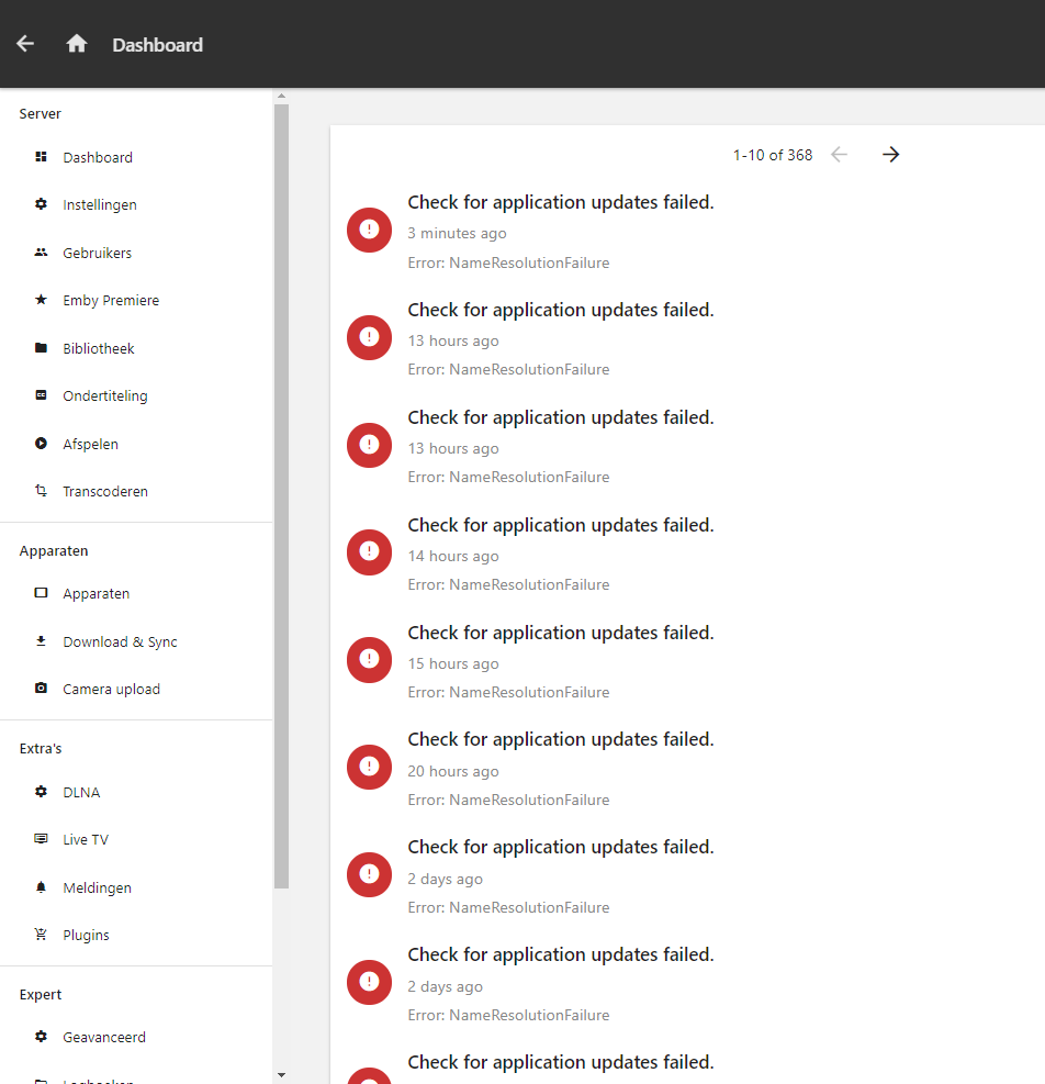

Pirlo1966 22 Posted November 11, 2017 Posted November 11, 2017 Versie 3.2.36.0 It seems emby server no longer wants to update applications, nor download metadata for newly added movies? I did probably something stupid by changing something but I have no idea what. Log.txt
Luke 42241 Posted November 11, 2017 Posted November 11, 2017 Hi, check for application updates means server update. 3.2.36 is the latest version therefore the application is already updated. Does this answer your question?
Pirlo1966 22 Posted November 11, 2017 Author Posted November 11, 2017 No, there is more going on. No new metadata is added and check for is giving errors sine a few days.
Luke 42241 Posted November 11, 2017 Posted November 11, 2017 Does your server machine have an active internet connection? It sounds like it is unable to access the internet.
Pirlo1966 22 Posted November 11, 2017 Author Posted November 11, 2017 (edited) It has, but I changed cable provider two days ago. Should I open or map something special on my cable modem in order to allow emby server to communicate with the open? Solved: something on my server had to be changed.... Edited November 12, 2017 by Pirlo1966

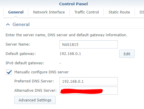

Pirlo1966 22 Posted November 12, 2017 Author Posted November 12, 2017 Thanks, what had to be changed? Until a few days ago all worked by just indicating what my default gateway was. Now I had to check 'manually configure DNS server' and fill in the address of 'Preferred DNS Server'
solabc16 379 Posted November 13, 2017 Posted November 13, 2017 Hello @@Pirlo1966 Thanks for the update. Typically your default gateway will be acting as a DHCP server and providing the DNS configuration along with IP address configuration. Best - James
