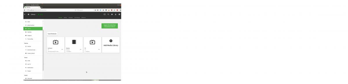

PureCuriosity 0 Posted November 11, 2017 Author Posted November 11, 2017 (edited) Sorry, I thought I had attached the log file, here it is also I attached a picture of what the page looks like EmbyLogFile111017_1908.txt Edited November 11, 2017 by PureCuriosity
Luke 42245 Posted November 11, 2017 Posted November 11, 2017 Do all your libraries appear in emby library setup?
PureCuriosity 0 Posted November 11, 2017 Author Posted November 11, 2017 (edited) Yes, I even added/removed folders to see if anything else appeared. I should also note, when I attempted to rescan the libraries whether as a whole or individually. It wouldn't load to the scan and cut out the scanning(loading) bar very quickly. Again this didn't happen prior to the display issue. Edited November 11, 2017 by PureCuriosity

Luke 42245 Posted November 11, 2017 Posted November 11, 2017 Apparently the scan completed right away. can you show a screenshot of your library setup? have you actually added any folders? thanks.
PureCuriosity 0 Posted November 11, 2017 Author Posted November 11, 2017 (edited) Yes, I have a few directories added. Prior to a few days ago all of them displayed fine. There is approx 6200 videos with a mix of tv shows and movies in all the folders combined. Edited November 11, 2017 by PureCuriosity
