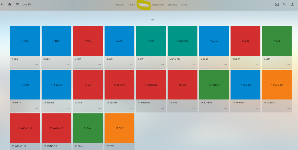

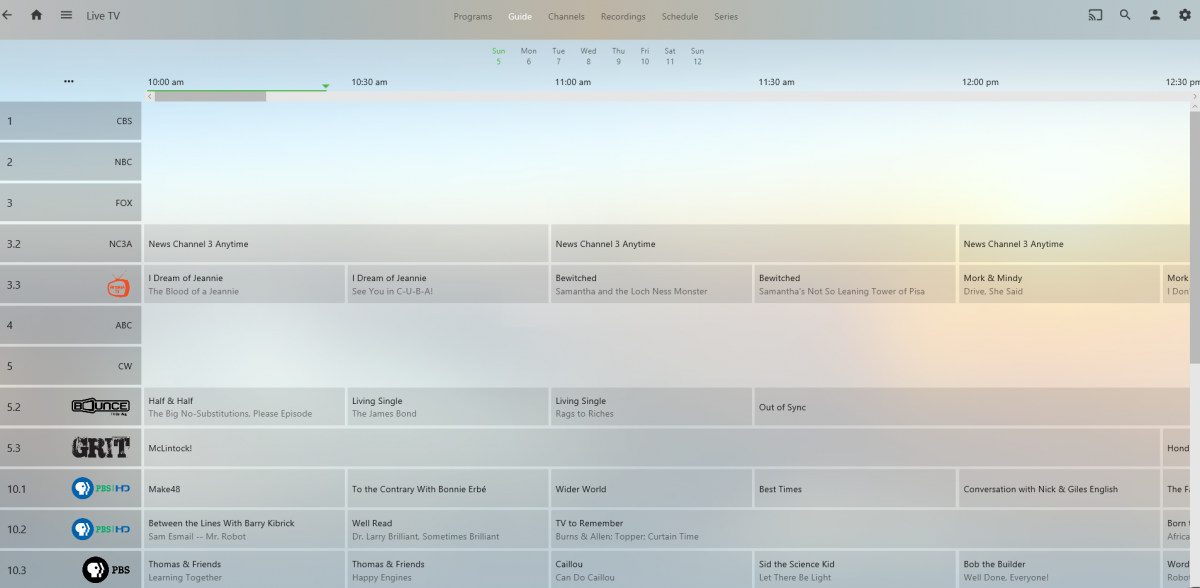

mckenzie78 1 Posted November 5, 2017 Posted November 5, 2017 Hello! I have just started having trouble with my live tv guide. After the Nextpvr plugin quit working for me, I tried adding Nextpvr through the tuner devices. I uninstalled the plugin and was delighted to see that my live tv was working again. However, now the trouble is that ABC, NBC, CBS, CW, and FOX are missing their guide information. I have schedule direct as my guide supplier and I use OTA. The Nextpvr client loads the guide for all channels just fine. I seem to only be having the trouble through Emby. I have seen others post this same issue with their homerun thing (I don't know what that is), but I was unsure if I should post a completely new topic or add to theirs. Thanks, Mckenzie Emby Version 3.2.36.0 Windows 10 Log 1051AM.txt

mckenzie78 1 Posted November 5, 2017 Author Posted November 5, 2017 (edited) At the top of Live tv you have the options of Programs, Guide, Channels, Recordings, Schedule or Series. Channels and Recordings are the only ones showing anything. edit: Upon reading that sentence, it didn't make much sense. Bad grammer. Sorry! Edited November 5, 2017 by mckenzie78

Luke 42203 Posted November 5, 2017 Posted November 5, 2017 It doesn't look like it actually did very much work so i would use the channel mapping feature to make sure the m3u channels are mapped to schedules direct channels. 1
Solution mckenzie78 1 Posted November 5, 2017 Author Solution Posted November 5, 2017 Thank you, Luke, for remaining so patient with me. It was an operater error, as my dad would say. This morning I went in and changed all the numbers so they would show as 1-22 instead of 3.2, 3.4 etc. I guess doing that cleared out the mapping of the channels which is exactly what I found had happened after reading your suggestion I use that feature. I mapped a few of the channels and clicked the refresh guide and it actually did something this time. Went and checked the guide and the few I mapped had guide info. *blush* Thank you again for your help! Mckenzie 1
