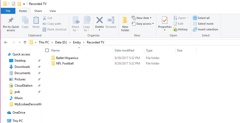

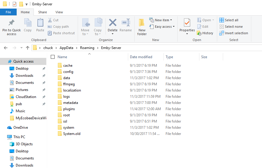

Chuck 17 Posted November 4, 2017 Author Posted November 4, 2017 II must be missing something here. Here's the breakdown of the directories, and all seem to be lining up correctly.
