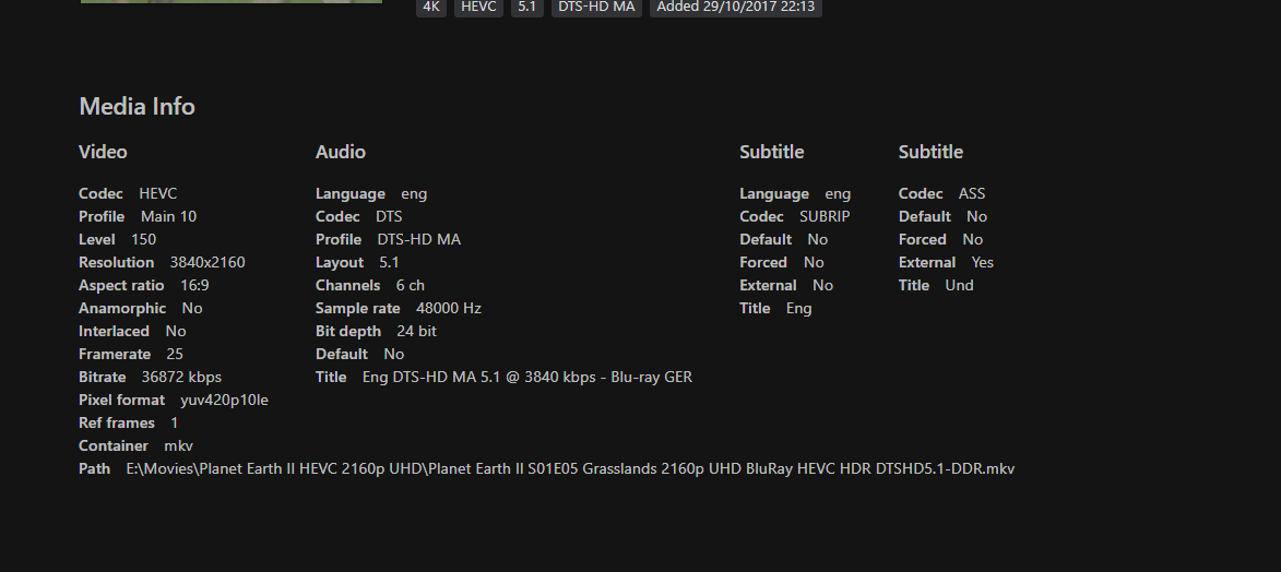

jinjin 0 Posted November 4, 2017 Posted November 4, 2017 Hey, I need some help to figure out the reason why my 2017 model Panasonic TV cannot play any 4K HEVC content. The Emby server installed on a PC with Windows Server 2016 standard, stream to my TV via DLNA. checked the transcode log, cannot find any issue. but I do find there are some HttpListenerResponseWrapper error in the server log. have tried to turn off my server firewall, which does not make any differences. really appreciated if anyone could point me to the right direction. ffmpeg-remux-6df72abf-5487-4396-a5f3-7ec1f43b5558.txt server-63645424096.txt

jinjin 0 Posted November 19, 2017 Author Posted November 19, 2017 (edited) now I found some interesting things between a transcoded movie and a direct played movie. For this transcoded movie: I got errors from the server log, saying the audiocodec does not supported. 2017-11-19 16:59:21.811 Info HttpServer: HTTP GET http://192.168.50.200:8096/videos/60c687be66c908fae5d6ea4c609f34c5/stream.mkv?Params=ba9ab94f705db3d86f649f19dc5c78a1;test;60c687be66c908fae5d6ea4c609f34c5;false;h264,hevc,mpeg2video;ac3,aac,mp3,flac;1;;99616000;384000;;;;;0;;;;;;;;;60c687be66c908fae5d6ea4c609f34c5;false;;;false;5ed352134e4b645fce2e3a41996c489a;false;;false;false;AudioCodecNotSupported. Accept=*/*, Connection=close, Host=192.168.50.200:80962017-11-19 16:59:21.816 Info App: C:\Users\Administrator\AppData\Roaming\Emby-Server\system\ffmpeg.exe -i file:"E:\Movies\Planet Earth II HEVC 2160p UHD\Planet Earth II S01E05 Grasslands 2160p UHD BluRay HEVC HDR DTSHD5.1-DDR.mkv" -map 0:0 -map 0:1 -map -0:s -codec:v:0 copy -vsync -1 -map_metadata -1 -map_chapters -1 -threads 0 -codec:a:0 ac3 -ac 6 -ab 384000 -y "D:\Emby-Server\TempTranscoding\transcoding-temp\cfc41b2cb6e7d6ec4ae8a10334fc21cb.mkv"2017-11-19 16:59:22.028 Info App: ffmpeg successfully started2017-11-19 16:59:22.028 Info App: ffmpeg successfully started2017-11-19 16:59:23.219 Error HttpServer: Error in HttpListenerResponseWrapper: An existing connection was forcibly closed by the remote host*** Error Report ***Version: 3.2.36.0Command line: C:\Users\Administrator\AppData\Roaming\Emby-Server\system\EmbyServer.dll C:\Users\Administrator\AppData\Roaming\Emby-Server\system\EmbyServer.dll C:\Users\Administrator\AppData\Roaming\Emby-Server\system\EmbyServer.dll C:\Users\Administrator\AppData\Roaming\Emby-Server\system\EmbyServer.dllOperating system: Microsoft Windows NT 6.2.9200.064-Bit OS: True64-Bit Process: TrueUser Interactive: TrueProcessor count: 4Program data path: C:\Users\Administrator\AppData\Roaming\Emby-Server\programdataApplication directory: C:\Users\Administrator\AppData\Roaming\Emby-Server\systemSystem.Net.Sockets.SocketException (0x80004005): An existing connection was forcibly closed by the remote hostat SocketHttpListener.SocketStream.Write(Byte[] buffer, Int32 offset, Int32 count)at SocketHttpListener.Net.HttpResponseStream.DisposeCore()at SocketHttpListener.Net.HttpResponseStream.Dispose(Boolean disposing)at System.IO.Stream.Close()at Emby.Server.Implementations.HttpServer.SocketSharp.WebSocketSharpResponse.CloseOutputStream(HttpListenerResponse response)System.Net.Sockets.SocketExceptionat SocketHttpListener.SocketStream.Write(Byte[] buffer, Int32 offset, Int32 count)at SocketHttpListener.Net.HttpResponseStream.DisposeCore()at SocketHttpListener.Net.HttpResponseStream.Dispose(Boolean disposing)at System.IO.Stream.Close()at Emby.Server.Implementations.HttpServer.SocketSharp.WebSocketSharpResponse.CloseOutputStream(HttpListenerResponse response)2017-11-19 16:59:23.220 Info HttpServer: HTTP Response 500 to 192.168.50.228. Time: 1408ms (slow). http://192.168.50.200:8096/videos/60c687be66c908fae5d6ea4c609f34c5/stream.mkv?Params=ba9ab94f705db3d86f649f19dc5c78a1;test;60c687be66c908fae5d6ea4c609f34c5;false;h264,hevc,mpeg2video;ac3,aac,mp3,flac;1;;99616000;384000;;;;;0;;;;;;;;;60c687be66c908fae5d6ea4c609f34c5;false;;;false;5ed352134e4b645fce2e3a41996c489a;false;;false;false;AudioCodecNotSupported2017-11-19 16:59:23.221 Info HttpServer: HTTP GET http://192.168.50.200:8096/videos/60c687be66c908fae5d6ea4c609f34c5/stream.mkv?Params=ba9ab94f705db3d86f649f19dc5c78a1;test;60c687be66c908fae5d6ea4c609f34c5;false;h264,hevc,mpeg2video;ac3,aac,mp3,flac;1;;99616000;384000;;;;;0;;;;;;;;;60c687be66c908fae5d6ea4c609f34c5;false;;;false;5ed352134e4b645fce2e3a41996c489a;false;;false;false;AudioCodecNotSupported. Accept=*/*, Connection=close, Host=192.168.50.200:80962017-11-19 16:59:23.231 Error HttpServer: Error in HttpListenerResponseWrapper: An established connection was aborted by the software in your host machine*** Error Report ***Version: 3.2.36.0Command line: C:\Users\Administrator\AppData\Roaming\Emby-Server\system\EmbyServer.dll C:\Users\Administrator\AppData\Roaming\Emby-Server\system\EmbyServer.dll C:\Users\Administrator\AppData\Roaming\Emby-Server\system\EmbyServer.dll C:\Users\Administrator\AppData\Roaming\Emby-Server\system\EmbyServer.dllOperating system: Microsoft Windows NT 6.2.9200.064-Bit OS: True64-Bit Process: TrueUser Interactive: TrueProcessor count: 4Program data path: C:\Users\Administrator\AppData\Roaming\Emby-Server\programdataApplication directory: C:\Users\Administrator\AppData\Roaming\Emby-Server\systemSystem.Net.Sockets.SocketException (0x80004005): An established connection was aborted by the software in your host machineat SocketHttpListener.SocketStream.Write(Byte[] buffer, Int32 offset, Int32 count)at SocketHttpListener.Net.HttpResponseStream.DisposeCore()at SocketHttpListener.Net.HttpResponseStream.Dispose(Boolean disposing)at System.IO.Stream.Close()at Emby.Server.Implementations.HttpServer.SocketSharp.WebSocketSharpResponse.CloseOutputStream(HttpListenerResponse response)System.Net.Sockets.SocketExceptionat SocketHttpListener.SocketStream.Write(Byte[] buffer, Int32 offset, Int32 count)at SocketHttpListener.Net.HttpResponseStream.DisposeCore()at SocketHttpListener.Net.HttpResponseStream.Dispose(Boolean disposing)at System.IO.Stream.Close()at Emby.Server.Implementations.HttpServer.SocketSharp.WebSocketSharpResponse.CloseOutputStream(HttpListenerResponse response)2017-11-19 16:59:23.232 Info HttpServer: HTTP Response 500 to 192.168.50.228. Time: 1779ms (slow). http://192.168.50.200:8096/videos/aa3b5b8918a6f2c1eb4e497241613dfd/stream.mkv?Params=ba9ab94f705db3d86f649f19dc5c78a1;test;aa3b5b8918a6f2c1eb4e497241613dfd;false;h264,hevc,mpeg2video;ac3,aac,mp3,flac;1;;99616000;384000;;;;;0;;;;;;;;;aa3b5b8918a6f2c1eb4e497241613dfd;false;;;false;9ace61ea15f0519848cd9aef74907594;false;;false;false;AudioCodecNotSupported2017-11-19 16:59:23.734 Info HttpServer: HTTP GET http://123.255.23.193:8096/emby/ScheduledTasks?IsEnabled=true. UserAgent: Mozilla/5.0 (Windows NT 10.0; Win64; x64) AppleWebKit/537.36 (KHTML, like Gecko) Chrome/62.0.3202.89 Safari/537.362017-11-19 16:59:23.742 Info HttpServer: HTTP Response 200 to 192.168.50.1. Time: 8ms. http://123.255.23.193:8096/emby/ScheduledTasks?IsEnabled=true2017-11-19 16:59:27.179 Error HttpServer: Error in HttpListenerResponseWrapper: An existing connection was forcibly closed by the remote host*** Error Report ***Version: 3.2.36.0Command line: C:\Users\Administrator\AppData\Roaming\Emby-Server\system\EmbyServer.dll C:\Users\Administrator\AppData\Roaming\Emby-Server\system\EmbyServer.dll C:\Users\Administrator\AppData\Roaming\Emby-Server\system\EmbyServer.dll C:\Users\Administrator\AppData\Roaming\Emby-Server\system\EmbyServer.dllOperating system: Microsoft Windows NT 6.2.9200.064-Bit OS: True64-Bit Process: TrueUser Interactive: TrueProcessor count: 4Program data path: C:\Users\Administrator\AppData\Roaming\Emby-Server\programdataApplication directory: C:\Users\Administrator\AppData\Roaming\Emby-Server\systemSystem.Net.Sockets.SocketException (0x80004005): An existing connection was forcibly closed by the remote hostat SocketHttpListener.SocketStream.Write(Byte[] buffer, Int32 offset, Int32 count)at SocketHttpListener.Net.HttpResponseStream.DisposeCore()at SocketHttpListener.Net.HttpResponseStream.Dispose(Boolean disposing)at System.IO.Stream.Close()at Emby.Server.Implementations.HttpServer.SocketSharp.WebSocketSharpResponse.CloseOutputStream(HttpListenerResponse response)System.Net.Sockets.SocketExceptionat SocketHttpListener.SocketStream.Write(Byte[] buffer, Int32 offset, Int32 count)at SocketHttpListener.Net.HttpResponseStream.DisposeCore()at SocketHttpListener.Net.HttpResponseStream.Dispose(Boolean disposing)at System.IO.Stream.Close()at Emby.Server.Implementations.HttpServer.SocketSharp.WebSocketSharpResponse.CloseOutputStream(HttpListenerResponse response)2017-11-19 16:59:27.179 Info HttpServer: HTTP Response 500 to 192.168.50.228. Time: 3958ms (slow). http://192.168.50.200:8096/videos/60c687be66c908fae5d6ea4c609f34c5/stream.mkv?Params=ba9ab94f705db3d86f649f19dc5c78a1;test;60c687be66c908fae5d6ea4c609f34c5;false;h264,hevc,mpeg2video;ac3,aac,mp3,flac;1;;99616000;384000;;;;;0;;;;;;;;;60c687be66c908fae5d6ea4c609f34c5;false;;;false;5ed352134e4b645fce2e3a41996c489a;false;;false;false;AudioCodecNotSupported then I checked the remux log: C:\Users\Administrator\AppData\Roaming\Emby-Server\system\ffmpeg.exe -i file:"E:\Movies\Planet Earth II HEVC 2160p UHD\Planet Earth II S01E05 Grasslands 2160p UHD BluRay HEVC HDR DTSHD5.1-DDR.mkv" -map 0:0 -map 0:1 -map -0:s -codec:v:0 copy -vsync -1 -map_metadata -1 -map_chapters -1 -threads 0 -codec:a:0 ac3 -ac 6 -ab 384000 -y "D:\Emby-Server\TempTranscoding\transcoding-temp\cfc41b2cb6e7d6ec4ae8a10334fc21cb.mkv"ffmpeg version 3.4 Copyright © 2000-2017 the FFmpeg developers built with gcc 7.2.0 (GCC) configuration: --enable-gpl --enable-version3 --enable-sdl2 --enable-bzlib --enable-fontconfig --enable-gnutls --enable-iconv --enable-libass --enable-libbluray --enable-libfreetype --enable-libmp3lame --enable-libopenjpeg --enable-libopus --enable-libshine --enable-libsnappy --enable-libsoxr --enable-libtheora --enable-libtwolame --enable-libvpx --enable-libwavpack --enable-libwebp --enable-libx264 --enable-libx265 --enable-libxml2 --enable-libzimg --enable-lzma --enable-zlib --enable-gmp --enable-libvidstab --enable-libvorbis --enable-cuda --enable-cuvid --enable-d3d11va --enable-nvenc --enable-dxva2 --enable-avisynth --enable-libmfx libavutil 55. 78.100 / 55. 78.100 libavcodec 57.107.100 / 57.107.100 libavformat 57. 83.100 / 57. 83.100 libavdevice 57. 10.100 / 57. 10.100 libavfilter 6.107.100 / 6.107.100 libswscale 4. 8.100 / 4. 8.100 libswresample 2. 9.100 / 2. 9.100 libpostproc 54. 7.100 / 54. 7.100Input #0, matroska,webm, from 'file:E:\Movies\Planet Earth II HEVC 2160p UHD\Planet Earth II S01E05 Grasslands 2160p UHD BluRay HEVC HDR DTSHD5.1-DDR.mkv': Metadata: encoder : libebml v1.3.4 + libmatroska v1.4.5 creation_time : 2017-04-25T20:55:16.000000Z Duration: 00:49:12.84, start: 0.000000, bitrate: 36872 kb/s Chapter #0:0: start 0.000000, end 488.960000 Metadata: title : 00:00:00.000 Chapter #0:1: start 488.960000, end 1010.920000 Metadata: title : 00:08:08.960 Chapter #0:2: start 1010.920000, end 1524.640000 Metadata: title : 00:16:50.920 Chapter #0:3: start 1524.640000, end 1999.800000 Metadata: title : 00:25:24.640 Chapter #0:4: start 1999.800000, end 2526.280000 Metadata: title : 00:33:19.800 Chapter #0:5: start 2526.280000, end 2952.843000 Metadata: title : 00:42:06.280 Stream #0:0(eng): Video: hevc (Main 10), yuv420p10le(tv, bt2020nc/bt2020/smpte2084), 3840x2160, SAR 1:1 DAR 16:9, 25 fps, 25 tbr, 1k tbn, 25 tbc (default) Metadata: BPS : 32845705 BPS-eng : 32845705 DURATION : 00:49:12.840000000 DURATION-eng : 00:49:12.840000000 NUMBER_OF_FRAMES: 73821 NUMBER_OF_FRAMES-eng: 73821 NUMBER_OF_BYTES : 12123514073 NUMBER_OF_BYTES-eng: 12123514073 _STATISTICS_WRITING_APP: mkvmerge v10.0.0 ('To Drown In You') 64bit _STATISTICS_WRITING_APP-eng: mkvmerge v10.0.0 ('To Drown In You') 64bit _STATISTICS_WRITING_DATE_UTC: 2017-04-25 20:55:16 _STATISTICS_WRITING_DATE_UTC-eng: 2017-04-25 20:55:16 _STATISTICS_TAGS: BPS DURATION NUMBER_OF_FRAMES NUMBER_OF_BYTES _STATISTICS_TAGS-eng: BPS DURATION NUMBER_OF_FRAMES NUMBER_OF_BYTES Stream #0:1(eng): Audio: dts (DTS-HD MA), 48000 Hz, 5.1(side), s32p (24 bit) Metadata: title : DTS-HD MA 5.1 @ 3840 kbps - Blu-ray GER BPS : 4022709 BPS-eng : 4022709 DURATION : 00:49:12.843000000 DURATION-eng : 00:49:12.843000000 NUMBER_OF_FRAMES: 276829 NUMBER_OF_FRAMES-eng: 276829 NUMBER_OF_BYTES : 1484803536 NUMBER_OF_BYTES-eng: 1484803536 _STATISTICS_WRITING_APP: mkvmerge v10.0.0 ('To Drown In You') 64bit _STATISTICS_WRITING_APP-eng: mkvmerge v10.0.0 ('To Drown In You') 64bit _STATISTICS_WRITING_DATE_UTC: 2017-04-25 20:55:16 _STATISTICS_WRITING_DATE_UTC-eng: 2017-04-25 20:55:16 _STATISTICS_TAGS: BPS DURATION NUMBER_OF_FRAMES NUMBER_OF_BYTES _STATISTICS_TAGS-eng: BPS DURATION NUMBER_OF_FRAMES NUMBER_OF_BYTES Stream #0:2(eng): Subtitle: subrip Metadata: BPS : 44 BPS-eng : 44 DURATION : 00:48:31.119000000 DURATION-eng : 00:48:31.119000000 NUMBER_OF_FRAMES: 359 NUMBER_OF_FRAMES-eng: 359 NUMBER_OF_BYTES : 16141 NUMBER_OF_BYTES-eng: 16141 _STATISTICS_WRITING_APP: mkvmerge v10.0.0 ('To Drown In You') 64bit _STATISTICS_WRITING_APP-eng: mkvmerge v10.0.0 ('To Drown In You') 64bit _STATISTICS_WRITING_DATE_UTC: 2017-04-25 20:55:16 _STATISTICS_WRITING_DATE_UTC-eng: 2017-04-25 20:55:16 _STATISTICS_TAGS: BPS DURATION NUMBER_OF_FRAMES NUMBER_OF_BYTES _STATISTICS_TAGS-eng: BPS DURATION NUMBER_OF_FRAMES NUMBER_OF_BYTESStream mapping: Stream #0:0 -> #0:0 (copy) Stream #0:1 -> #0:1 (dts (dca) -> ac3 (native))Press [q] to stop, [?] for helpOutput #0, matroska, to 'D:\Emby-Server\TempTranscoding\transcoding-temp\cfc41b2cb6e7d6ec4ae8a10334fc21cb.mkv': Metadata: encoder : Lavf57.83.100 Stream #0:0: Video: hevc (Main 10), yuv420p10le(tv, bt2020nc/bt2020/smpte2084), 3840x2160 [sAR 1:1 DAR 16:9], q=2-31, 25 fps, 25 tbr, 1k tbn, 1k tbc (default) Stream #0:1: Audio: ac3 ([0] [0][0] / 0x2000), 48000 Hz, 5.1, fltp (24 bit), 384 kb/s Metadata: encoder : Lavc57.107.100 ac3 looks like server copies the video, just transcodes dts to ac3, using the MKV container to stream. but the connection between the server and TV has been disconnected because of the server error. then I tried a direct played movie with this info: this movie can be played perfectly. and I can see the 3 audio tracks in the option menu the customized profile attached. might need someone to help me, many thanks Edited November 19, 2017 by jinjin
Luke 42239 Posted November 19, 2017 Posted November 19, 2017 FYI - there's no server error. The TV disconnects because it doesn't like the format of the video being sent back. Unfortunately without a Panasonic for testing I can't explain why right now. It's just something that requires trial and error to keep trying certain things until you settle on something that works.

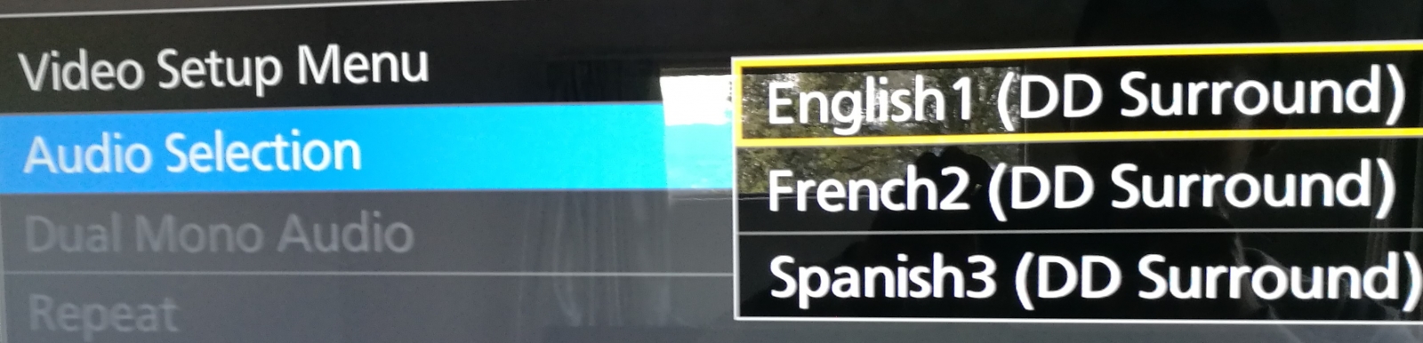

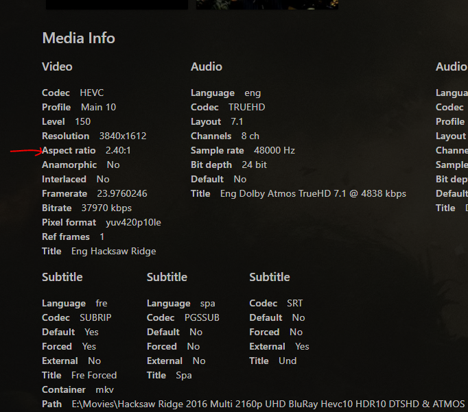

jinjin 0 Posted November 19, 2017 Author Posted November 19, 2017 (edited) finally!! I got it right. few more questions, Luke. the aspect ratio does not seems to be correct for some of the movies, TV stretched the picture to full screen which makes it look so wired, do you know if there is anything I can force it to always output the original ratio? the audio part, do you know if there is anyway in Emby I can setup the default audio track? and the subtitle does not seem to be working, I am not sure if there is anything I need to tweak in the profile, please advise Edited November 19, 2017 by jinjin
Luke 42239 Posted November 19, 2017 Posted November 19, 2017 Except that we're not doing anything with that aspect ratio value so I don't see how it could have any impact. As for the other questions, we should solve video first.
