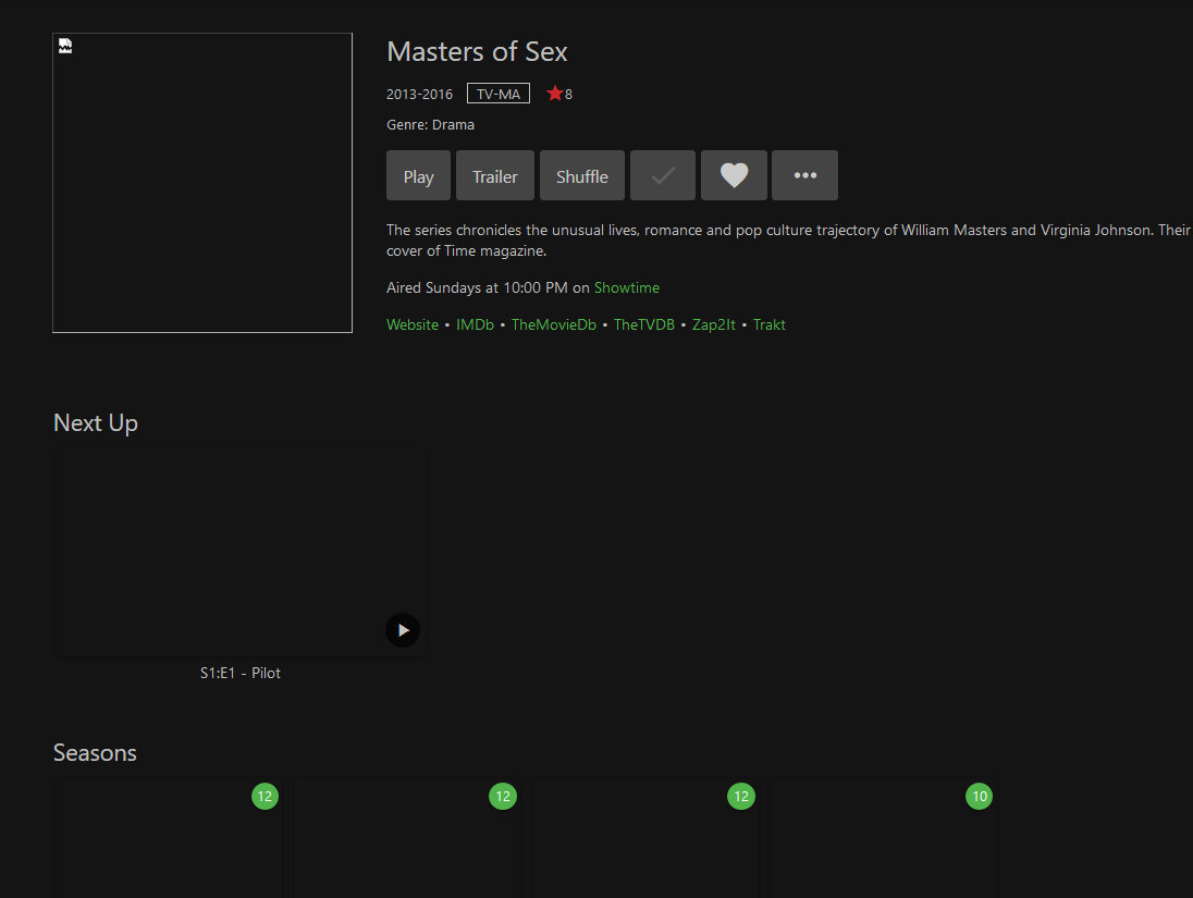

ShadowBlade72 22 Posted November 4, 2017 Posted November 4, 2017 (edited) Upgrading using the new packages went fine. The issues came after the update completed. I figured out one of the issues with HTTPS which I outlined here, so I won't rehash that: https://emby.media/community/index.php?/topic/50012-emby-server-for-net-core/&do=findComment&comment=507437 I found that my library was showing up with a bunch of pictures and media apparently missing. https://i.gyazo.com/62eede0e86475a9042e633aa62d27c48.png https://i.gyazo.com/2c54c149e338d5d4edf56163d47e4e65.png I decided to try and run a library scan to see if it could fix itself, but ended up worse off. Now nothing shows and the scan completed after 3 seconds. Subsequent scans also finish immediately with no files showing up. I tried uninstalling the "Auto Box Sets" plugin thinking maybe that was causing issues, but nothing changed. https://i.gyazo.com/1276708b9dbf6d334aaca036703780ca.png Attached are logs from the upgrade and various browsing of the dashboard to see if I could get it to throw errors to point me in the right direction. server-63645371062.txt server-63645371181.txt server-63645372162.txt Edited November 4, 2017 by ShadowBlade72
Luke 42245 Posted November 4, 2017 Posted November 4, 2017 I would try removing and readding the libraries that are doing that. thanks.
ShadowBlade72 22 Posted November 4, 2017 Author Posted November 4, 2017 I'm trying not to lose my libraries if at all possible. I had to manually identify several items in my library (uploading images, descriptions, etc). I'm hoping to find a way to get from Mono to Dotnet without losing everything, because re-inputting all that information is going to be a pain in the ass honestly. I'm assuming that deleting the libraries and re-adding them won't just seamlessly transfer everything over? It'll literally have to reidentify/recreate everything?
