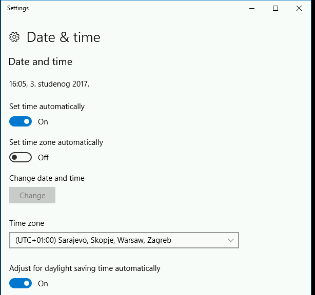

mmesnjak 1 Posted November 3, 2017 Posted November 3, 2017 Hi, First to give some context: - Machine I'm running Emby Server on is Windows 10 - on the same machine I'm running an Ubuntu virtual machine and there everything is set properly (according to what I can see): [0] misel@ubuntu-server[~]: [16:04:07] $ sudo timedatectl status [sudo] password for misel: Local time: Pet 2017-11-03 16:04:16 CET Universal time: Pet 2017-11-03 15:04:16 UTC RTC time: Pet 2017-11-03 15:04:17 Timezone: Europe/Zagreb (CET, +0100) NTP enabled: yes NTP synchronized: yes RTC in local TZ: no DST active: no Last DST change: DST ended at Ned 2017-10-29 02:59:59 CEST Ned 2017-10-29 02:00:00 CET Next DST change: DST begins (the clock jumps one hour forward) at Ned 2018-03-25 01:59:59 CET Ned 2018-03-25 03:00:00 CEST - The RTC on host machine is set to UTC - Timezone on Win10 is set to CET: - Times in the XMLTV file I receive are in local timezone: <tv source-data-url="http://tvprofil.net/xmltv/" source-info-name="Phazer XML servis 4.6" source-info-url="http://tvprofil.net"> <channel id="doma-tv.hr"> <display-name>Doma TV</display-name> <url/> <icon src="http://phazer.info/img/kanali/domatv.jpg"/> </channel> <programme channel="doma-tv.hr" start="20171103060000" stop="20171103063000"> <title lang="hr">Bez kočnica</title> <desc lang="hr"> Ovoga tjedna ekipa emisije 'Bez kočnica' gledatelje vodi u Meksiko, gdje su sudjelovali na svjetskoj prezentaciji novog Audijevog SUV modela. Gas do daske! Novinari emisije bili su i na najatraktivnijem hrvatskom reli događaju, kultnoj Santa Domenici koja je i ove godine privukla prave reli zvijeri. 'Bez kočnica' gledatelje vodi na automobilski izlet u okolicu Zadra gdje ekipa emisije otkriva prirodne, kulturne i enološke ljepote. Ekipa emisije 'Bez kočnica' predstavlja klasik među auto... (više na http://tvprofil.net) </desc> <episode-num>40</episode-num> </programme> The problem is when I look at the Guide I get all programmes moved by +1 hour. So, instead of showing that some programme is starting at 19:00 I get 20:00.I can't influence xmltv guide data provider to send times in UTC. What can I do? And how can I set Emby to show times in 24 hours format?

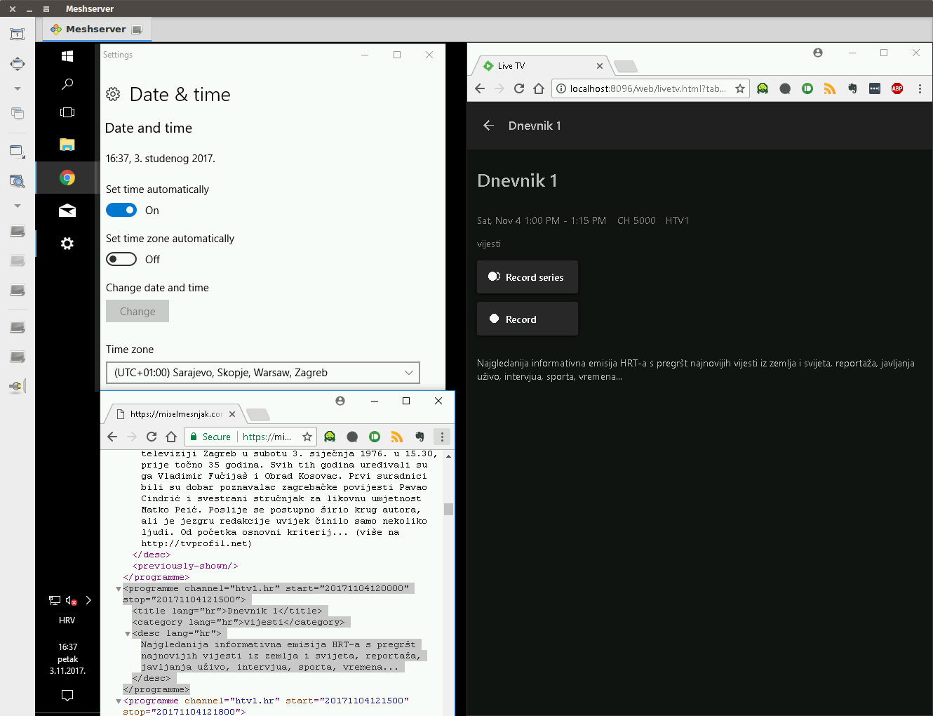

mmesnjak 1 Posted November 3, 2017 Author Posted November 3, 2017 Hi Luke,Even if I look the guide on the server (remote desktop connection, Google Chrome or MS Edge) I get all times offset by +1 hour. If you observe on this screenshot "Dnevnik 1" programme is shown to start at 1pm tomorrow while xmltv data says it will start on 20171104120000 This is taken on the host machine, the same on which the emby server is running.
Solution Luke 42243 Posted November 3, 2017 Solution Posted November 3, 2017 Currently if no timezone is given in the xml data, then we assume utc. so i guess that is your issue. 1
