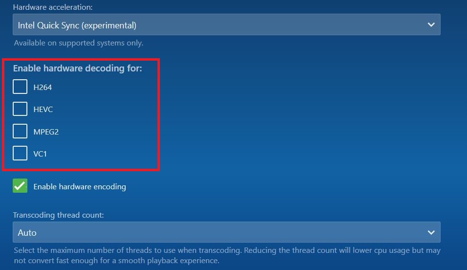

Guest asrequested Posted November 4, 2017 Posted November 4, 2017 Ok, so now we see QuickSync being used. You have decoding also enabled. Try turning that off, and only use encoding. Stream #0:0: Video: mpeg2video (Main), yuv420p(tv, top first), 720x576 [SAR 16:15 DAR 4:3], 25 fps, 25 tbr, 48003.07 tbn, 50 tbc (default) Stream #0:1(en): Audio: ac3, 48000 Hz, stereo, fltp, 256 kb/s (default) Stream #0:2(en): Subtitle: dvd_subtitle, 720x576 Stream mapping: Stream #0:0 -> #0:0 (mpeg2video (mpeg2_qsv) -> h264 (h264_qsv)) Stream #0:1 -> #0:1 (ac3 (native) -> mp3 (libmp3lame))

Guest asrequested Posted November 4, 2017 Posted November 4, 2017 Just to be clear, disable the options in the red box
