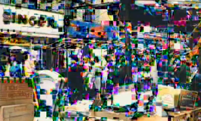

jangle 1 Posted October 31, 2017 Author Posted October 31, 2017 Windows 10 Ent Intel i7 4770R 3.2 8Gb 1Tb SSD Intel Iris Pro 5200 Installed - Version 3.2.35.1 Beta FFMPEG 3.4 When I turn on Transcoding Hardware Acceleration and set it to Intel when a web browser plays a tv series from H264 format the picture being played is all grainy with boxes of pixels and nothing clear. As soon as I turn of Hardware Acceleration it is working and the console confirms item is transcoding and all browsers play the episode with no issues. I have used the same machine to convert files to H264 using the hardware encoding and it works with no issue. I have upgraded the video drivers just in case. I am not sure what I can do to drill down on this failure.
jangle 1 Posted October 31, 2017 Author Posted October 31, 2017 (edited) This is the image when Hardware Transcoding is on Edited October 31, 2017 by jangle

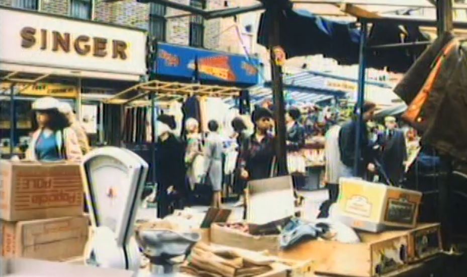

jangle 1 Posted October 31, 2017 Author Posted October 31, 2017 This is what it is without hardware transcoding.
jangle 1 Posted October 31, 2017 Author Posted October 31, 2017 Doofus I have uploaded a couple of pictures from Chrome when playing a OFAH episode one with hardware acceleration the other with it turned off.
