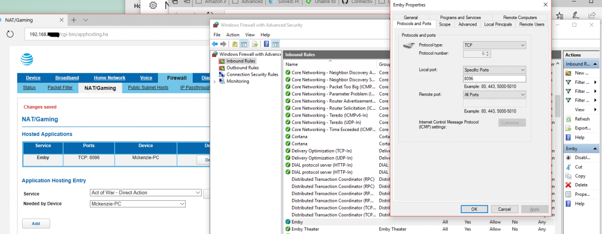

mckenzie78 1 Posted October 31, 2017 Author Posted October 31, 2017 Thank you for responding! I was actually about to post a screenshot of my Windows firewall and router firewall. I am still having the same issues. Mckenzie p.s. I thought I had attached the log files to the the original post. I believe I may have forgotten to click "Attach This File" I have attached the most recent log with this message. Most recent Log.txt

mckenzie78 1 Posted October 31, 2017 Author Posted October 31, 2017 Should be the same thing, do you have port forwarding setup on the router? Yes, I believe that is what I did. If you look at the screenshot I put in a previous post. Unless I'm supposed to put a check in a box somewhere?
Nisten 15 Posted November 1, 2017 Posted November 1, 2017 In the background of the screenshot, That is the web interface for the At&t modem/gateway. Are you using its on-board router/wi-fi capability? If you're using it as a modem only then you would be using a 3rd party router (in this case, the 3rd party router would have its own independent port forwarding settings)
