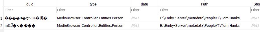

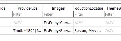

PeteMB 13 Posted October 31, 2017 Posted October 31, 2017 I have the same problem, and I am not really happy with it. I restored my backup from v3.2.34 and everything is back. So i cannot update to this latest version before this problem is fixed. When i look in the database with DB Browser I see that for every person i have 2 entrys, one whitch has all the information and a second without any information. Only the guid differs. Is there a way to combine these 2?
